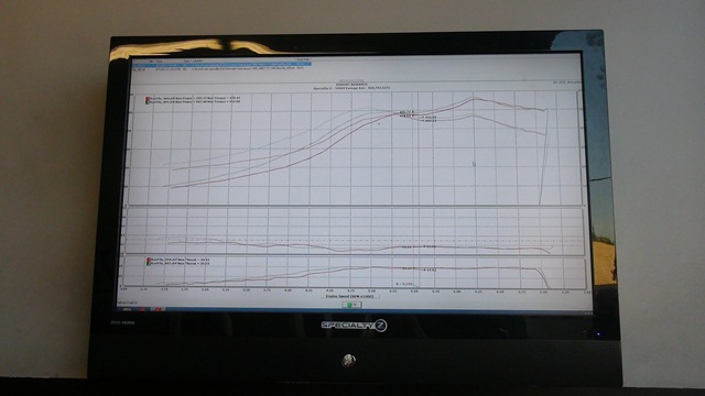

After replacing, we got the car back on the dyno and pulled 5 runs on 91 octane CA piss gas and 4 runs on 100 octane. Needless to say, I was one happy Z owner.

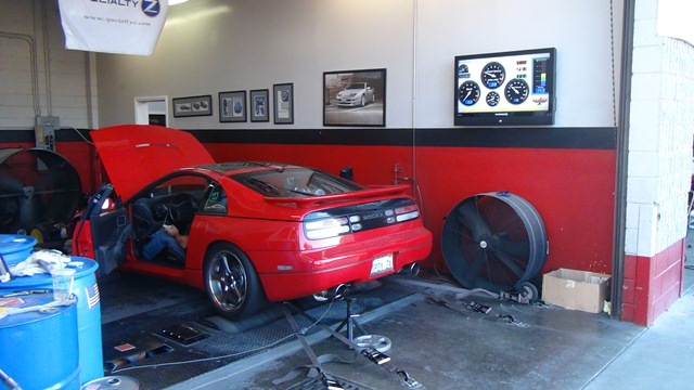

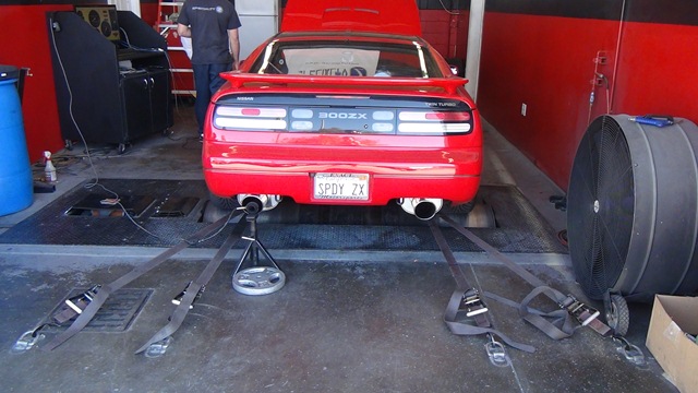

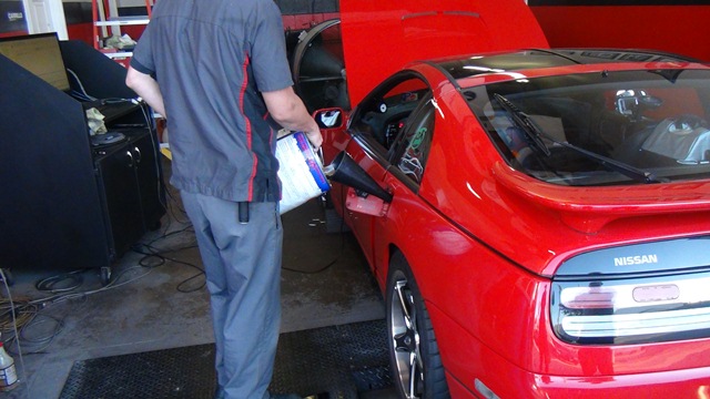

My TT getting strapped to the dyno...
468.13 HP and 426.32 pound of torque @ 16.24 PSI.

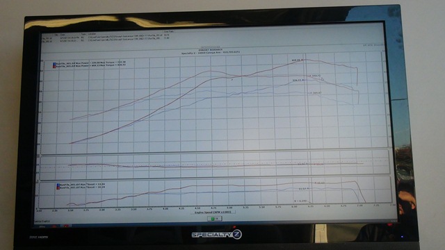

Adding the go-fast juice, 100 octane awesomeness
567.49 HP and 513.60 pounds of torque @ 20.53 PSI
