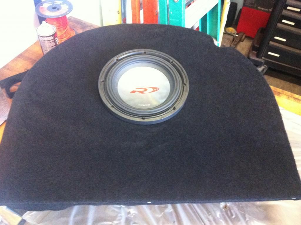

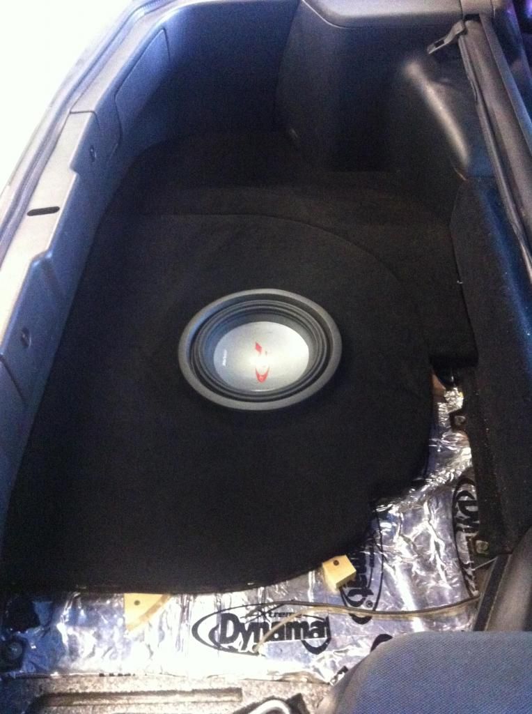

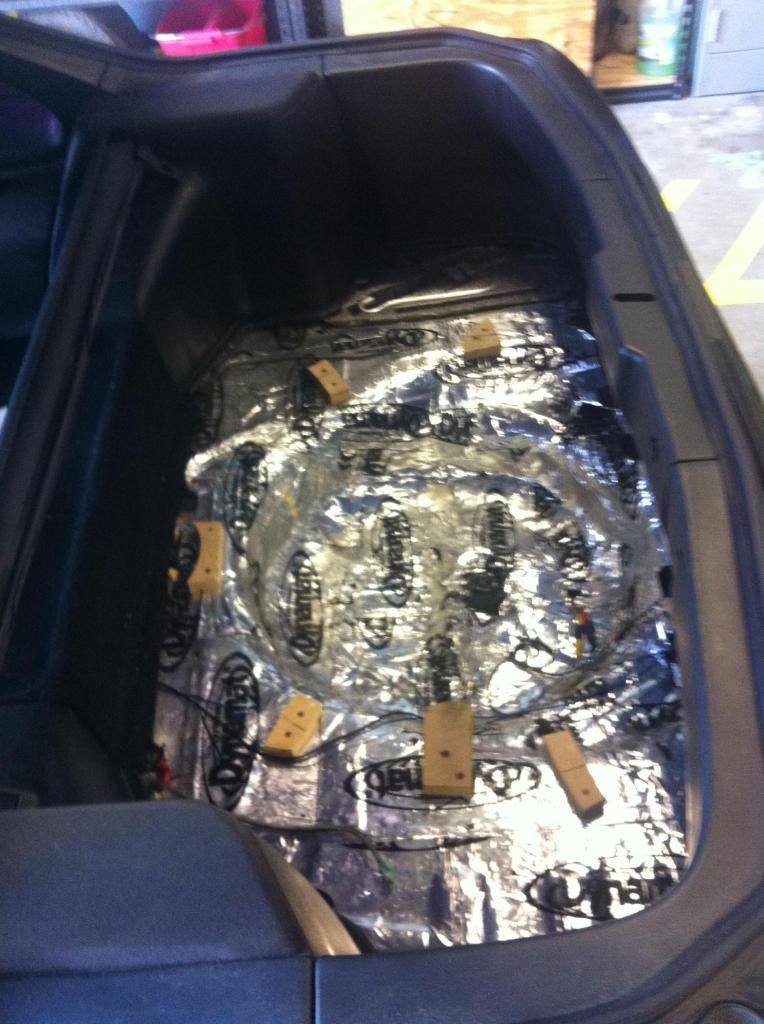

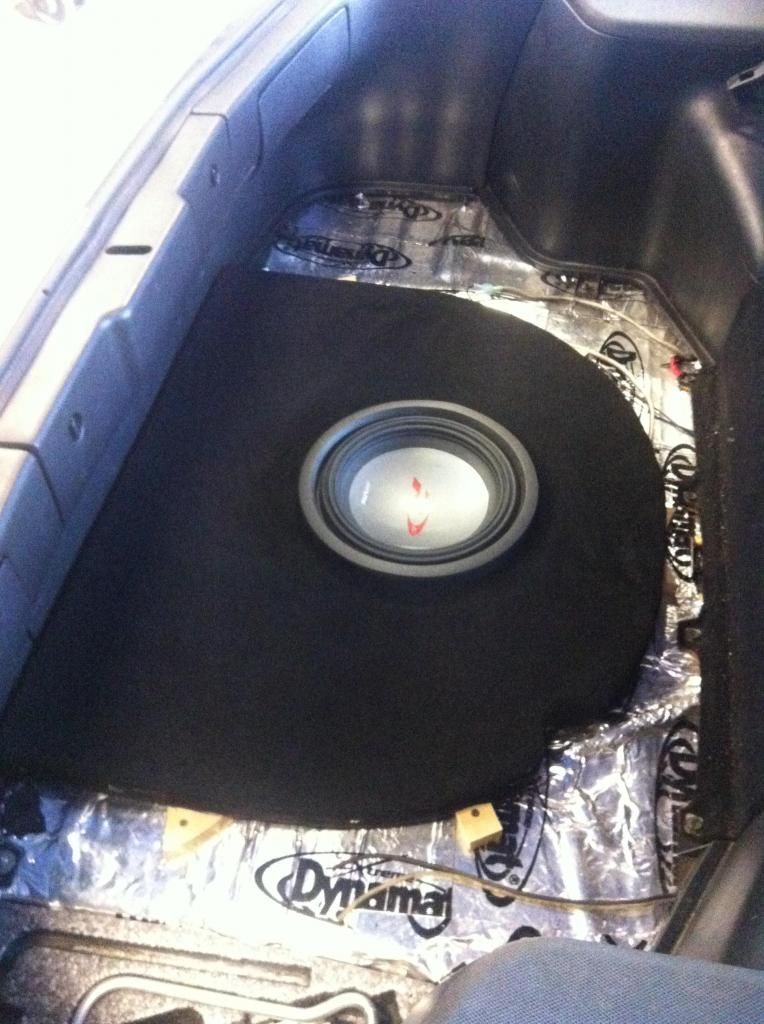

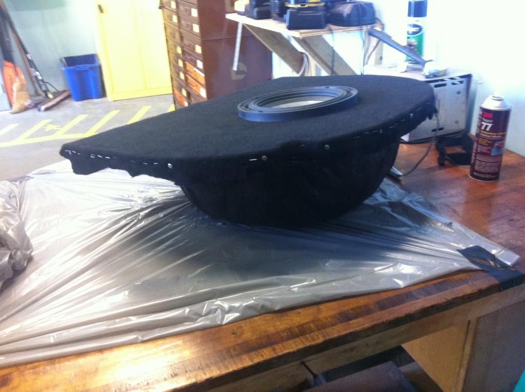

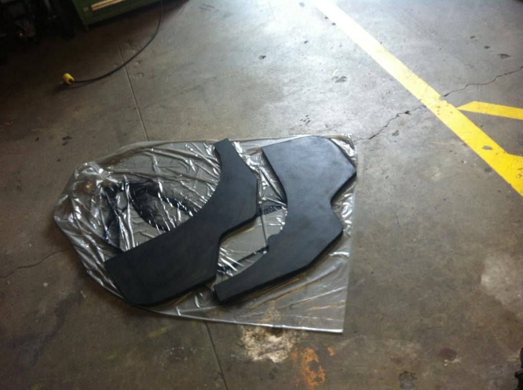

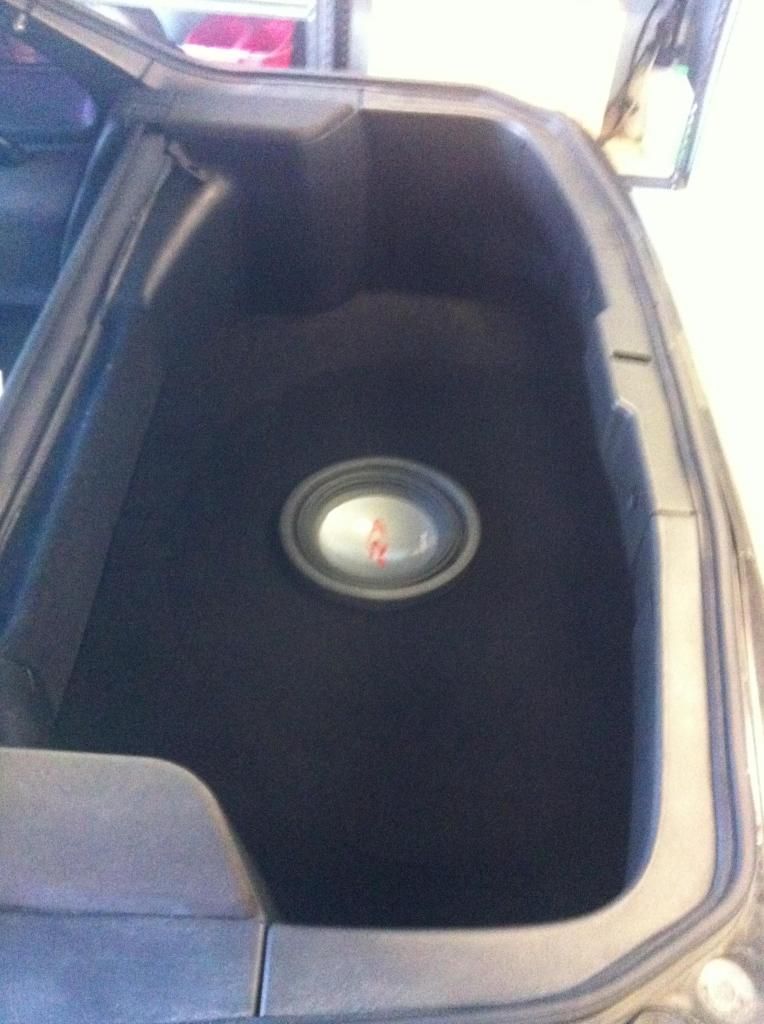

Message So I wanted a sub box for my 10" Alpine dual voice coil sub (very deep) but all prefab boxes were bulky and didn't look as factory as I wanted, so these pics are what I came up with. The bottom of the box is fiberglass and the top is MDF carpeted with metra OEM black carpet. There is quick disconnects to the speaker wire so it is easily removed in three pieces. I am currently making these for some locals in other cars. What do y'all think of it?
