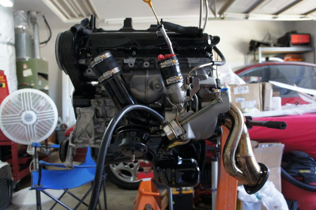

What to coat turbo mani heat shields with?
posted by Jkova300z
on June 03, 2013 at 11:10 AM
Sorry I don't have better pics.

Had mine coated with Thermal Dispersant coating
vorpalZ
11:23:57 06/03/13
Incorrect. You had it coated with a thermal barrier. (n/m)

Only the shields or manis themselves as well?? (n/m)
ZXoltan
13:52:48 06/03/13
shields & manis... Mixmn also had the turbo hot side

Any idea if the additional coating on the shields helps with

I used the VHT stuff like you mentioned without issue. -

Just on the heat shields or on the manis themselves?
ZXoltan
18:56:00 06/03/13
Just the heat shields. My manifolds are swain coated. (n/m)

I used the exact same stuff on my heat shields and cured

I have maybe 1000 miles on them. I didn't do any special
