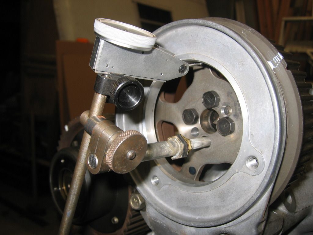

Message Here is a shot of the set up I did to check/Move mine..
I was 0.0025 on the org 95Na rebuild with Unknown early Heads on the 95 CAS bracket.. I moved it to 0.0015 Yes it's a real PITA.. I used the JWT PDF to fix mine.. the only major difference I did was to drill a Vent Hole behind the Pin pocket in the CAS Bracket, to get the JB Weld to push the Air out of the pocket.. this way I made sure it was full
