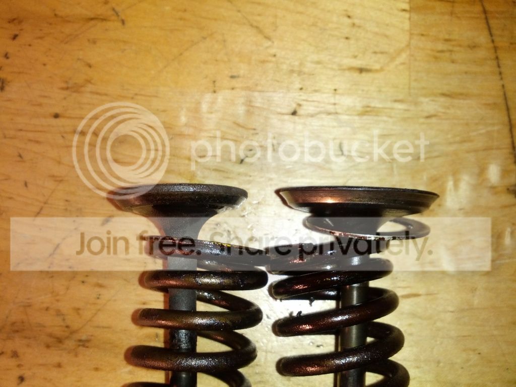

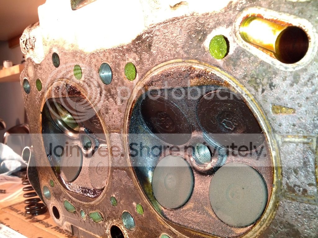

155k mile "30" intake valves on the right. They are all being replaced with the EG valves.
Sunk into seats
Intake valves on TT heads... "30 vs 30P"

Judging by how flush those intake valves are sitting
Ashman2k2
08:50:48 04/04/13
agreed (n/m)
aliaZ
09:38:21 04/04/13
Just trying to learn: how are they supposed to look? They
evan_aggie
09:51:59 04/04/13
here
aliaZ
10:21:13 04/04/13
Re: here -
wild_maxx
11:48:57 04/04/13
thanks to both of you for the pics and links. (n/m)

did you have to cut new valve seats?
KongZTT GT28RS MD
18:05:17 04/04/13
haha. Lucky me. of course I would get the "rare" soft valves
KongZTT GT28RS MD
18:06:14 04/04/13
you need a valve job
aliaZ
18:35:48 04/04/13
Re: you need a valve job
wild_maxx
19:39:28 04/04/13
yep.. going to go ahead and get the full job done..
