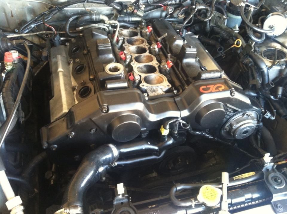

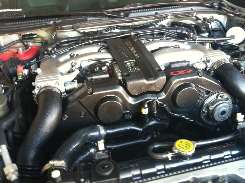

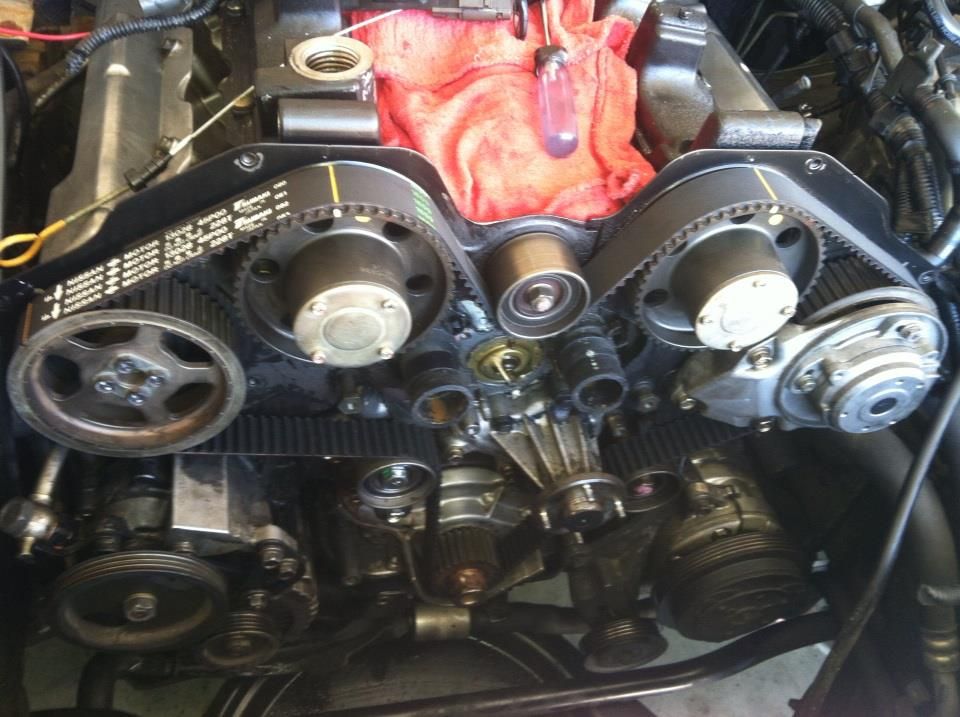

Message Did 60k maintenance on the z. Opened her up and found "quality" NAPA parts. smh. Everything went well and I finally tracked down my "come and go" cylinder misfire. The ptu had a faulty channel so I found a guy that had one used for $50. It fixed my misfire issue at idle but at 2k rpms my car was still stumbling. I hooked up my Blazt program and both 02 were faulty and when i checked the TPS it was nearly at its limits on adjustment. Now with new 02's,TPS,PTU and a fresh timing belt shes running better than ever before.
