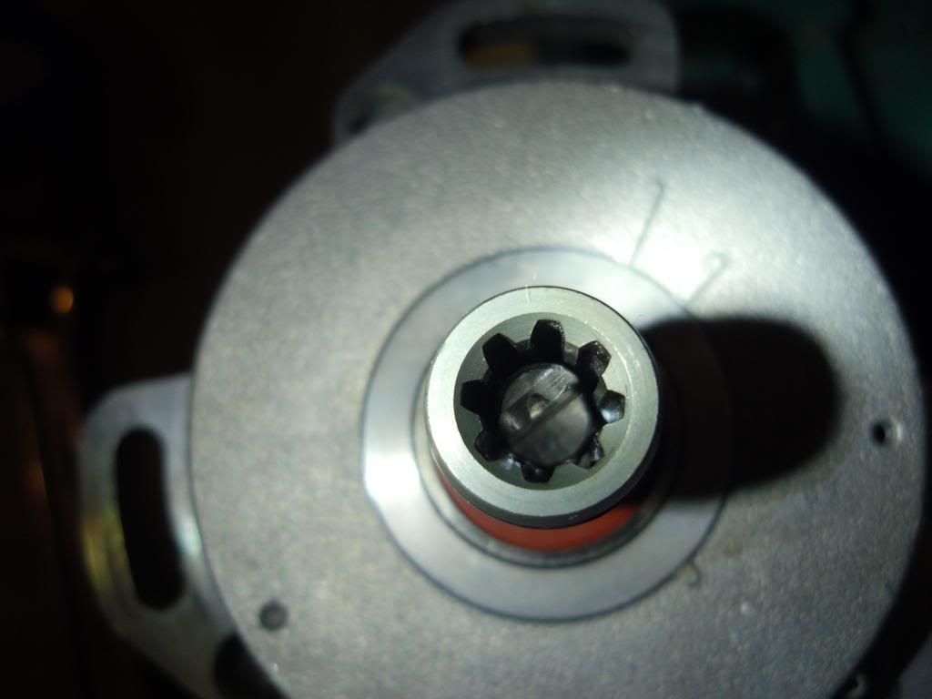

on the cam was worn out. CEM CAS has maybe 2k miles, I realize that may still be the culprit, just want to make sure.
JWT 500 cam CAS spline problem?

CAS is worn out - sometimes caused by cam alignment
14:02:22 03/01/13
I would have thought you would have told me the spline -
ae300z
14:28:39 03/01/13
CAS looks fine. (n/m)

I am just now reading JWT's spline replacement

Doesnt look that worn.
Woody75 (Denver)
15:06:02 03/01/13
ouch, that looks nasty. (n/m)
ae300z
15:18:36 03/01/13
Amateur.
Stadsport (Nick@CZP)
13:16:30 03/02/13
You sir.. have no teeth or nothing there.. (n/m)
My300zx
16:33:11 03/02/13

My issue is centered around the cam and CAS spline wear.
