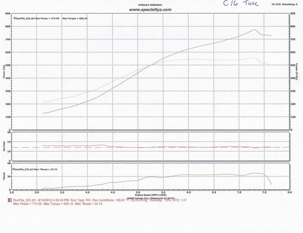

Current HP: 808rwhp @24psi amb temp 107deg E85
Current TQ: 583rwtq

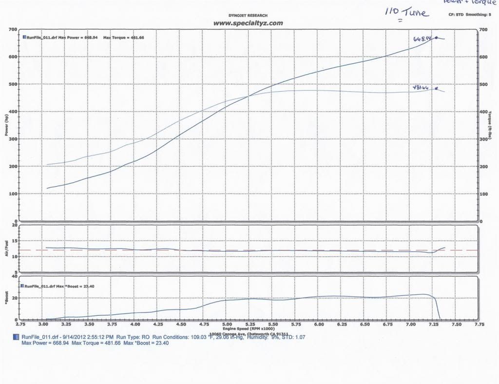

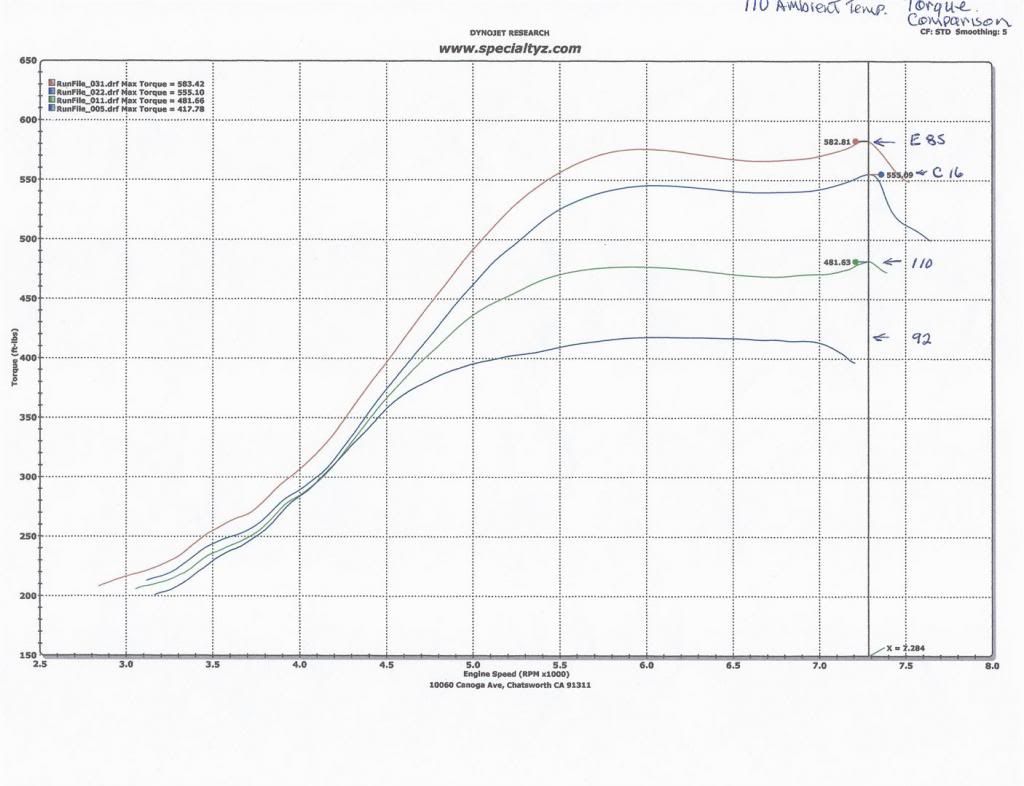

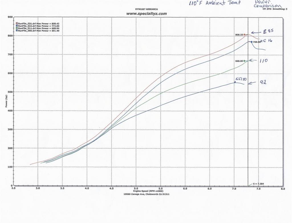

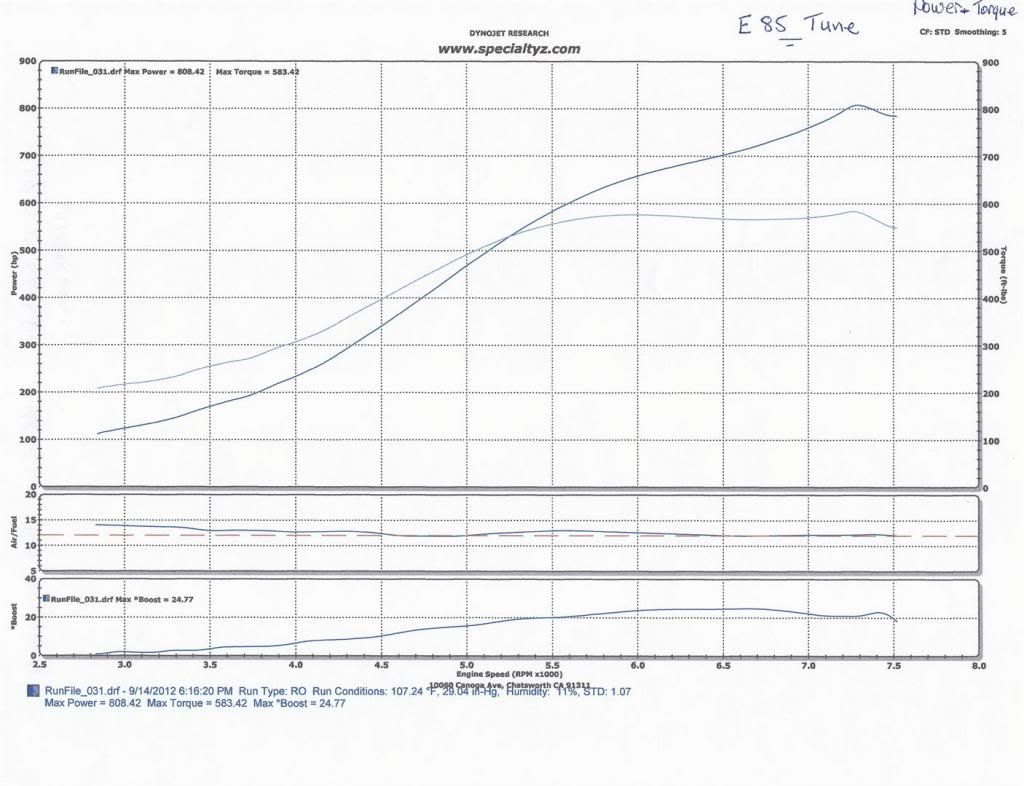

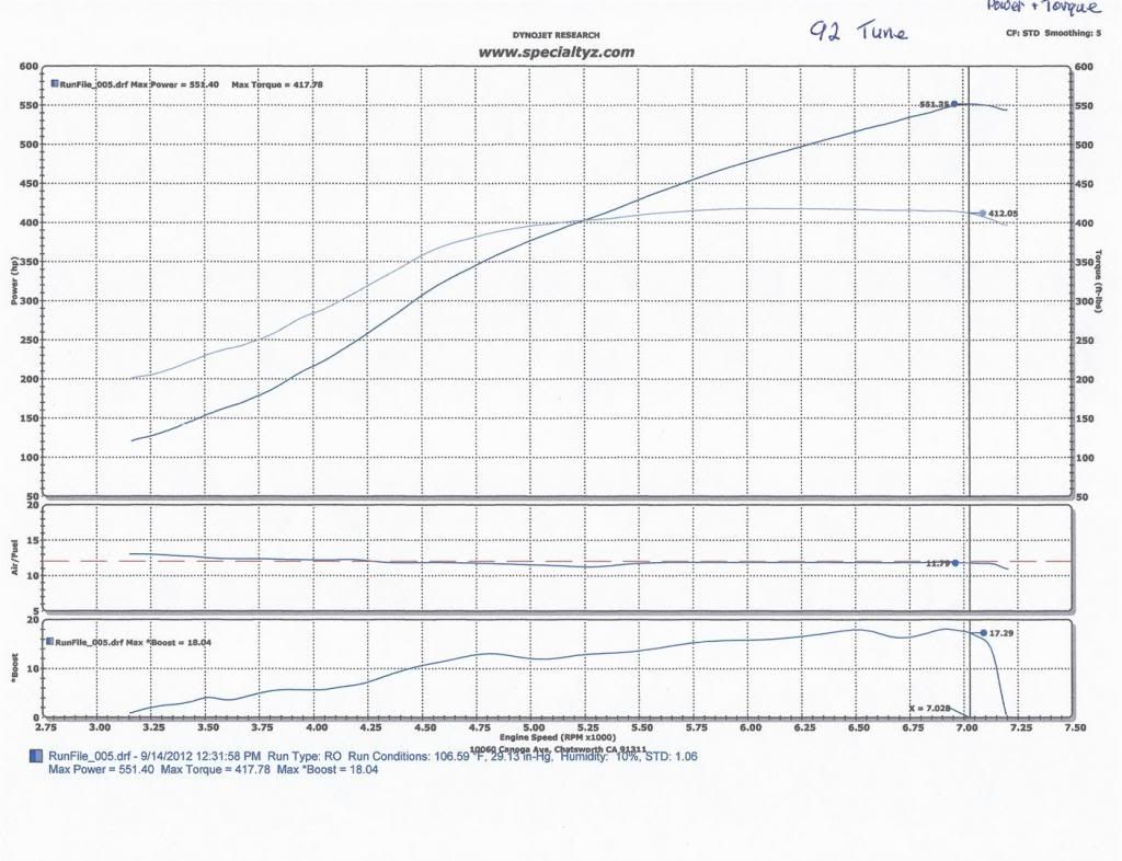

His Z was tuned on 92oct pump, 110 race, C16 race, and E85.
These graphs show a comparison of all the fuels and power levels.
This was the first Z Specialty has tuned on E85. We were all happy with the results.
Amb temp was 110 and the car would only hold 24psi of boost due to temp and humidity.
The turbos will put out over 30psi under better conditions.
