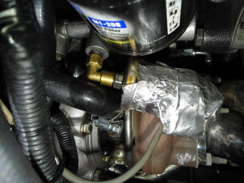

The sensor was wrapped to keep the heat from the exhaust side of the turbo from melting the sensor. You can see that when the fitting is completely screwed into the tree housing it places the sensor really close to the turbo. Any thoughts?

Fitting to relocate oil pressure sensor

Mine wasnt too close, have a pic? (n/m)

Its standard 1/8" BSPT size, look on mcmaster for fittings.

Here's a pic of the brass fitting -

plumbing section of lowes has the same brass fittings

Thanks. I was thinking of cutting the fitting threads

Do you have to bottom out the threads for it to seal

I tried sealant and not threading it all the way

i used pipe sealant tape and havent had any leaks. I also

RHD Z's have the sensor on the left side turbos oil feed.
