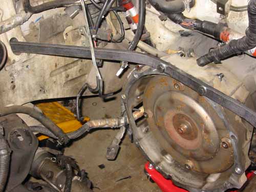

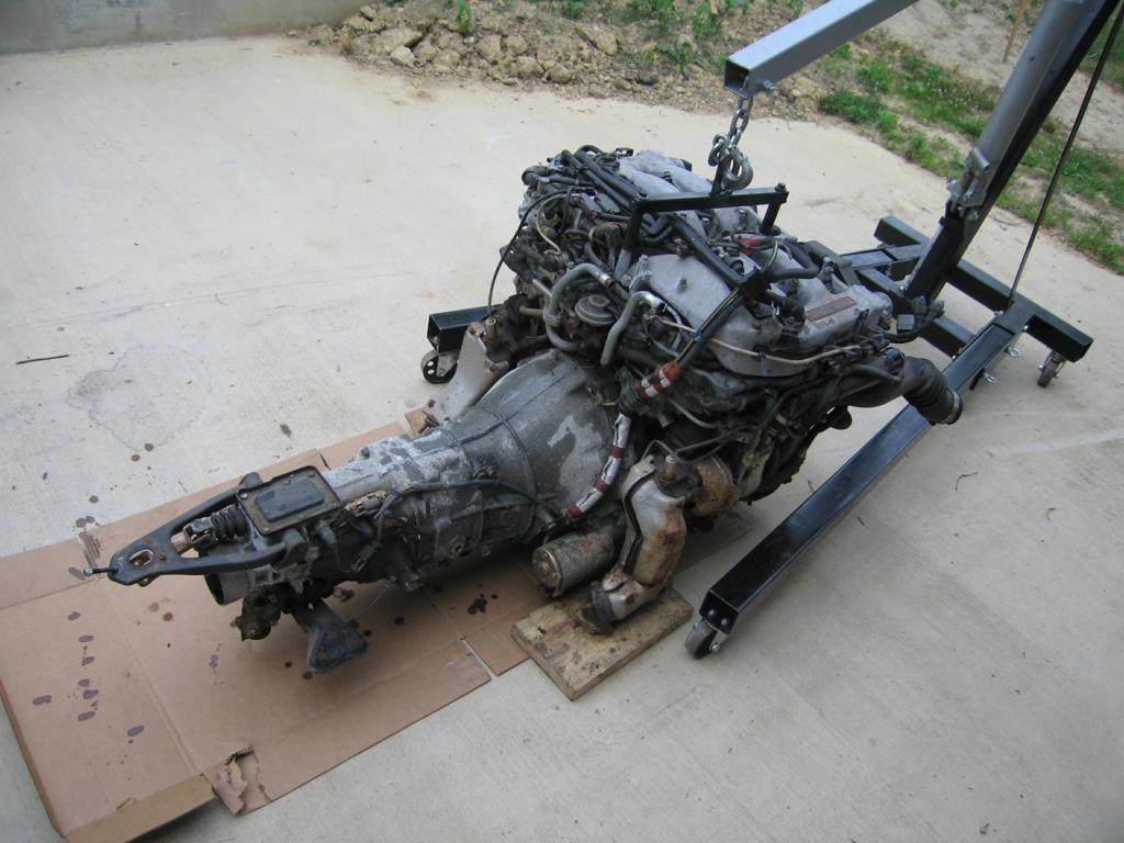

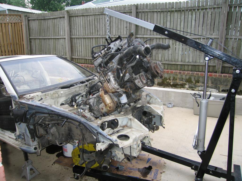

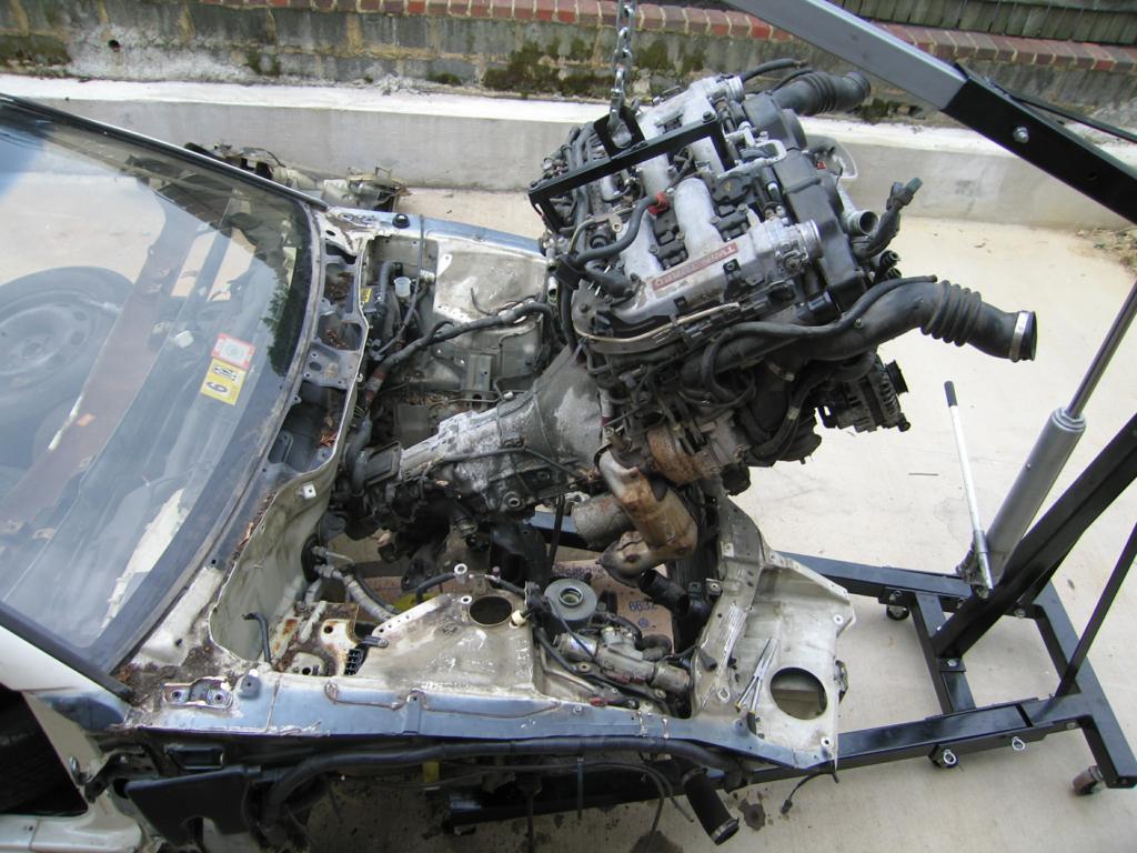

As for pulling the motor w. a 5 speed attached it can be done as well and you dont need to drop the crossmember but it's a fucking chore and messy since trans & coolant dumps all over the place.
