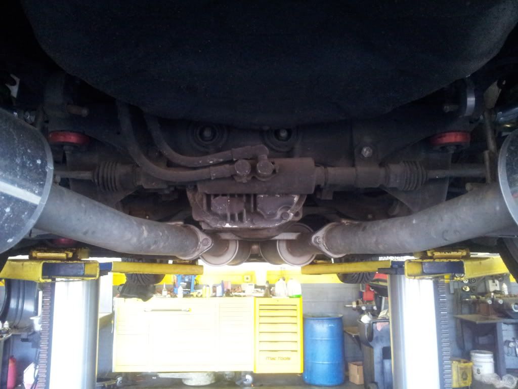

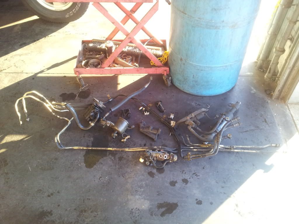

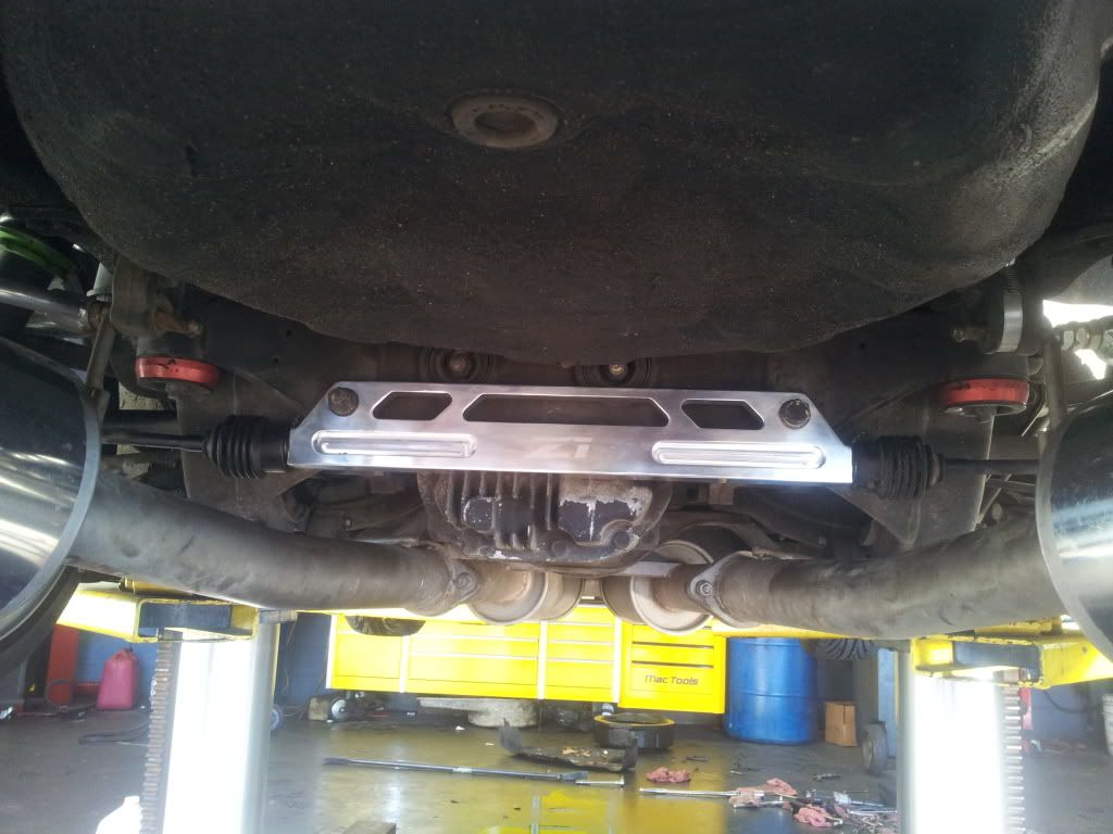

Message I finally got to doing my full Hicas delete today. My power steering was leaking right on top of my alternator. Its already killed one alternator and I wasn't gonna let it do it again & instead of just fixing the leak, I decided to do the full delete with the NA pump, reservior and brackets. It took me half the day to complete it, but I took out every bit of the hoses, hardline and brackets out from under the car and under the hood. Of course my Hicas light is on now, I knew it would be. I'm gonna just let it stay on until I find some original black gauge faces to replace the silver gauge faces that were in my car when I bought it and then I'll just pull the bulb. I only have about $225 in the whole delete. Of course I forgot to take pictures under the hood but on to the pictures anyways.
