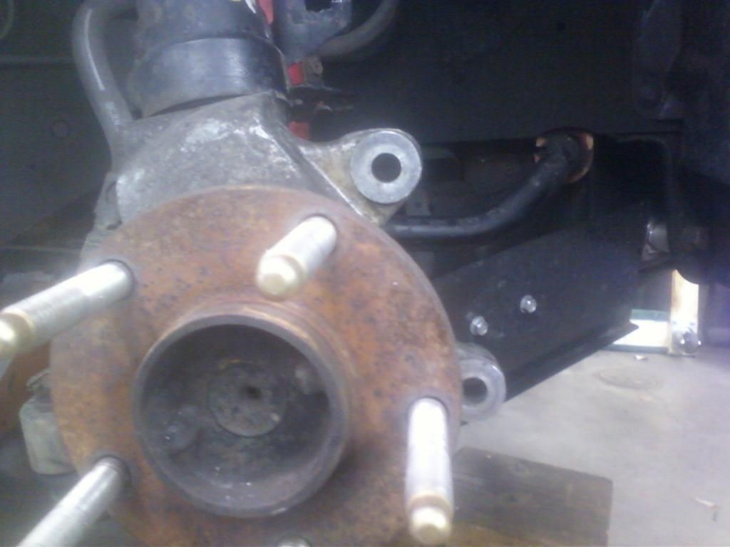

TwinTurbo.NET: Nissan 300ZX forum - False. The front spindle does require modification in order
Mike TDK (NoVA)
on December 26, 2012 at 8:32 AM
738
Agreed, that's the best value front caliper setup.
posted by TriniTT
on December 26, 2012 at 08:15 AM
for the relocation bracket to align with the stock caliper mounting points. You have to remove the mounting point for the stock hard line bracket. Other than this, everything bolts up without issue.

False. The front spindle does require modification in order -
Mike TDK (NoVA)
08:32:51 12/26/12
That's not what I was referring to.
TriniTT
09:12:55 12/26/12
Regardless of what you were referring to, your statement was
Mike TDK (NoVA)
10:21:09 12/26/12

You're right, so let's set the record straight.
TriniTT
10:36:33 12/26/12

I've had to "set the record straight" since you're initial
Mike TDK (NoVA)
11:37:24 12/26/12

What other brackets are there? (n/m)
BlackholeZ
01:21:55 12/27/12
The brackets he used are made by tougefactory,
TriniTT
11:28:09 12/28/12
You continue to allude to fictitious brackets and provide
Mike TDK (NoVA)
16:34:16 12/28/12
BTW, he asked what other brackets are there, not what I used
Mike TDK (NoVA)
16:50:44 12/28/12
Exactly, If I don't have to mod, I'd rather not
BlackholeZ
22:45:22 12/28/12
No, you will need to buy a set of brake lines to work with
Mike TDK (NoVA)
07:57:17 12/29/12

No, this is NOT the same bracket used with the stock caliper
Mike TDK (NoVA)
16:33:54 12/26/12
"If you wanted to return to stock you would be able to
TriniTT
11:39:16 12/28/12
Feel free to elaborate.
Mike TDK (NoVA)
16:44:27 12/28/12

Yes, I used the Touge Factory brackets, but you will
Mike TDK (NoVA)
17:50:43 12/26/12
