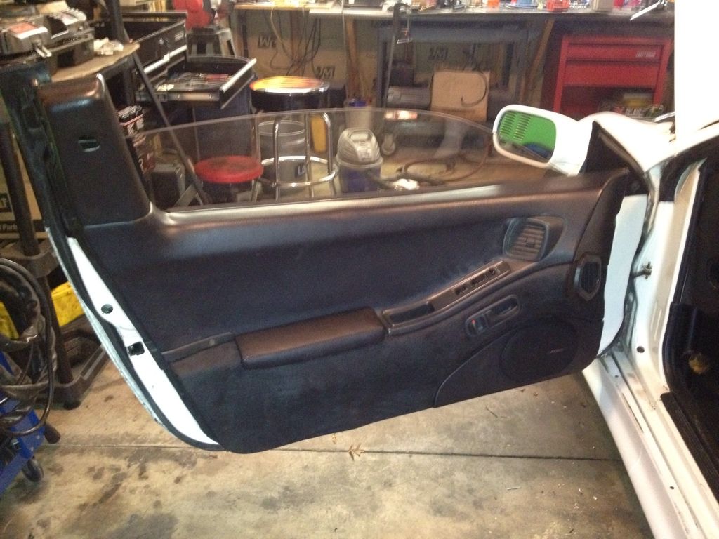

Since my Z has a full 8pt cage, I have 5pt harnesses as my restraints and grew tired of having the seat belts still clanking around. I had already planned on replacing my door panels and recovering them with suede so I used this opportunity to "shave" both provisions on the door panel for the seat belt.

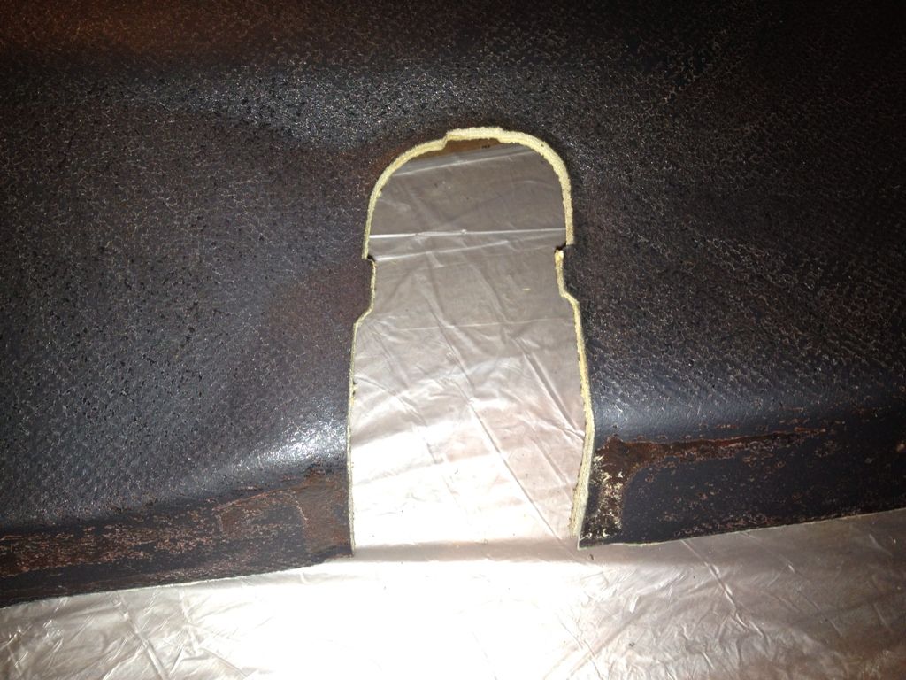

Started off by peeling all the tweed off. Here's the big piece
Uploaded from the Photobucket iPhone App

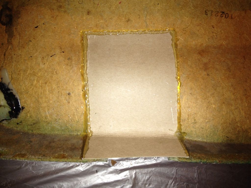

Took a piece of heavier cardboard for a backing and hot glued it in place

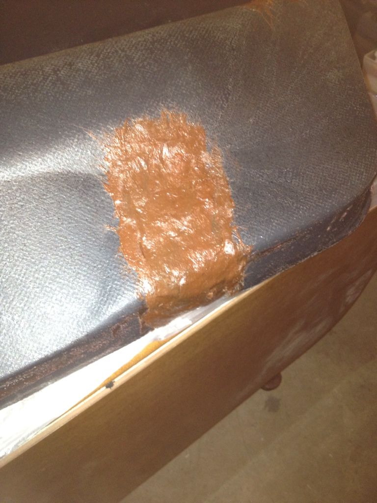

Next I applied a few layers of "kitty-hair." This stuff works pretty good, but be careful it can get kind of sharp if you don't use a rasp after it sets up to file it down.

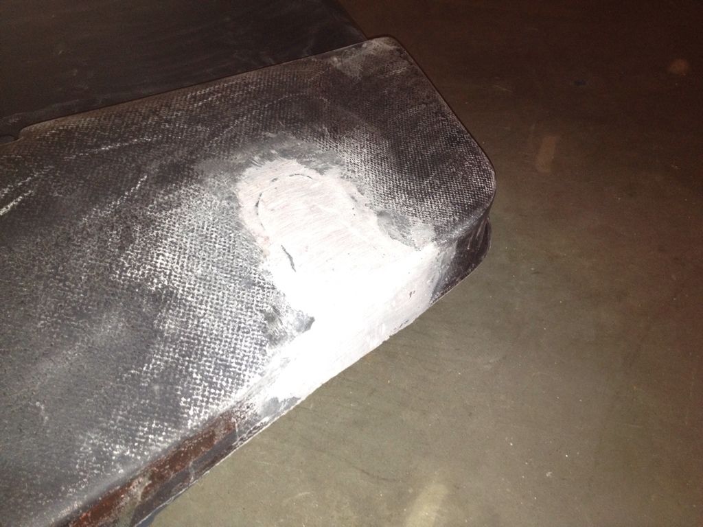

This picture didnt turn out well because of relfection, but I simply used a 3" sanding pad on a die grinder and got everything smooth
