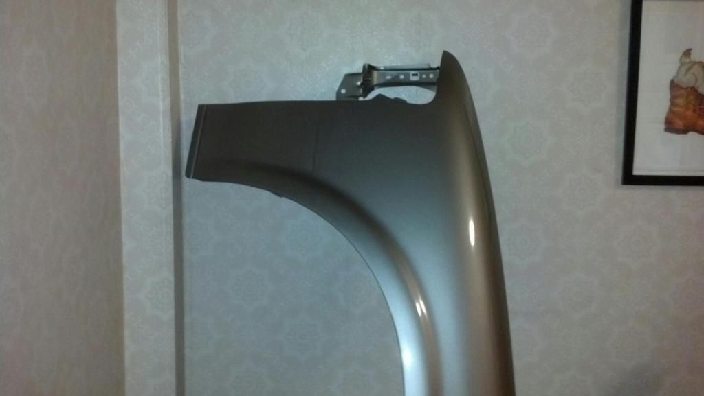

Message Here are a few tips for using their spray cans, I'm no expert by any means but I did get really good results with their spray cans.
1) But that $3 paint hand trigger adapter, it's easier to maintain flow then pressing the nozzle with your index finger.
2) Prep work is everything, if your trying to match a portion of the paint check out the videos they have on their site.
3) Finish work is just as important, wet sand, rubbing compound, wax and buffing/polishing.
Here's a fender I did with their base and lacquer clear spray cans. I did 3 coats of each with 15 mins in between coats. The fender came primered so I did a basic wipe down.
The final steps were 2k grit wet sand, ultra fine rubbing compound, buff and polish with a porter cable orbital. The finish is smooth like glass.
Not bad for $40
