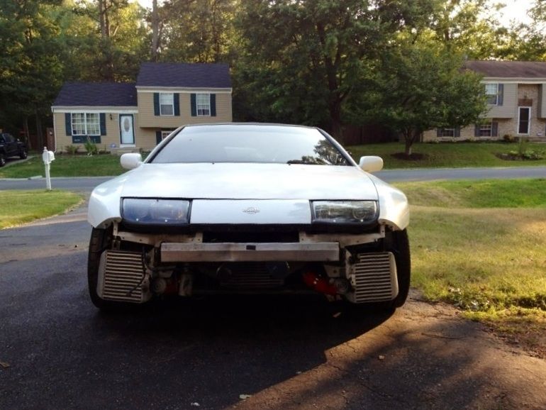

Can I see what you did with your fuse box? (n/m)
posted by TriniTT
on September 09, 2012 at 06:25 PM
Under the driver side head light, above the SMIC
Zip tied it
TriniTT
18:25:13 09/09/12
Can't really see it -
Alan(MD/NJ)
18:40:09 09/09/12

What kind of radiator is your Z. I am not use to seeing
z32z
15:27:39 09/09/12
AshSPEC v1 (n/m)
Alan(MD/NJ)
