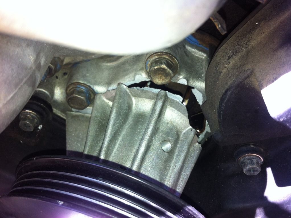

632
BUY OEM!
I bought this from someone local, knowing it wasn't OEM... But that was before I educated myself (and decided not to be cheap).
Just a reminder... -
AHos(Chicago)
20:15:24 08/05/12
Is that an AMS pulley?
90GoldZ
20:25:10 08/05/12
Nope it is a HI pulley from bernie.

TriniTT
18:38:08 08/06/12
Wow really? Bought it off of someone local

Ahmed (Chicago)
08:35:37 08/06/12
How was your belt tension? (n/m)
08:40:59 08/06/12
Possibly over tightened. It seemed pretty good to me
AHos(Chicago)
20:42:34 08/06/12
That's what I was thinking also. Tightening belt until it
