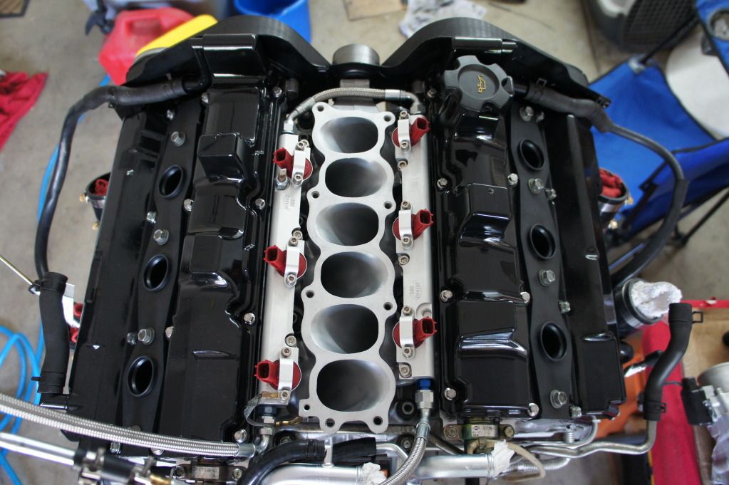

Stripped threads on coil pack mounts...
posted by Evan_Wright (Ca)
on May 11, 2012 at 02:31 AM
Just six more to go now.
And for fun:
Evan_Wright (Ca)
02:31:10 05/11/12
pft, zip tie it! get reel street cred (n/m)
05:03:51 05/11/12
Helicoil (n/m)
MixManMash
08:08:56 05/11/12
2nd (n/m)
08:34:46 05/11/12
3rd'dddd (n/m)
Crazy Greek
08:56:38 05/11/12
4th. once you do a couple of holes, it becomes easy.
Gordo 93TT Daytona
10:05:29 05/11/12
5th (n/m)
10:06:22 05/11/12
Re: Stripped threads on coil pack mounts...
Barry(TN)
08:16:12 05/11/12
This. (n/m)
zgene4
08:23:13 05/11/12

eh... helicoil isnt really a bandaid, its an upgrade. (n/m)

I'd check to see whether there are good threads
zellamay
08:53:35 05/11/12
P.S.: a search will yield various opinions on helicoil,
zellamay
08:56:20 05/11/12
A few of them have 1-2 threads at the bottom...nothing
Evan_Wright (Ca)
09:05:46 05/11/12
For the coil packs, helicoils will be quick, easy, and

The coil pack bosses are too small for Time/Keenserts >>>
LitlElvis
09:30:26 05/11/12
I bought it this way and I'd really like to salvage it if

Success!!! -
Evan_Wright (Ca)
10:51:12 05/11/12

All seven stripped bolt holes have been successfully
