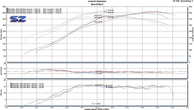

Pay attention to the blue run. The green run was with the vtc disabled for curiosity reasons. Keep in mind this is with no tuning at all. With tuning there would be more gains at wot and at partial throttle for city driving.
