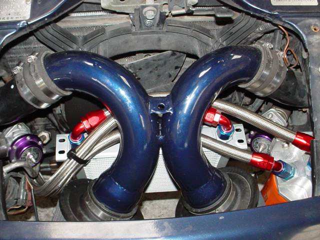

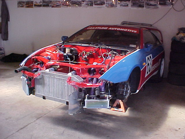

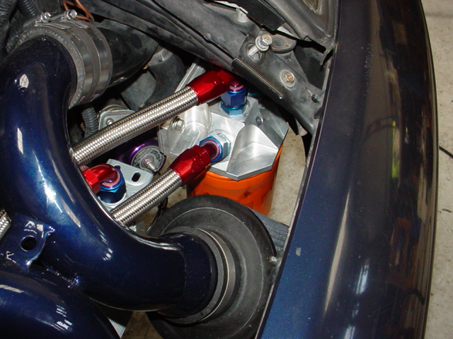

Below are some pics of the three different setups
Oil coolers - Most have 25 row oil coolers with dash 10 braided hoses
All oil filters except one are HP6 oil filters - the rest of the stuff I don't know the mechanics just did it using standard race car stuff. You might be able to tell from the pics.
Street Car - both oil cooler and oil filter in front underneath the intakes behind radiator
Classic Race car oil cooler front behind spoiler and oil filter on the chassis rail next to where the air con would be.
GT1 Race car - oil cooler front left behind spoiler and the remote oil filter top left of engine bay (why this is so high up and such a small filter, I don't know - was done before I bought the car. When the dry sump is fitted it will be mounted near the front of the car, like the classic race car.
