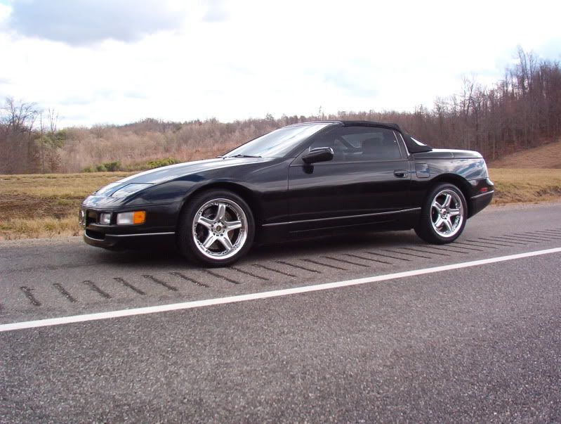

Here are a couple of my dynos and pics of my Z spread out over the years. I don't have any pics on my computer from when it had stock wheels because I didn't have a digital camera back then.
