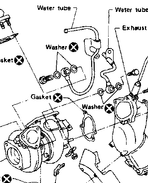

Message You need to connect a rubber hose to that end that youve shown (red arrow) and then follow it through into the Turbo water lines thats closer to the block.
In the image shown is labeled "water tube" at the top
Again connect them with a good water hose.
