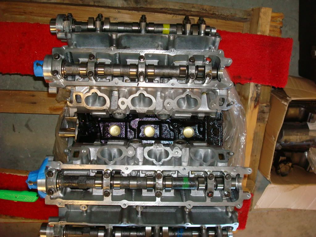

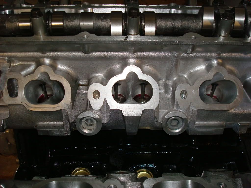

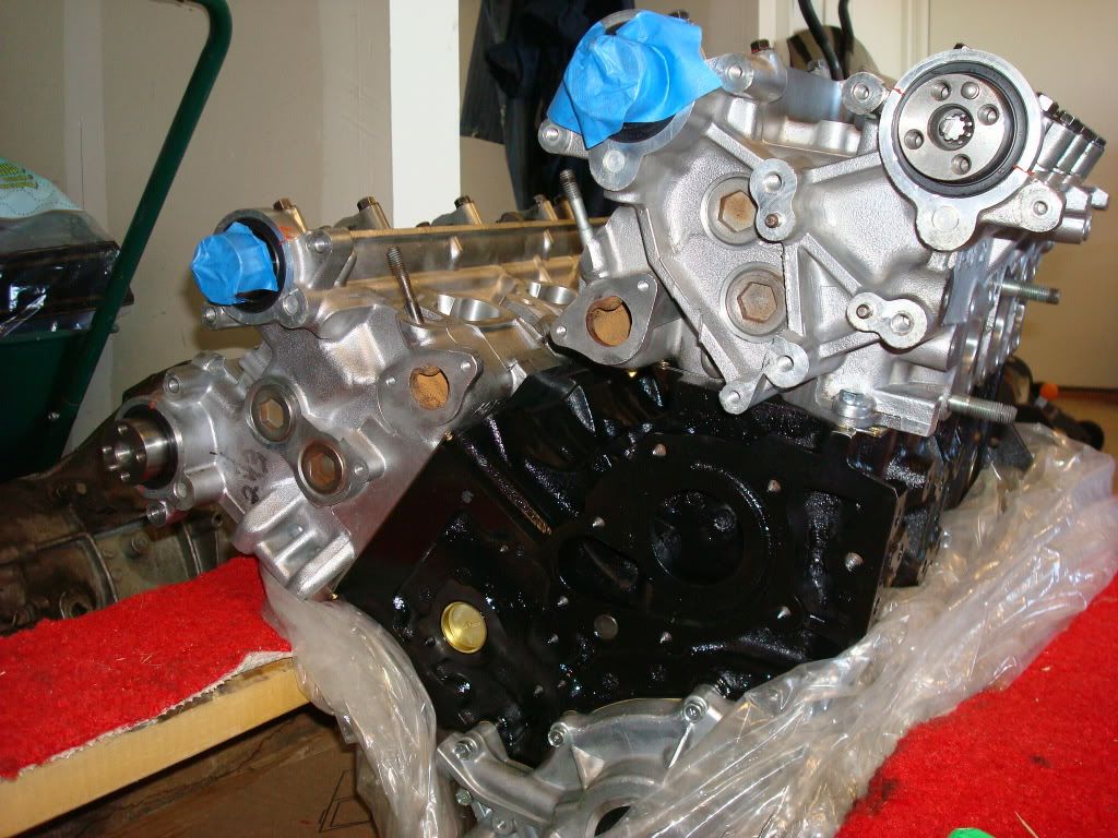

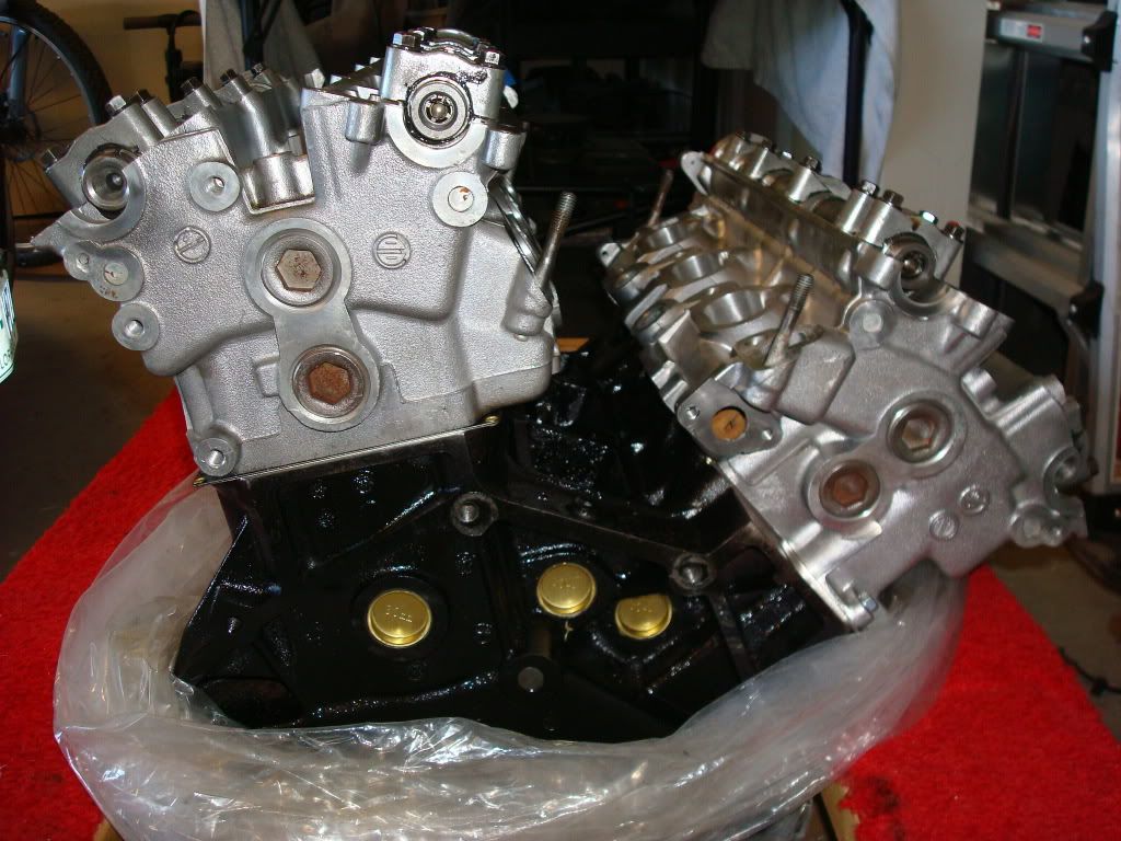

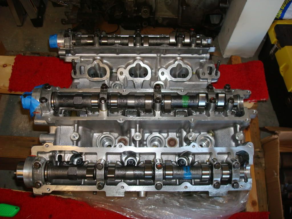

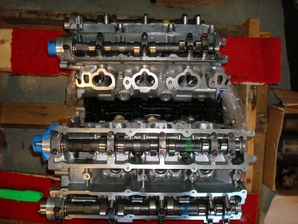

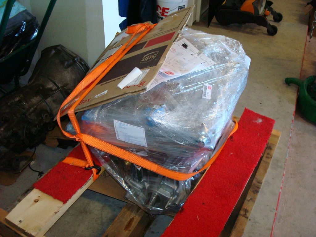

Message Just got my engine back from Kyle and I couldn't be happier. I just wish I was putting it in the Z a little sooner than next year. I won't waste your time with banter so here's what you wanted to know and the pics
Stage 5 Longblock:
Wiseco Pistons
Eagle/SCAT H Beam Rods
ARP Rod Studs
Block Inspected and acid dipped
Block redecked
Block water passage bored out for more water to back cylinders
Block Bored and Honed using a Torque Plate
Crank center weight tig welded into place
Crank balanced
New Moly Coated Race Spec Main bearings installed
New Moly Coated Race Spec Rod bearings installed
Block prepped and assembled
JWT 500 Cams
JWT HD Valve Springs
JWT Cam Sprocket Adapters
Ferrea 1mm Oversize Valves
Heads inspected and cleaned
Heads Pressure Tested
Heads redecked
Ported exhaust and intake runners
5 angle radius cut valve job
Valve heights set
New OEM Valve stem seals
Heads prepped and assembled
New OEM Cam Seals
New Cometic Metal Head Gaskets
New OEM Oil Pump
New OEM Oil Pump Gasket
Moly Coating on pistons
ARP main and head studs
OEM Hydraulic valve lifters
