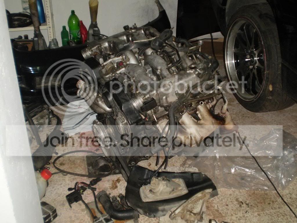

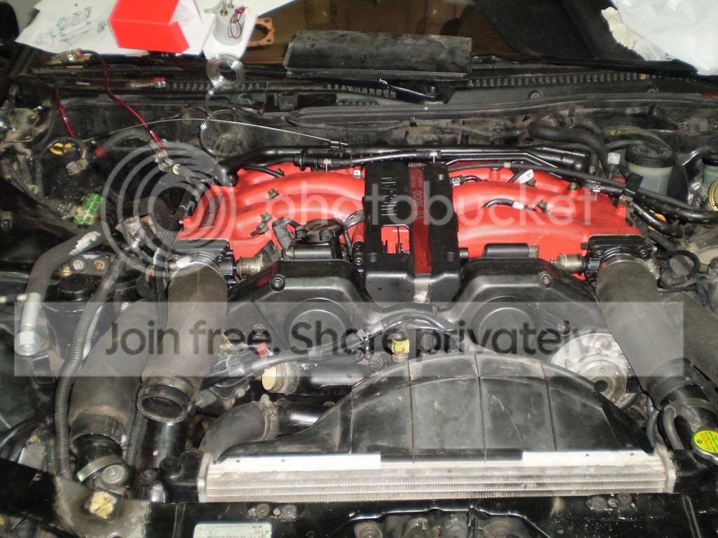

Message Old engine (NA)

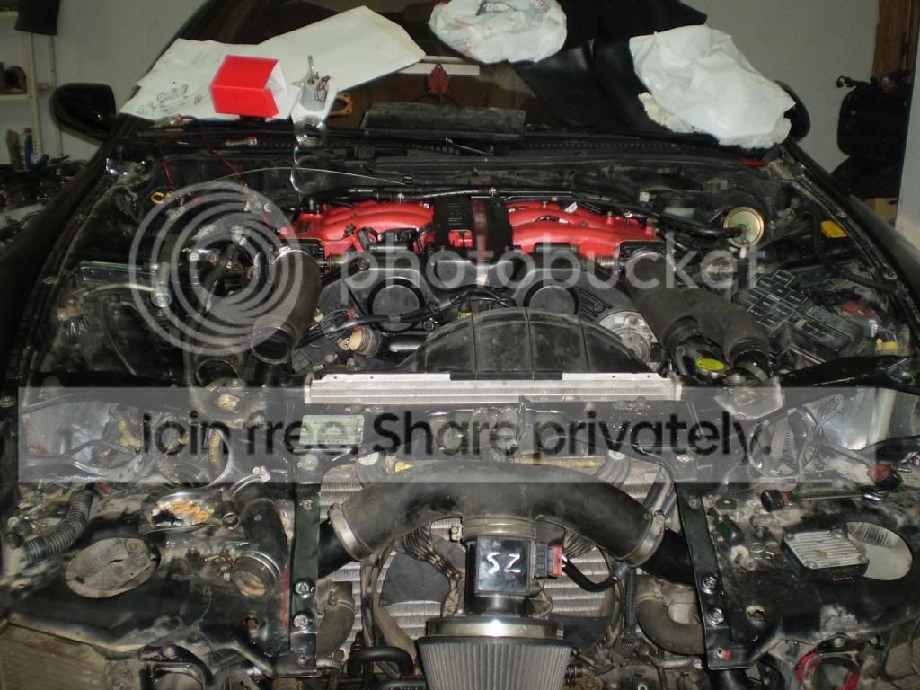

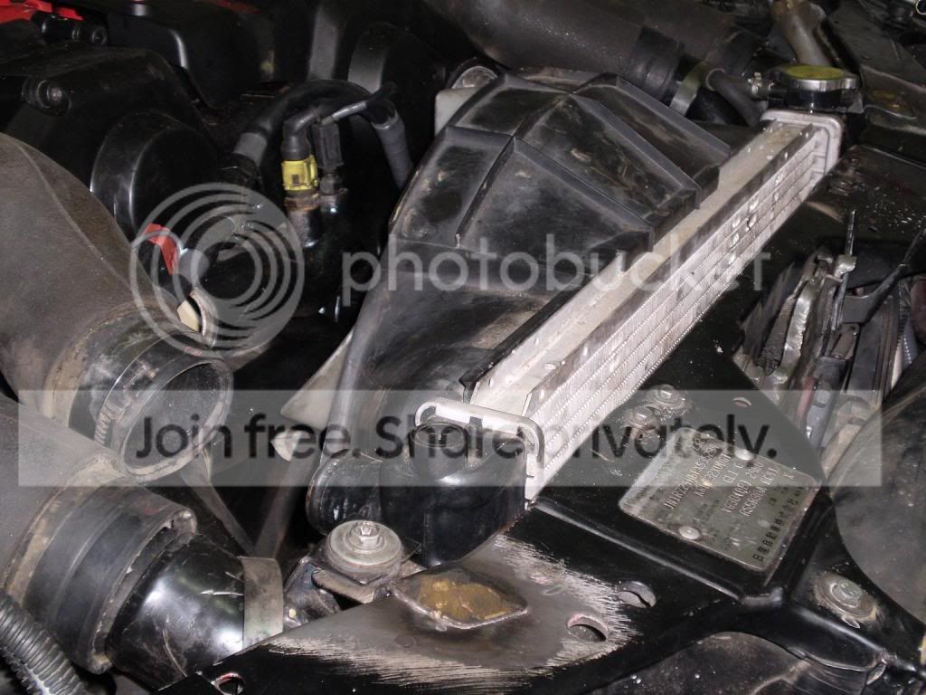

Used the intake pipes bracket from the front clip and welded them on my car
painted the plenum in red,I think it look good with black engine bay

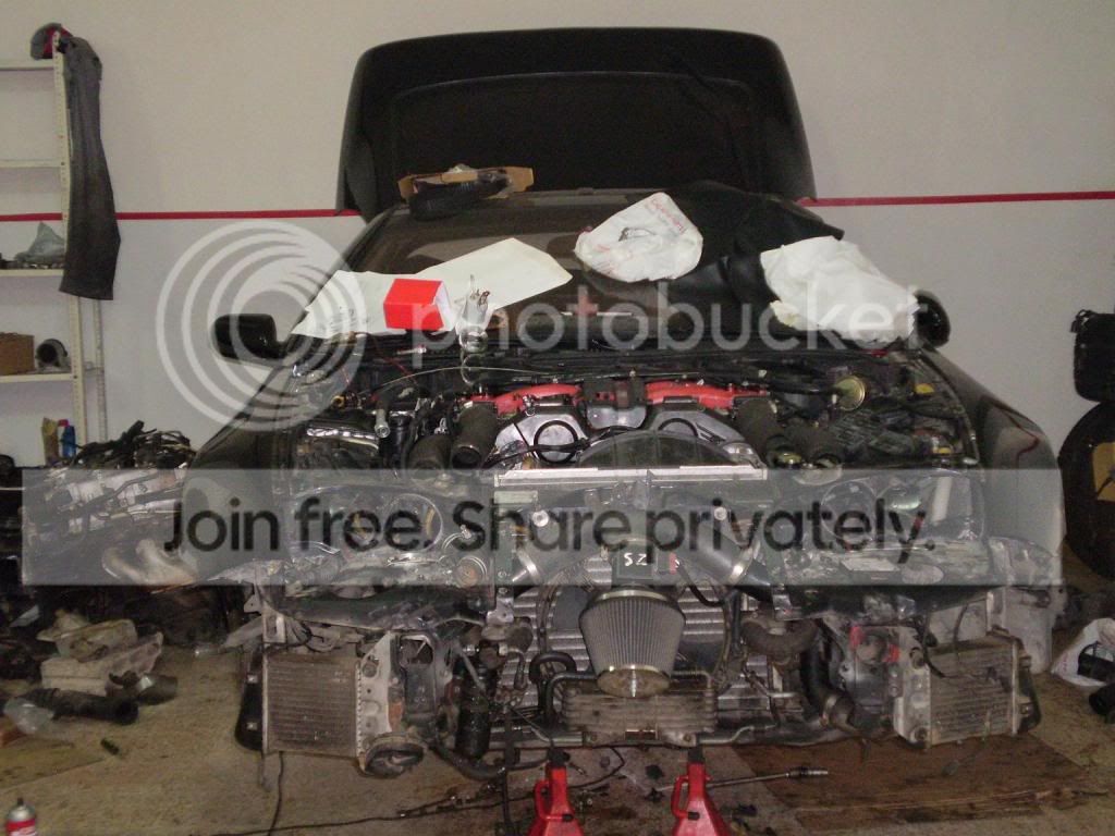

a closer look
medium shot

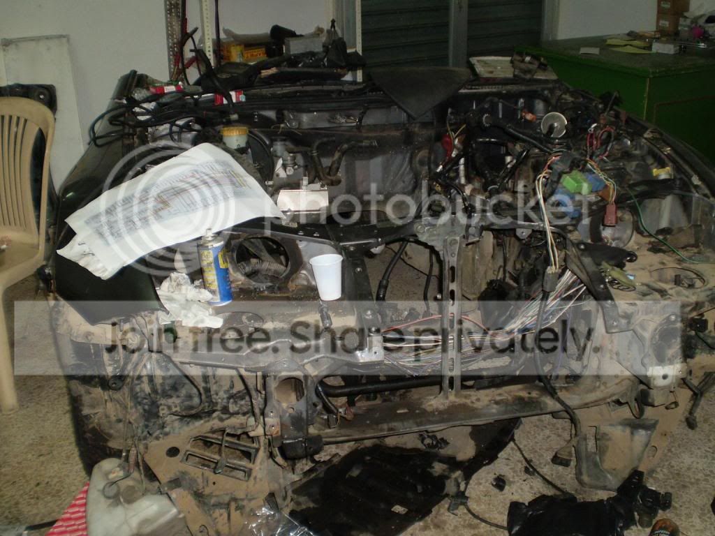

the donor front clip, I swapped everything I could,the clip was in good shape,I did use the relay and setup for the 2 speed electric fan

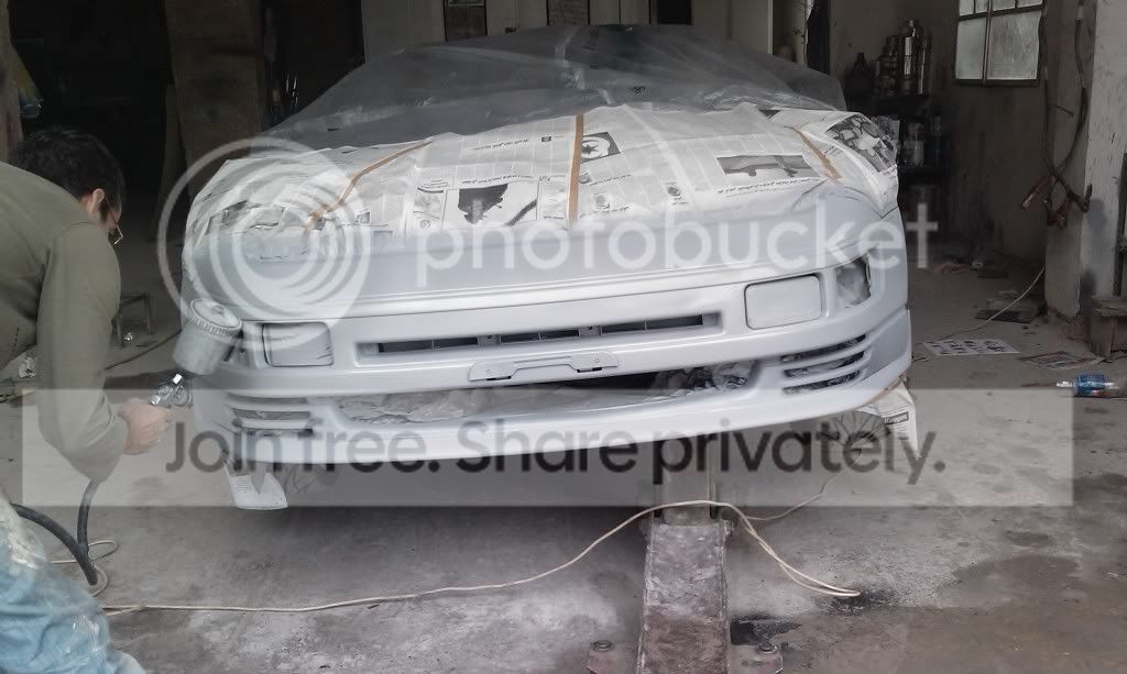

Front bumper having a base coat
