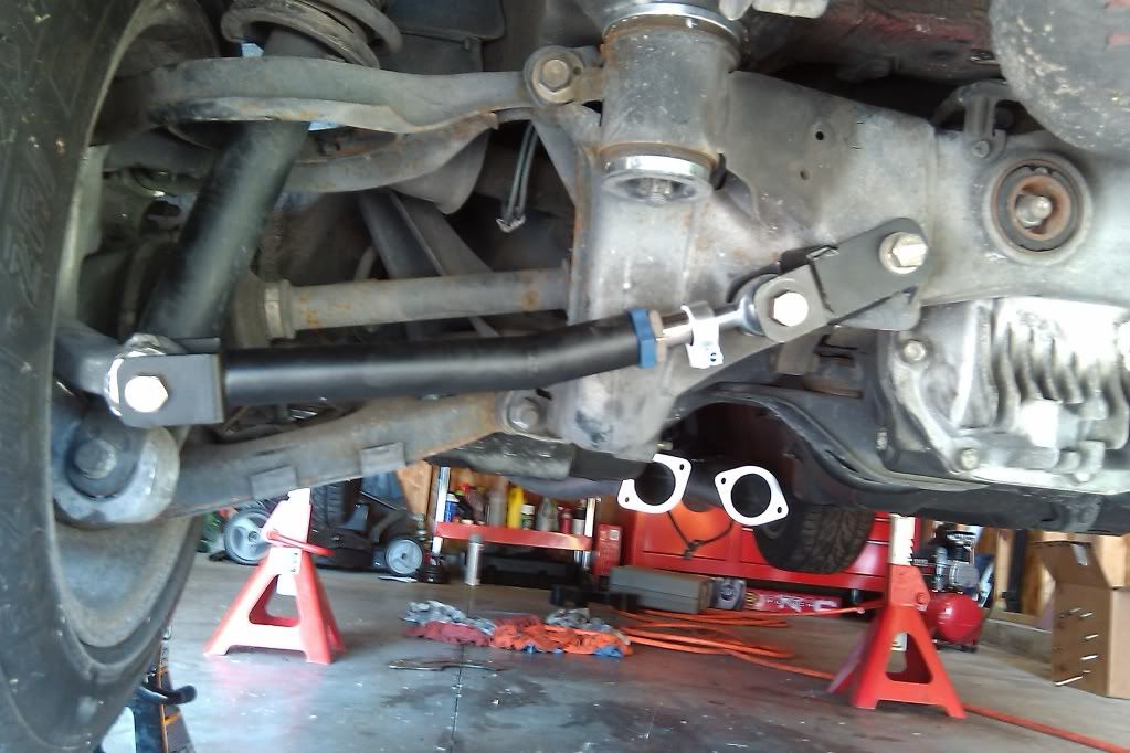

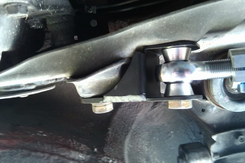

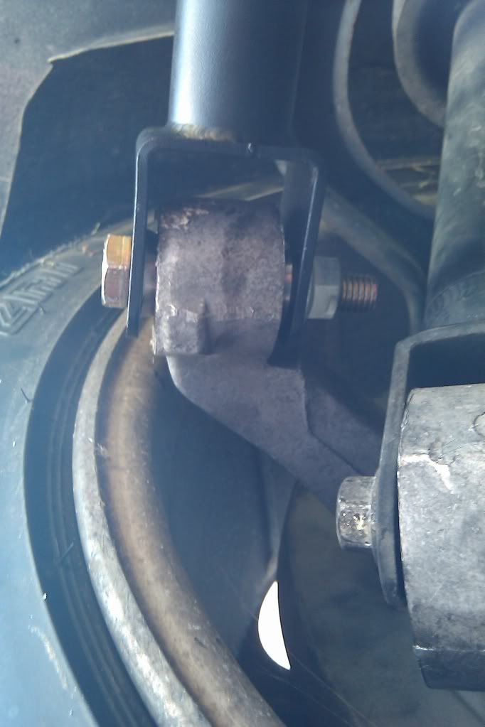

Message Sorry it took so long to get back with you guys about the new SPL hicas delete I purchased. Just got back from a 3 week vacation. Fixed my dads TT that had running issues and hasnt been driven in 3 years. The SPL kit was very straight forward to install. The brackets use the original Hicas rack bolts and a bolt that goes through the bracket, the toe rod, and subframe. I used a pitman arm puller to press out the old ball joints and press in the new bearings. All I had to do was remove the lower shock bolt and move the shock around till the puller fit. I pushed the old ball joint out and then tapped the new bearing in a little bit, then pressed it the rest of the way. The kit didnt come with washers for the bolts, so I might get some and put them on for piece of mind. I know I dont have the hybrid adjusters correct, but I just wanted to give you guys some pictures. Thanks Kuah for another quality part. Im looking forward to using more SPL parts on my Z.
sorry for the crummy cell phone pictures
