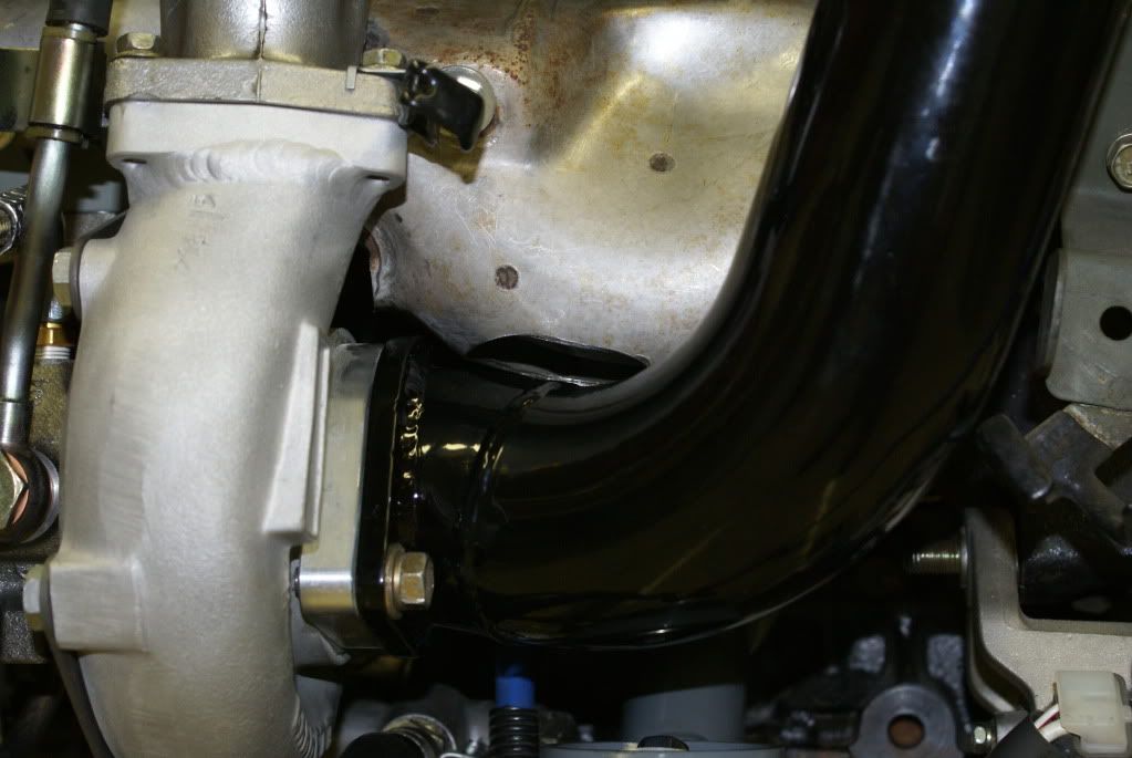

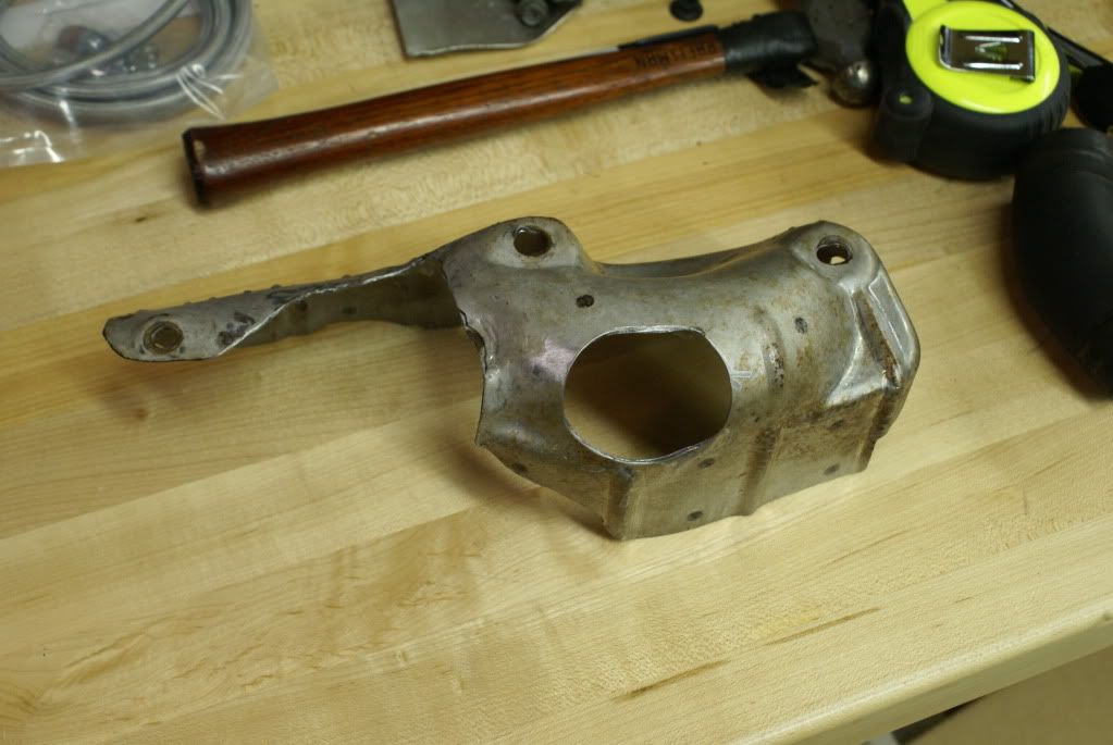

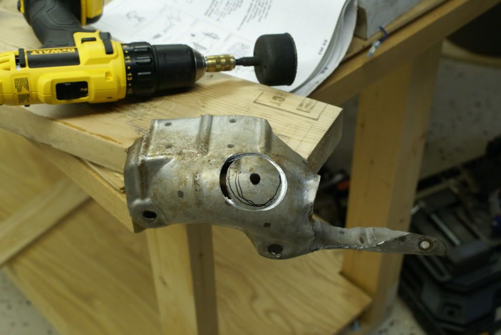

Here are a few shots I left out of the last post.
They show what was necessary to get the Passenger side Heat shield to fit with the 2.5" intake piping.

It couldnt have been just bent alittle?
1badz32 (MN)
14:56:57 07/04/11
it looks like a bit of denting in the HS with a ball pein
induetime
16:40:24 07/04/11
I tried. This area of the shield is 2 layers with welds
Boosted1
21:26:56 07/04/11
I took a hammer to mine in the same spot and it worked fine. (n/m)
