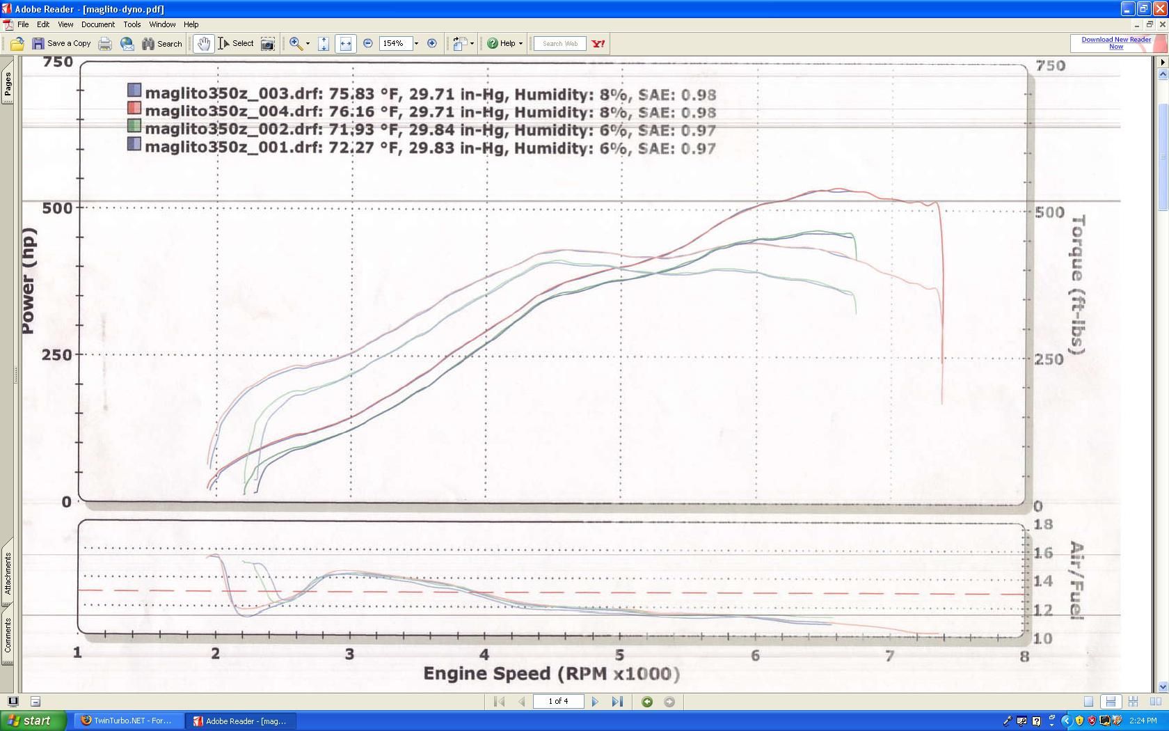

This is tt.net member maglito's dyno with sport 700's and the breather mods
the two different curves are before/after expansion DP's + 3" exhaust
