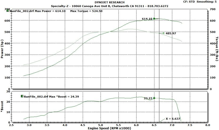

Message New mods include Ash inlet pipes with Planor intake placement, v2 modified to fit garrett gt2560r, Ash massive ic's and 2.5" pipine. I also am running JWT 500 cams and mod list is current. Awesome work Greg, Seb, and Brooke (though I threw a few wrenches in the set, you guys recovered like it was already in the plan), anyways, thanks for everything.
To the real business:
91 Octane
Photobucket">

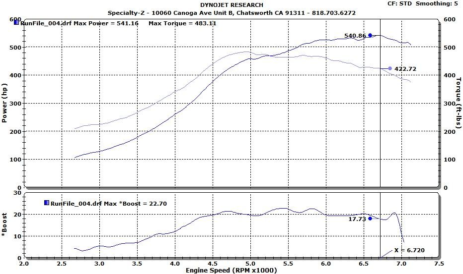

100 Octance (unleaded)
Photobucket">
