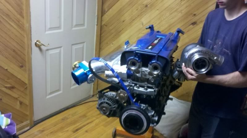

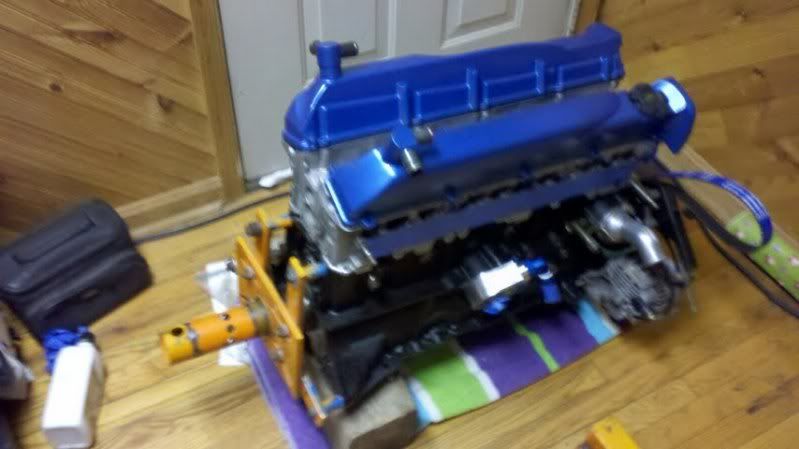

Message Ok so I finally found the Block dowels that make the head gasket line up to the bores and got the head back on and torqued
Playing around
Off the stand for rear end work

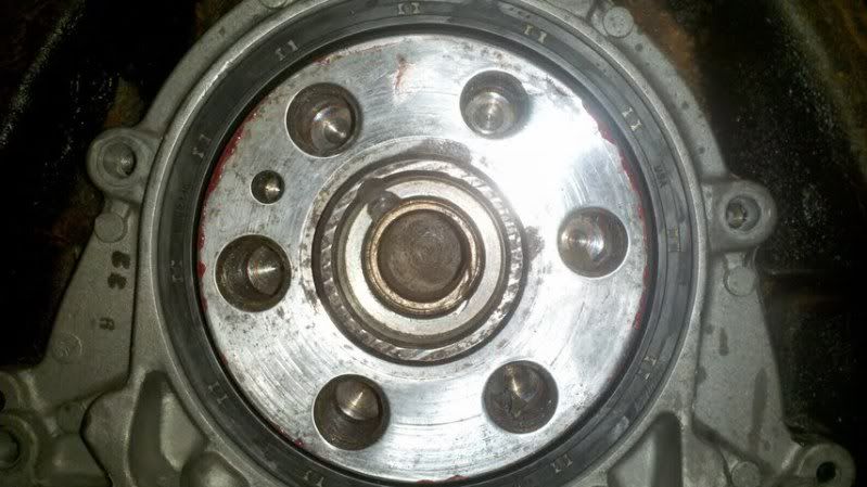

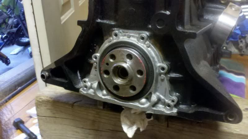

Auto pilot bushing removed and 5 speed installed with new rear main seal
Flywheel on, torqued to 110 pounds with loc tite

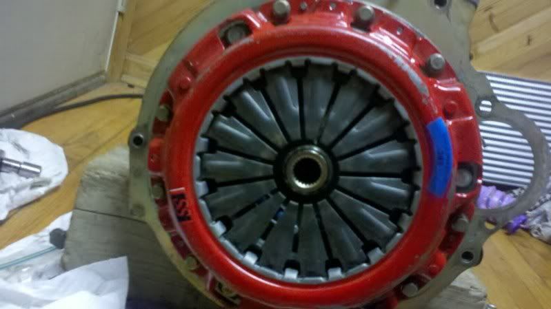

DXD Stage 6 6 puck Feramic clutch
Ready for the trans

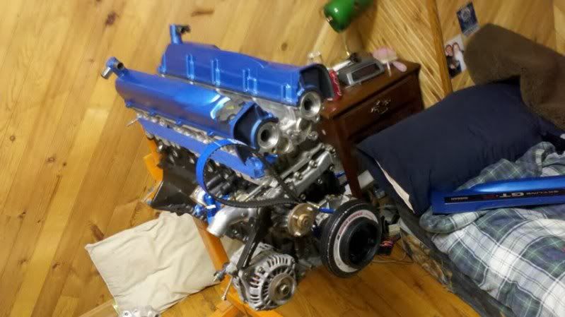

Waiting on cams coming in this week, then install with greddy gears and then finally get it in the car!
