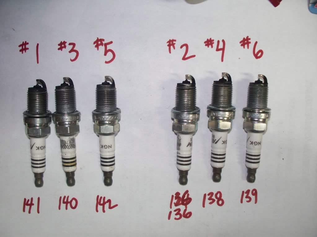

Compression test results an average 136-142 Cyl #1-6 (rather low)
