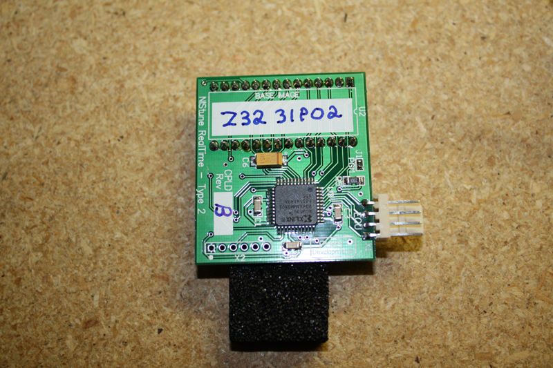

Message I was sent a nistune board to repair broken pins. This one belongs to Brian aka member (My Harley). This makes probably the sixth board I've repaired for this problem.
The header pins which come with the nistune board are made of a hard material and are not very flexible at all. It doesn't take much to break them, so if you have a nistune board, be very careful with them.

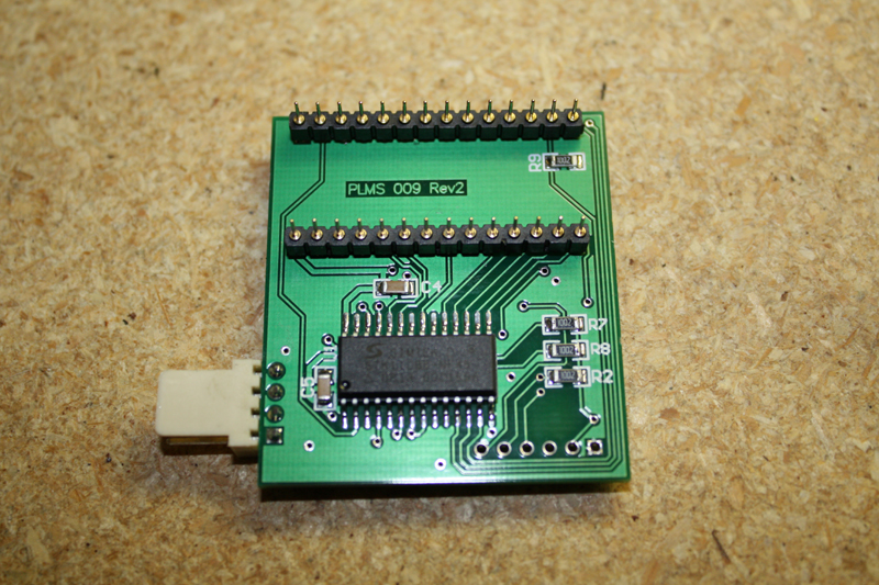

I replaced the pin headers with gold plated pin headers made of a softer material which are much more flexible. Here are some pics.

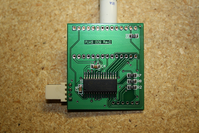

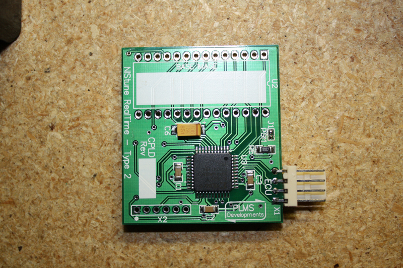

The nistune board after removing the pin headers.
New headers installed.

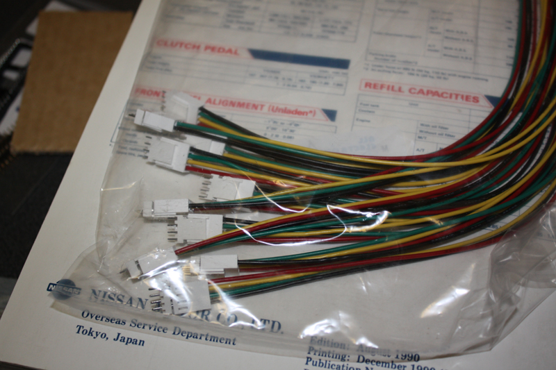

Brian has a couple of ECUs which he likes to have ready for a nistune board installed so he asked me if I could install a harness in both ECUs.
Extra nistune harnesses.
