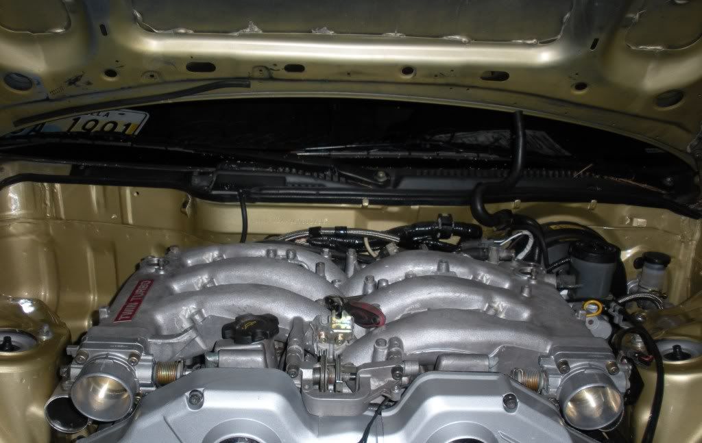

On your 60mm tb's, did you add material to the plenum like
posted by Wright (Ca)
on May 09, 2011 at 05:49 PM
I went after the OEM look, I didn't like the idea of ovaling the holes on the throttle bodies.
Anyone else have issues with their Z1 58mm throttle bodies?
zgene4
15:31:17 05/09/11
Hmm..So because you bought the TBs 2nd-hand..
ForceFedTT (SoCal)
16:50:38 05/09/11
Almost all known companies I know of warranties are NOT
Gennosuke
17:50:11 05/09/11
i have the problem on new tb but i did not bother going to
ztunerz
18:31:11 05/09/11
I had the same problems with them a few years ago.
Wright (Ca)
17:49:40 05/09/11
I did it like Ash did. -
90GoldZ
18:05:52 05/09/11
Want to do another plenum for me? (n/m)

I have spare plenums. I will modify the tb's myself. Just

S2z
17:56:49 05/09/11
all of that is beyond my toolbox capability and should be

I'm having similar problems with mine.
MY3ZTT
19:49:55 05/09/11
Diddo ... adjust , tap shaft , adjust , tap tap tap tap ....

I hate to hear that you are having issues with our Throttle
Dustin@Z1
11:28:16 05/10/11
Thanks for your reply. I did contact Z1 as my first

The ones I put together....

I could help you fix it

tried the loose screw centering method, no luck because
