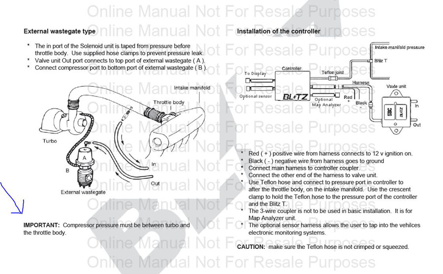

Message Everything that I have read (including the manual) says that the valve unit should get its boost signal between the turbo and throttle body.
Why couldn't you pull the boost past throttle body?
What specifically prevents this from being possible / a good idea?
What would happen if you did tie in past the TB's, for example to the balance bar?
