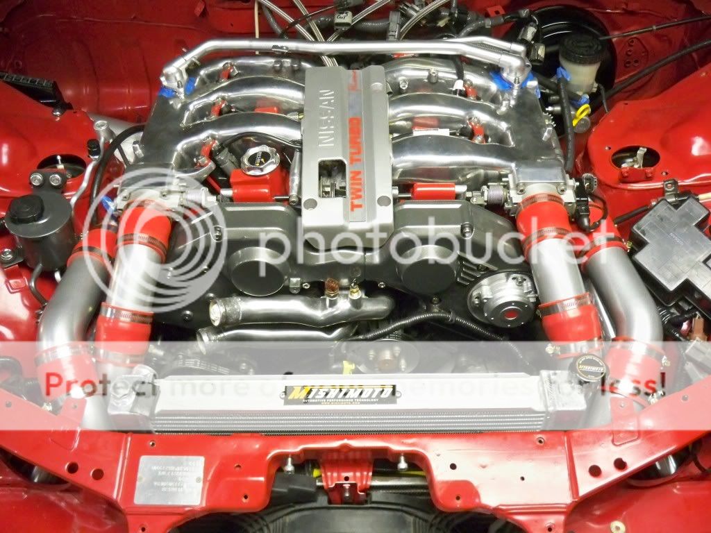

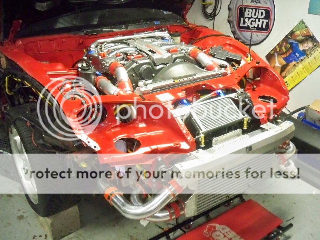

Engine in

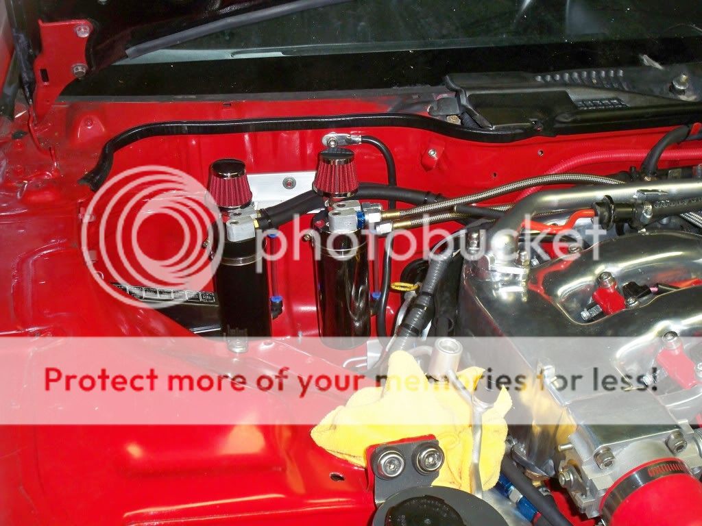

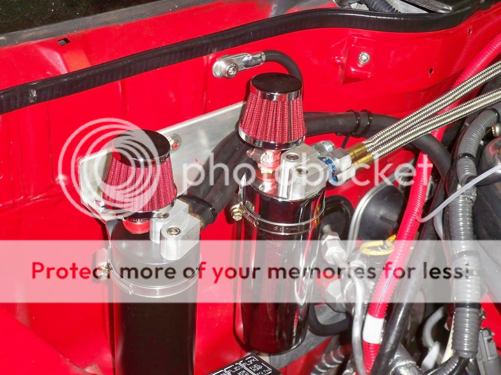

The engine has no PCV , just 4 vents to catch cans .

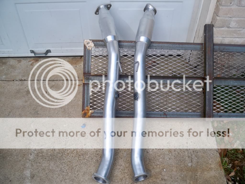

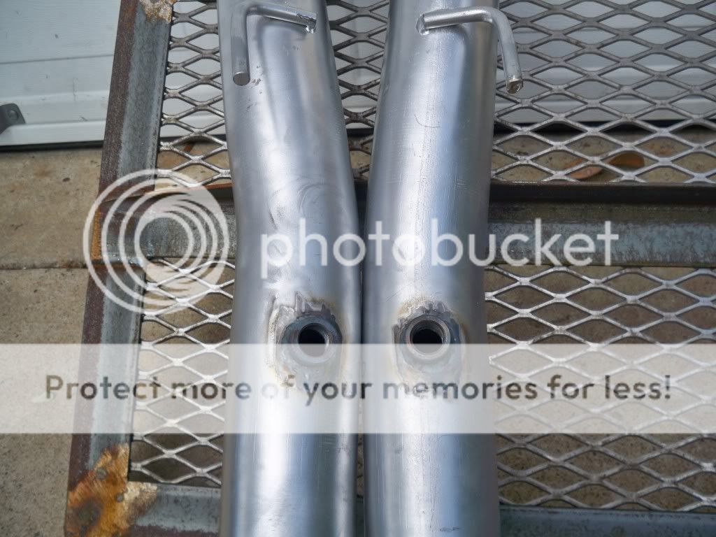

Had to bung the testpipes .

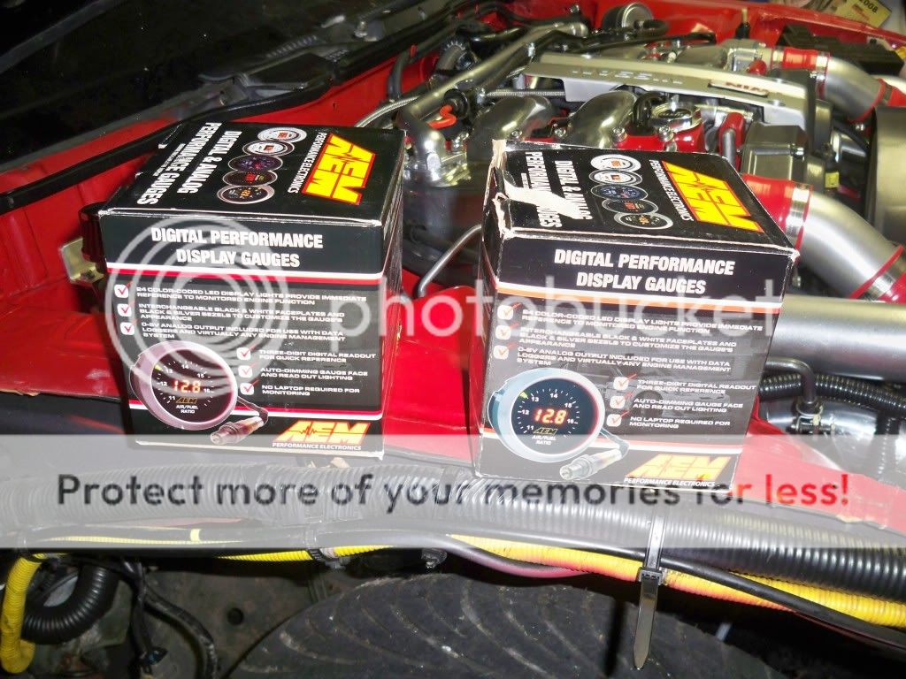

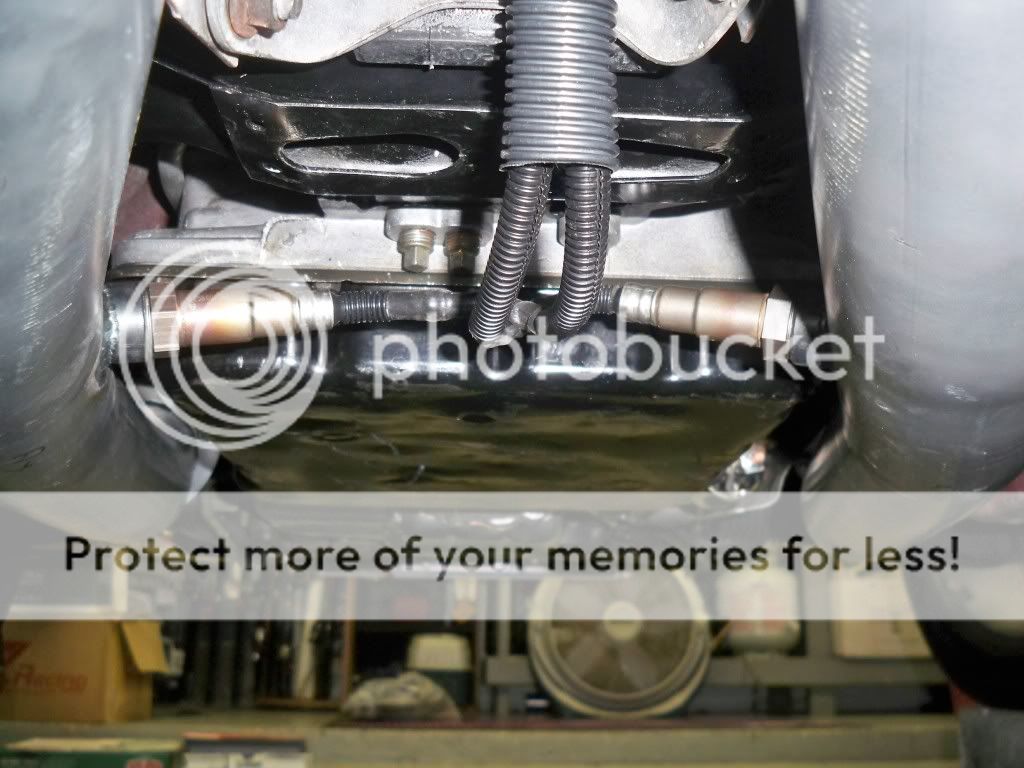

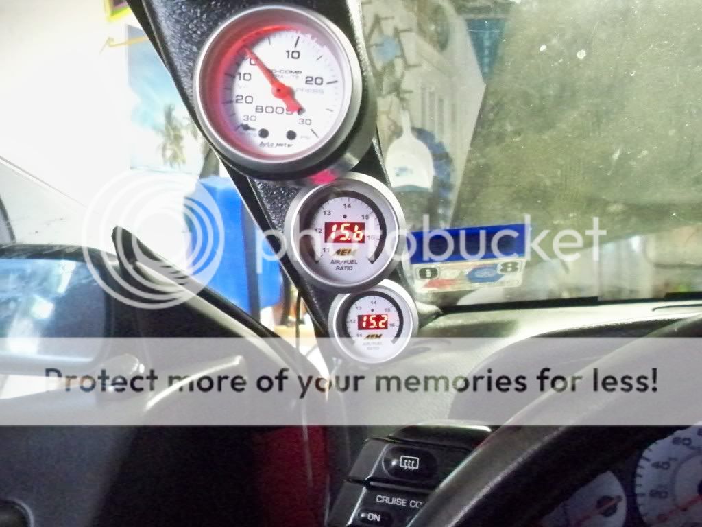

I had one wideband so I picked up one more of the same .

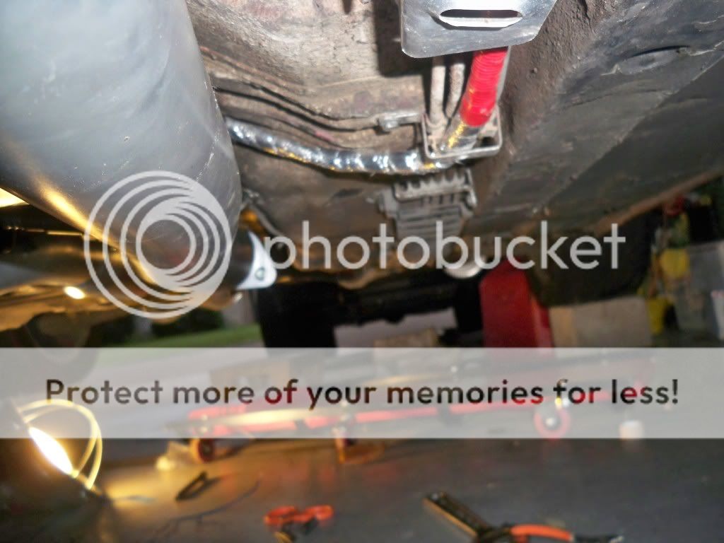

The wires were heat wrapped and ran in the old hicas brackets then behind the gas line heat shields .

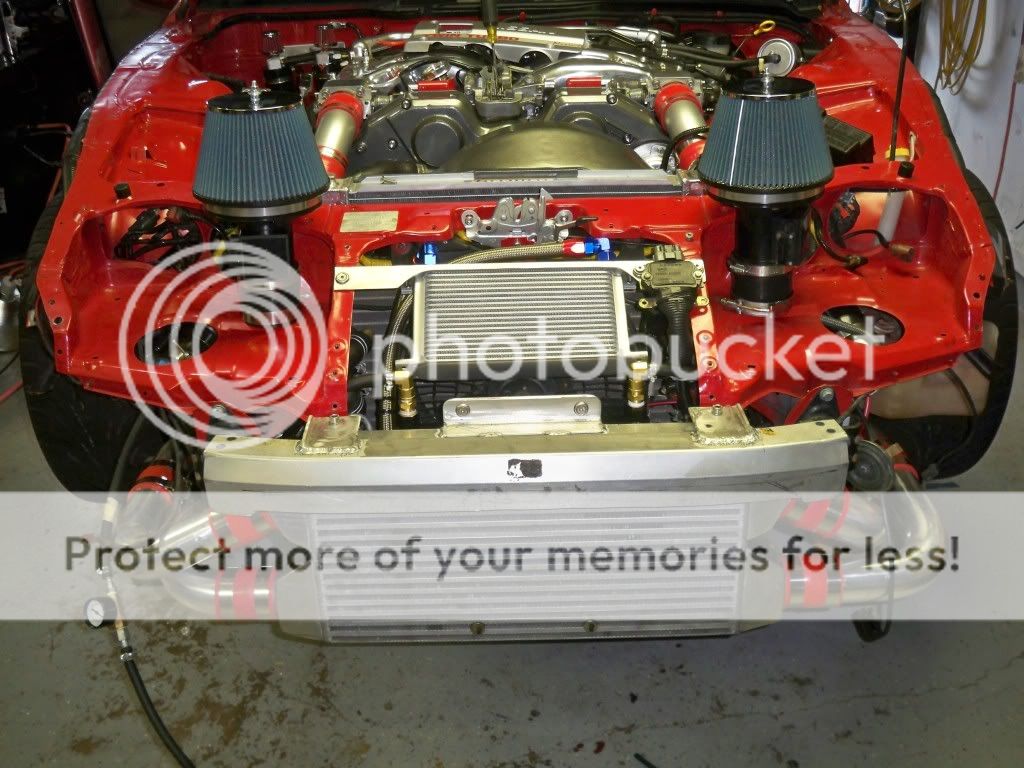

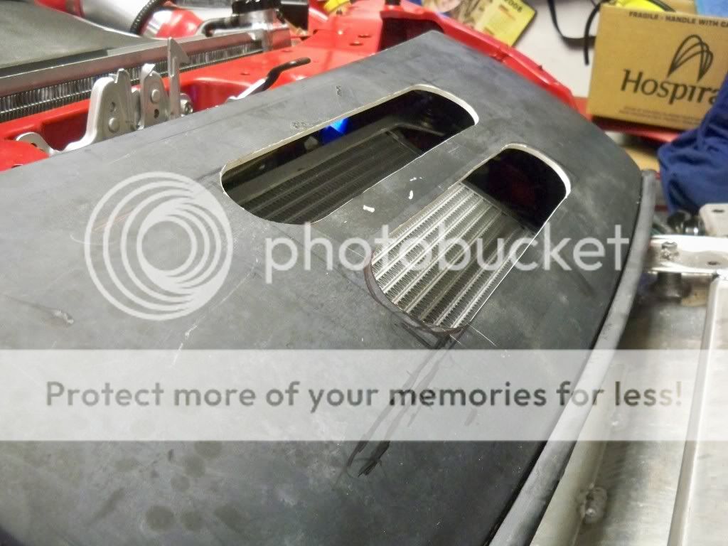

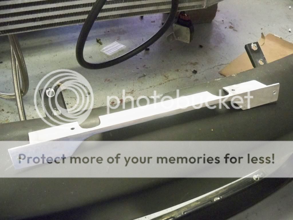

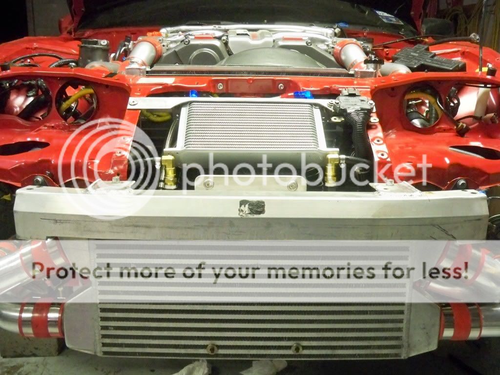

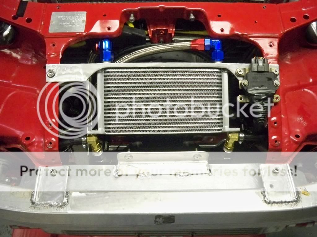

Made this bracket to move the oil cooler . Moved the oil cooler because I also have a B&M tranny cooler w/fan up there so I wanted more flow and to seperate heat sources . The nose panel will be screened and ducted for the oil cooler ( not sure i'll stay with the one in the pics ).

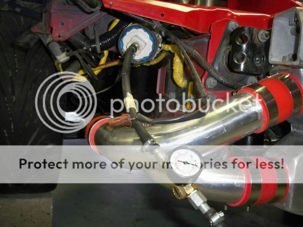

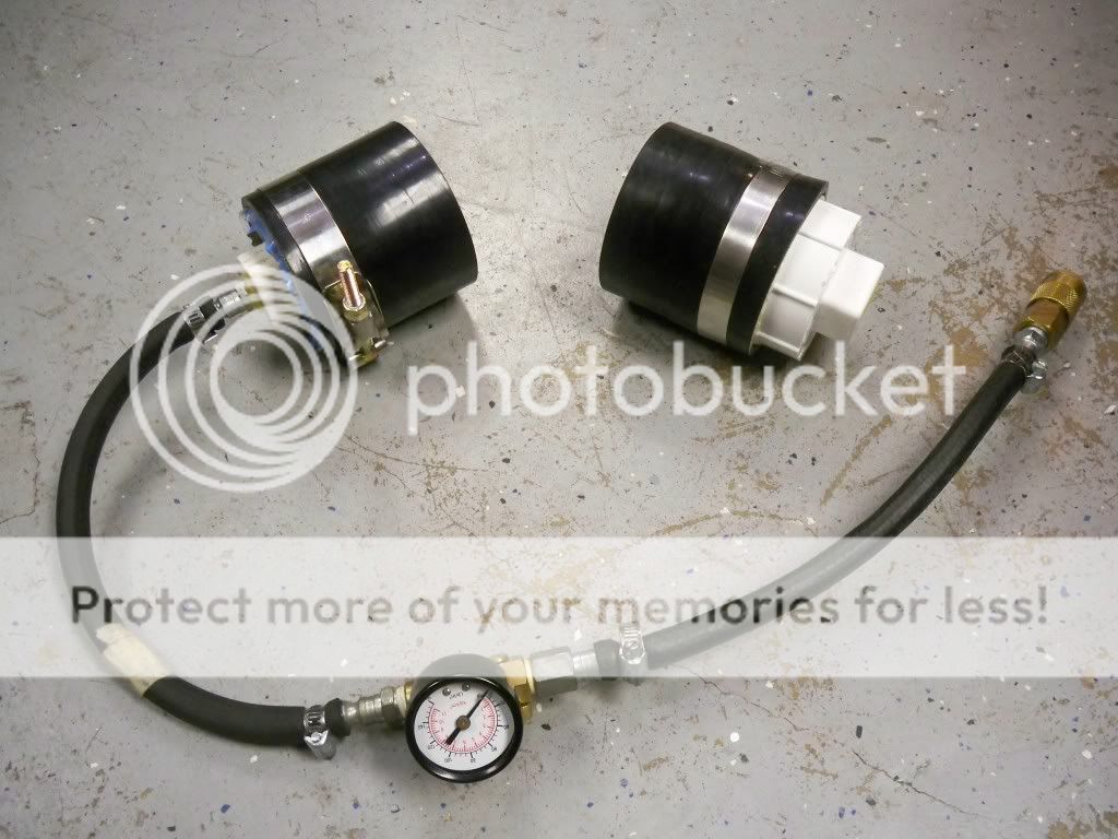

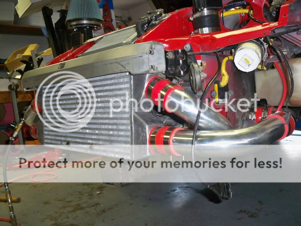

Since my front vents dont connect to my intake I was able to do a 20 psi boost leak test with no leaks ! I did open the oil cap and pull the dip stick to releave any blowby due to open valves and pison ring blowby . I opened the butterflys , caped one side then pressurized the whole system at once . It was holding 20 psi while losing a small amount through the cylinders until the end cap blew off .

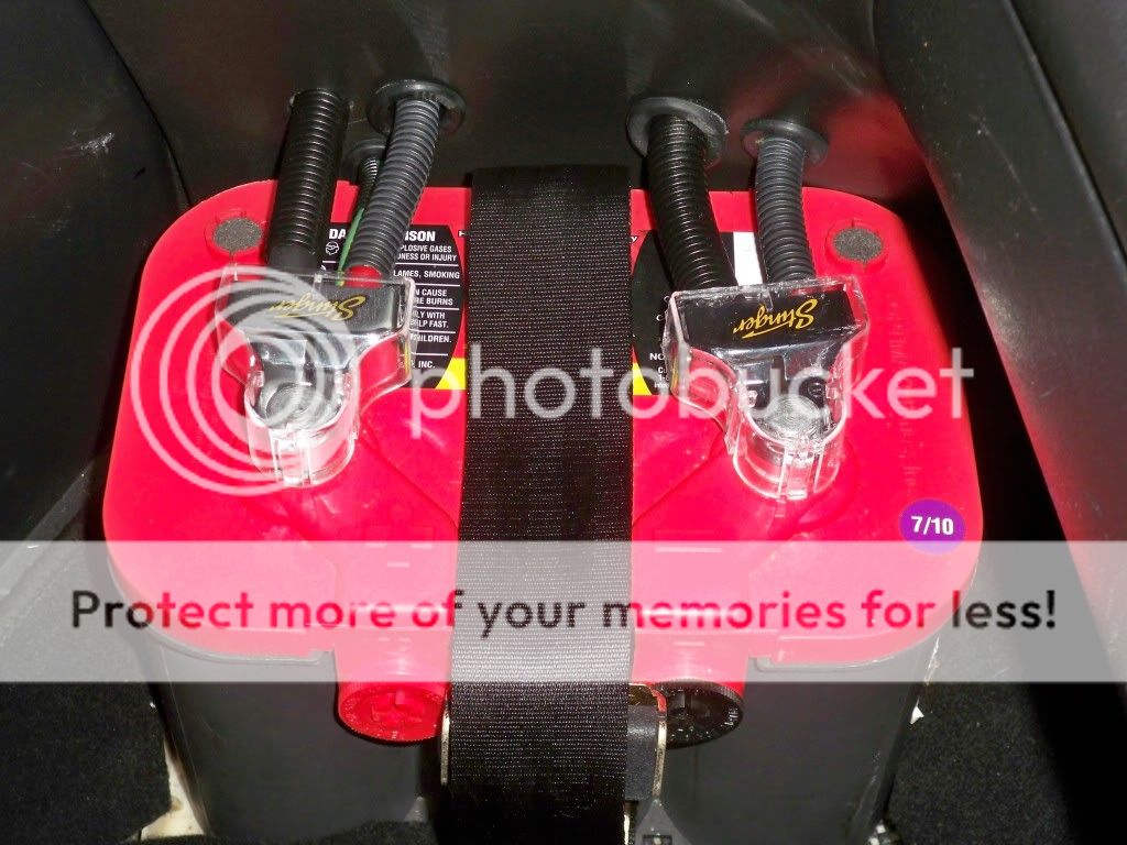

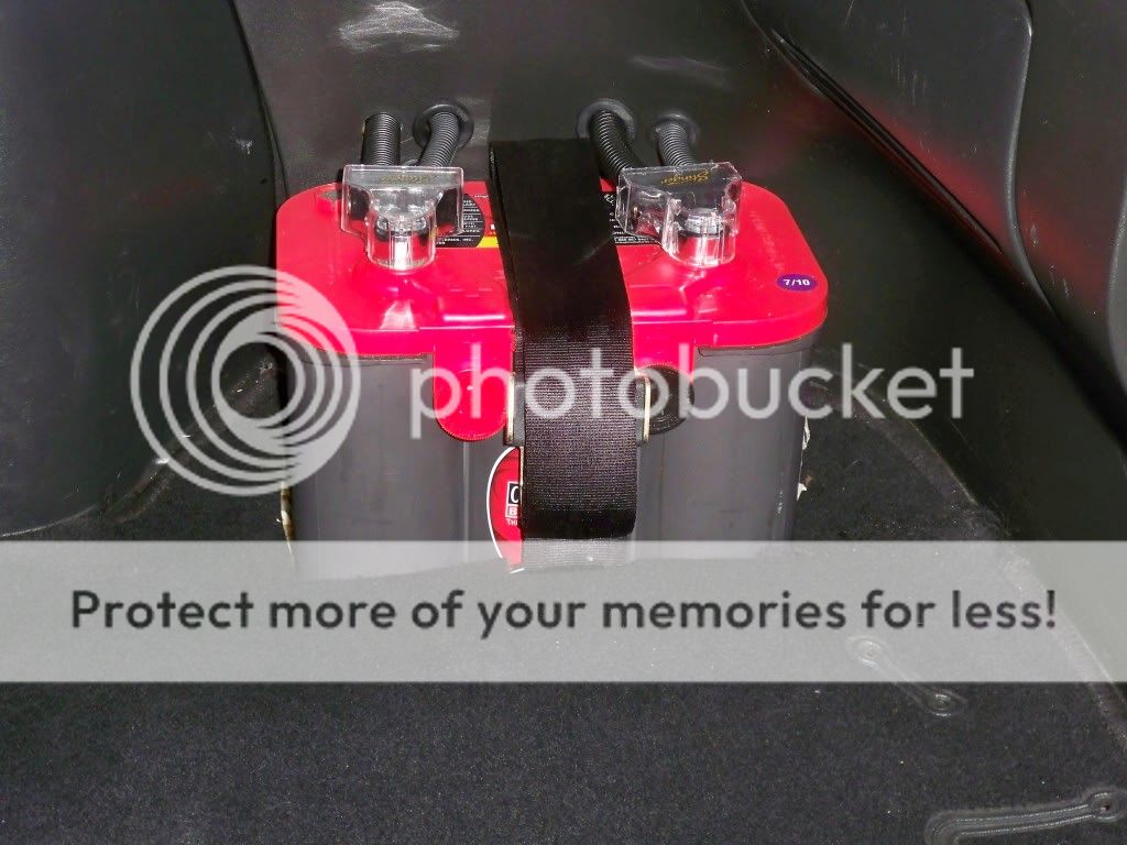

Finally hooked up the Batt .
