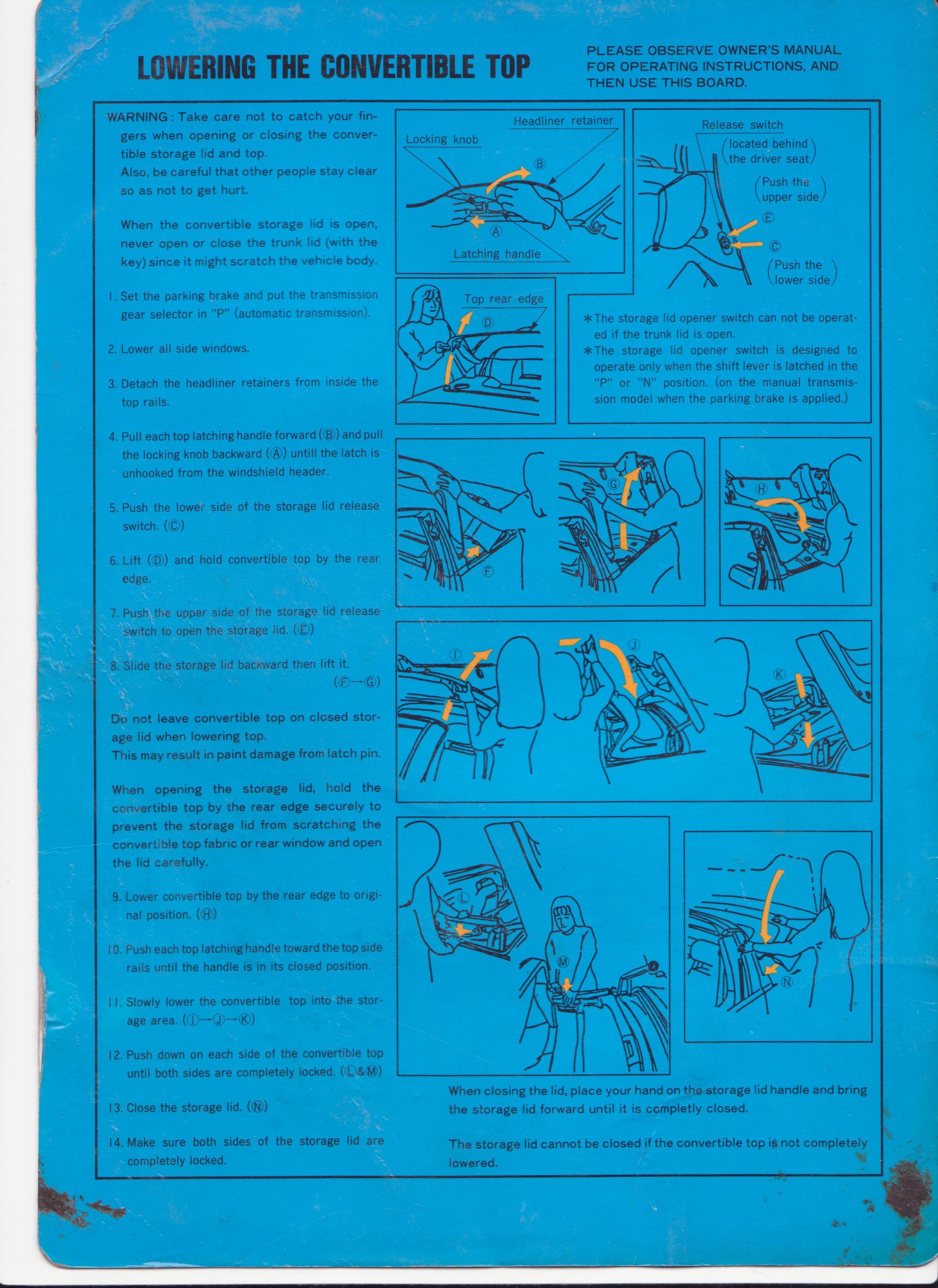

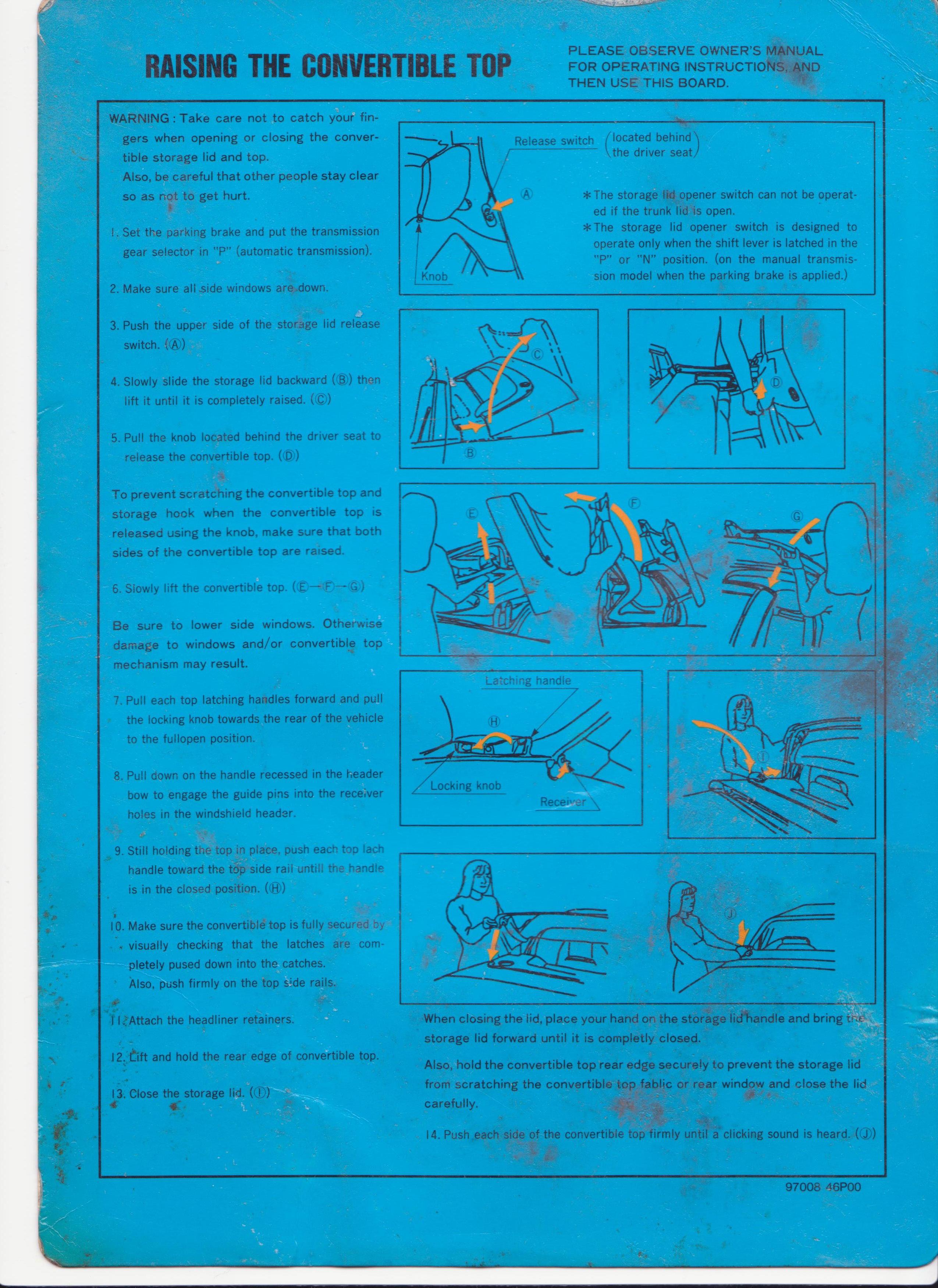

Message I'd wait for warmer weather to fold the top... you'll crack the rear plastic window below 40 deg.
from the owner's manual: (thanks YugoB)
