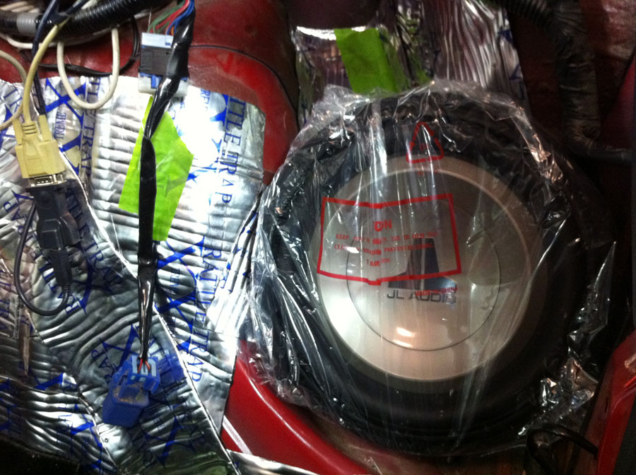

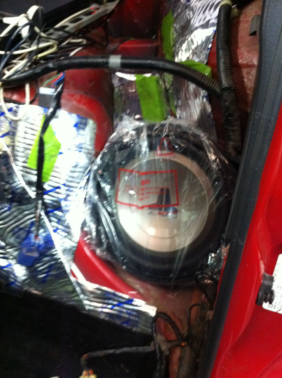

I started looking around for places to stash an 8 or 10 inch sub and decided to got with a spot behind the driver seat where the fuel pump controller is located. I bought a JL Audio 10w1v2-4 (shallow mount). It only requires .6 cubic feet to operate and had a mount depth of 4 inches and change.

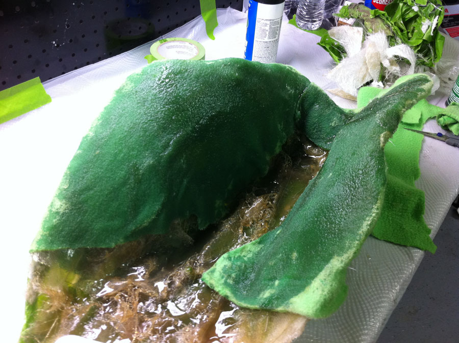

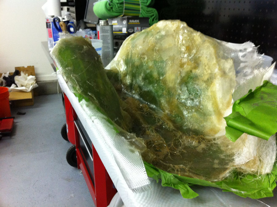

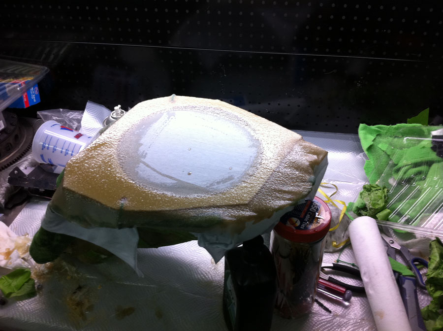

Once the speaker arrived I did a quick test fit and then covered the entire channel going back toward the trunk with painters tape and made a fiberglass mold of the bottom.

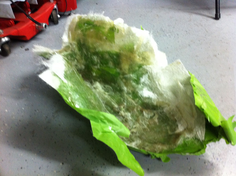

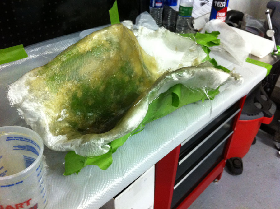

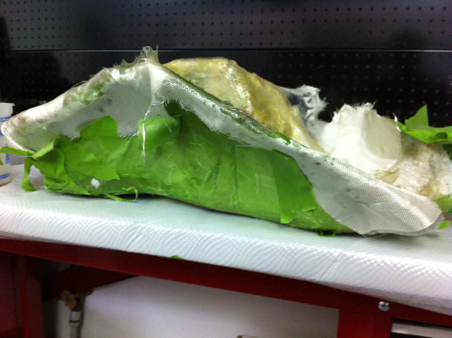

This is how the mold look when it first came out.

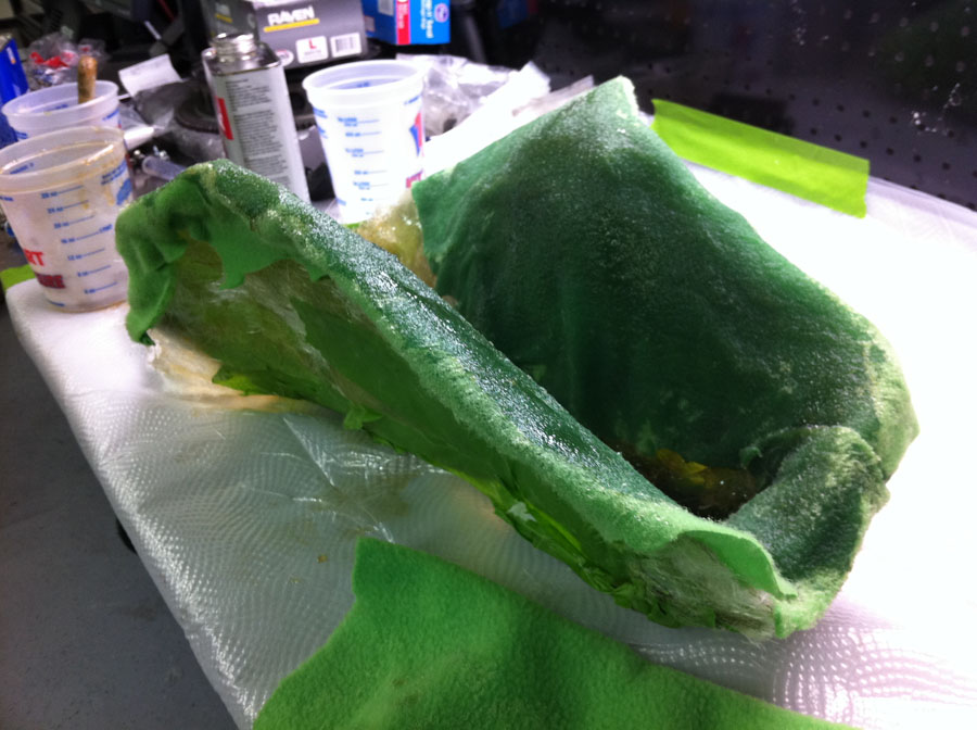

I added some additional layers for strength

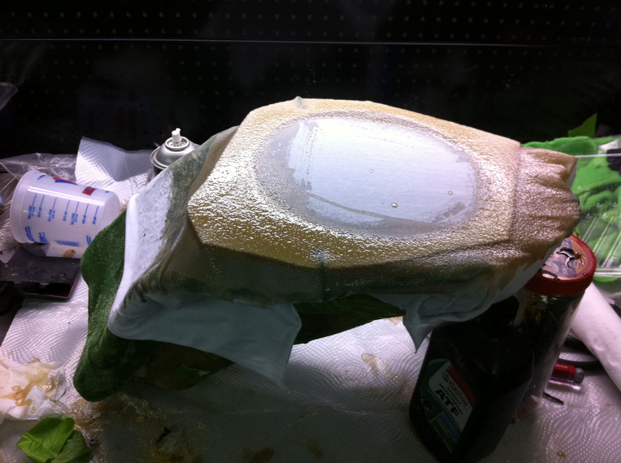

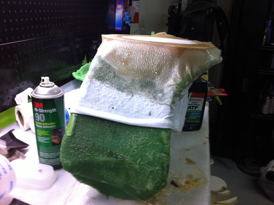

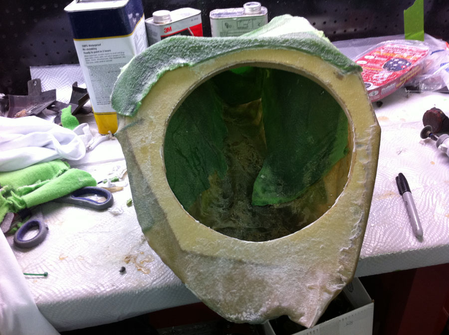

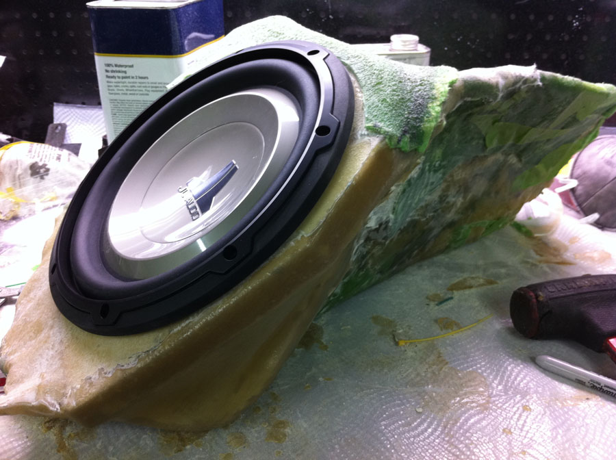

Here is where I started making the place for the speaker to mount

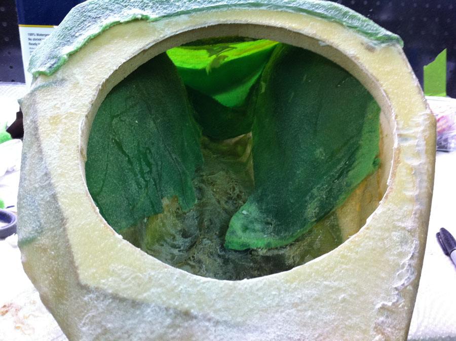

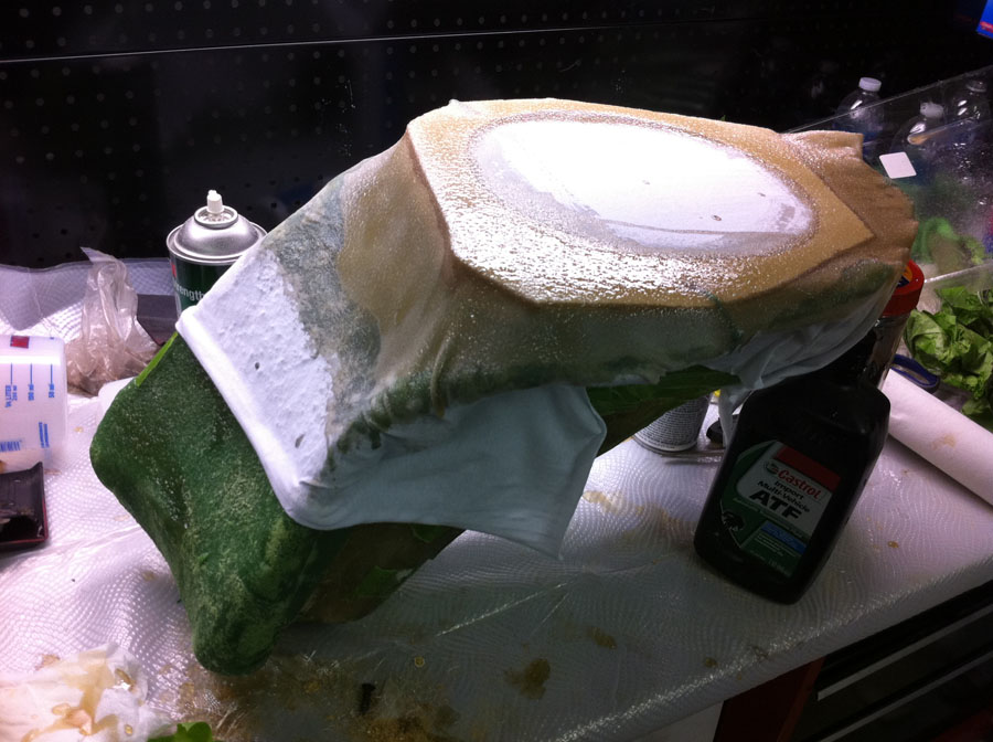

Speaker cut out

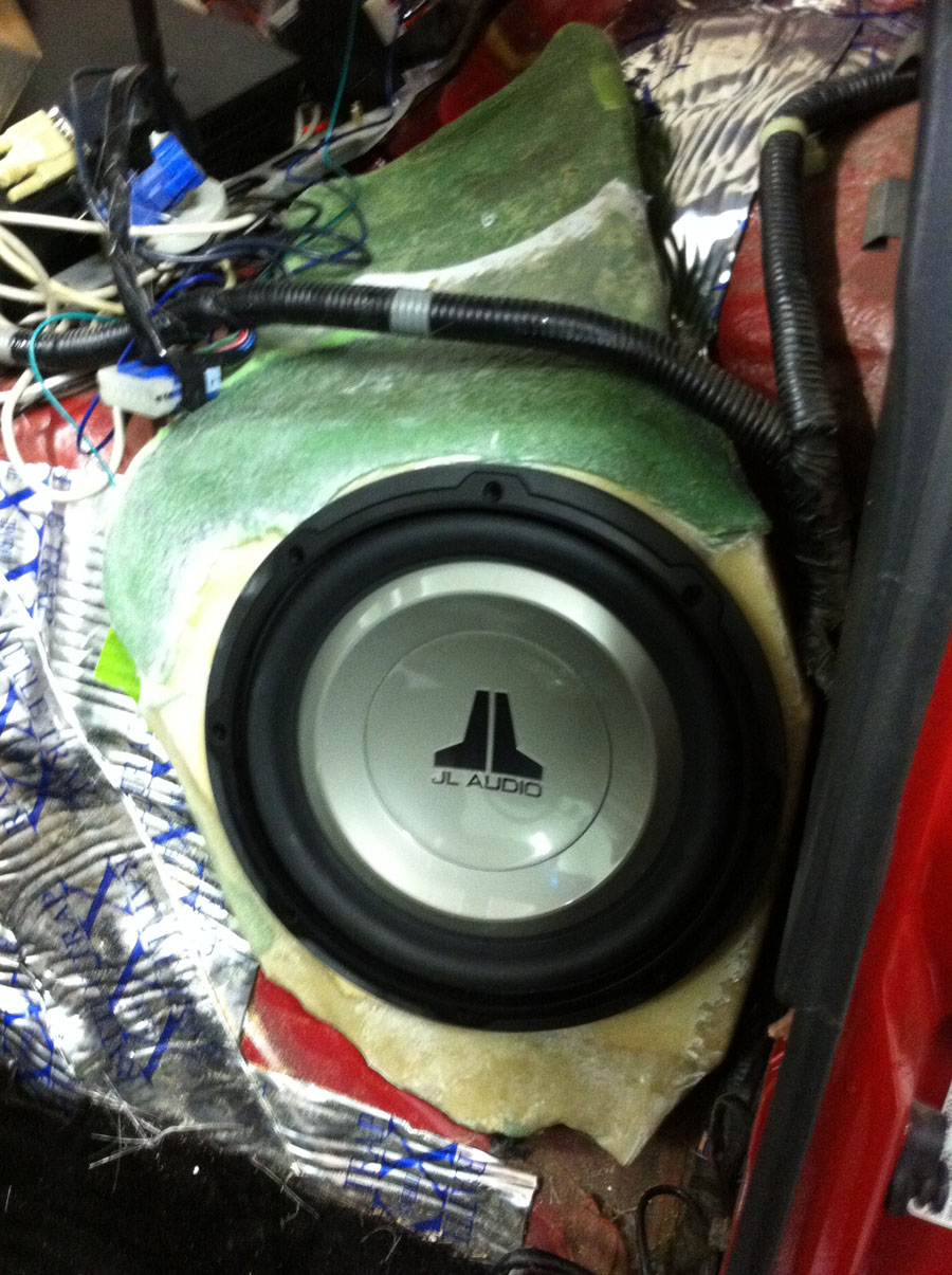

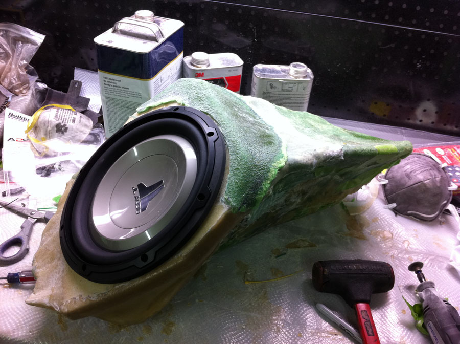

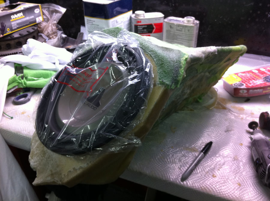

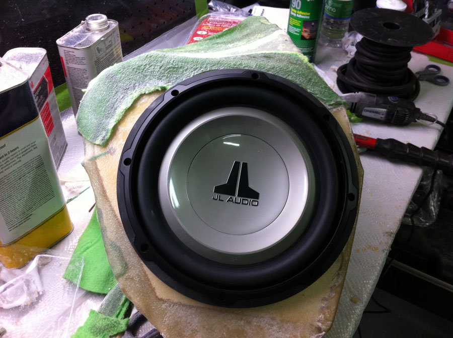

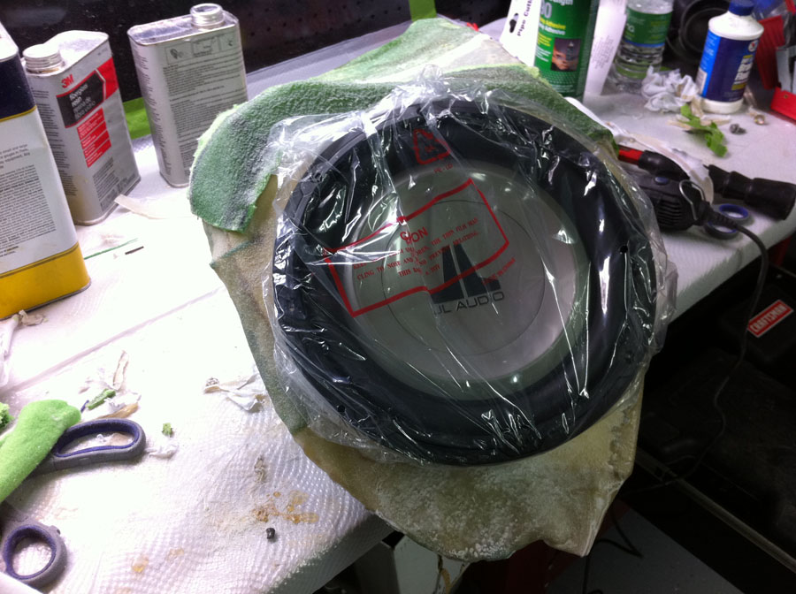

Test fit of the speaker
Fitment is very tight...shouldn't move around any

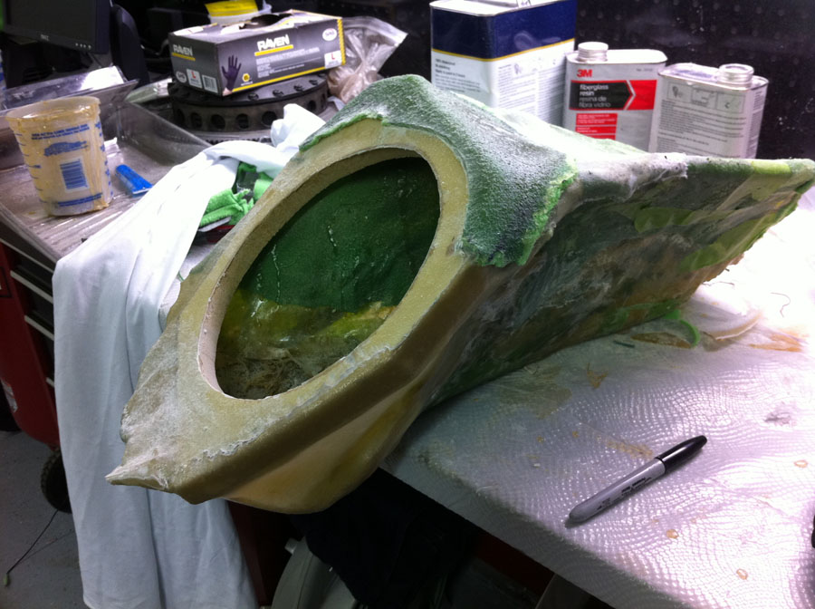

For my first attempt at fiber-glassing I am very pleased with how it turned out. Since it will never be seen I probably wont do anything to clean up its appearance any and just leave it ugly :)
