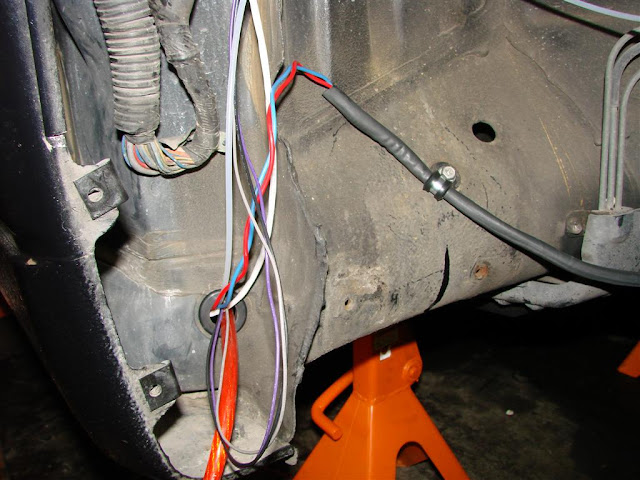

Subject For my amp I ran 4 AWG through the passenger side
Posted by BigTDogg (MA) on December 21, 2010 at 12:18 PM
  This message has been viewed 184 times.
In Reply To Alright so, tape a coat hanger or some thick metal rod to posted by mogaffar on December 21, 2010 at 11:55 AM
Message Because it's closer to the battery. From there you run under the door sill. If you remove the carpet there are little 1.25" or so diameter plastic circles covering holes in the channel. You can get in there with needle nose pliers and coax it along.
In your case, I would just use a 4' long piece of wire, stiff enough it won't fold when run through the channel, and then pull your wire through that way.
