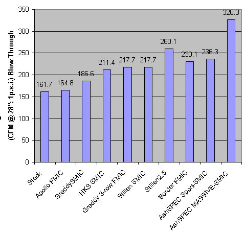

Waves magic wand..... -
SeanK (StL)
01:29:20 12/10/10
damn (n/m)
blackomega
01:37:16 12/10/10
I knew that graph was around but I didnt notice they did
5280Z_nightstalker
01:41:21 12/10/10
I'll do you one better.

Chart above doesn't seem accurate-Greddy's dont look so good
ZXoltan
09:00:46 12/10/10
Ash did the tests.
Woody75 (Denver)
09:32:33 12/10/10
I agree. Would be nice for someone to reproduce and validate
ZXoltan
09:39:26 12/10/10
You could always just have your ICs flowtested by someone
Ash's Z
10:33:53 12/10/10
Q
10:59:09 12/10/10
Why don't you test them all at 200 cfm and 15psi or 20psi
not4resaleZ
13:05:58 12/10/10
The power requirement to move that much air
Jim (Selin Design)
13:35:17 12/10/10
The problem with data logging is you would have to block
not4resaleZ
15:30:05 12/10/10
On a dyno pull you wouldn't have
Jim (Selin Design)
17:14:32 12/10/10
Thermodynamically speaking >>>>

...I dont think the Bells have aluminum endtanks like the
ZiNnYc
13:35:42 12/10/10
Greddys only flow a bit more than stock.
The Hawk
12:41:10 12/10/10
This is the opposite of anything I have ever heard. (n/m)
blackomega
13:09:44 12/10/10
2nd- although my info comes primarily from TT.net postings (n/m)
ZXoltan
13:44:34 12/10/10
As discussed above, the chart from Ash
The Hawk
19:07:59 12/10/10
Interesting since in empirial testing i found
