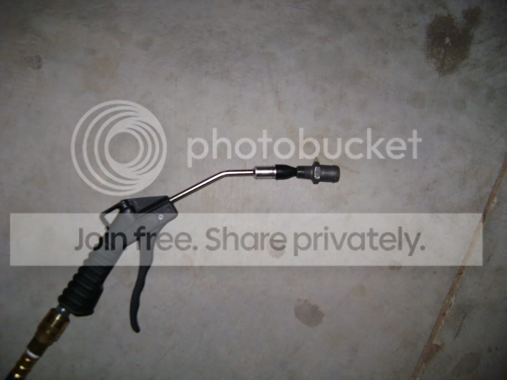

TwinTurbo.NET: Nissan 300ZX forum - Here's a pic of what I did. I turned the pressure regulator
zhundred3x
on November 21, 2010 at 11:29 AM
114
I just got a new set from Nissan
posted by ZXoltan
on November 21, 2010 at 07:50 AM
on my compressor to 20 psi. Blowing air in this direction at this pressure should mimic what the valve sees under boost. My new ones leak even at 5 psi.
ZXoltan
07:50:36 11/21/10
Here's a pic of what I did. I turned the pressure regulator -
zhundred3x
11:29:30 11/21/10
