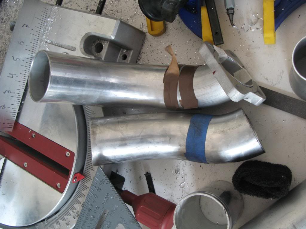

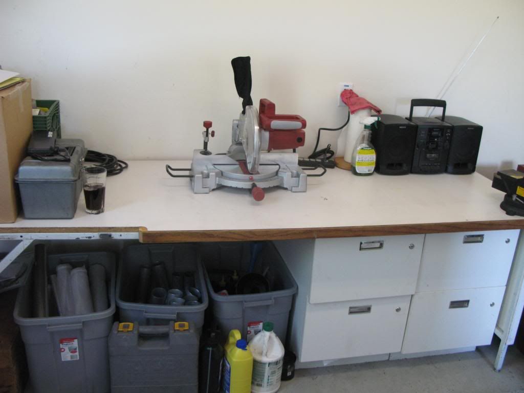

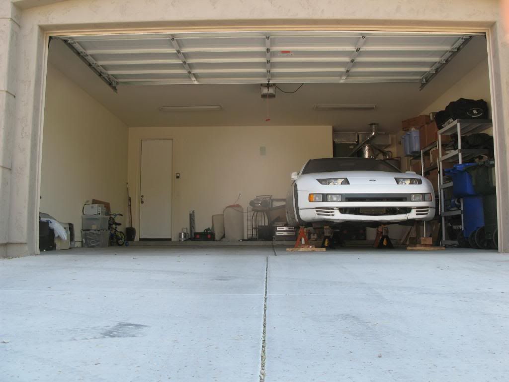

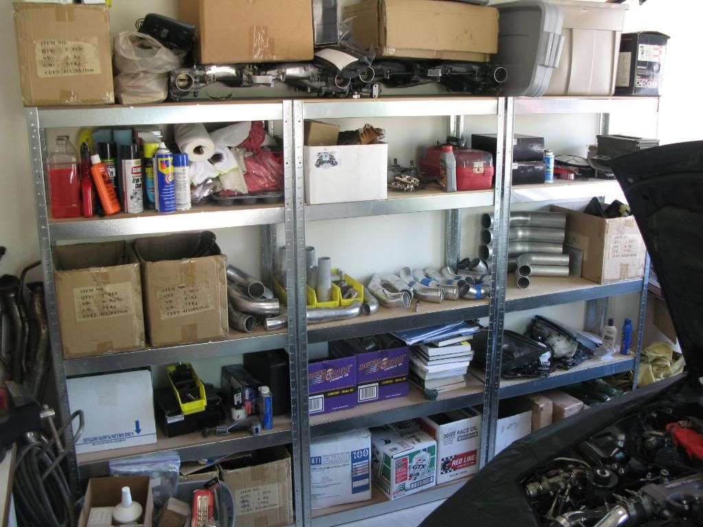

Here are some pictures of my current work station. It’s the single detached garage in my buddy’s home where I live in Arizona. Both his BMW and my 300zxTT park in the attached 2 car garage. When we are both home that is. The single garage barley fits a car inside with all of my shelving holding Z parts, tubing, etc.

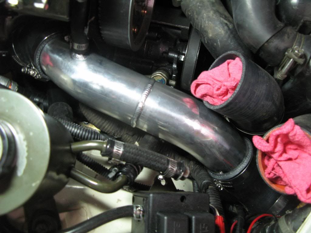

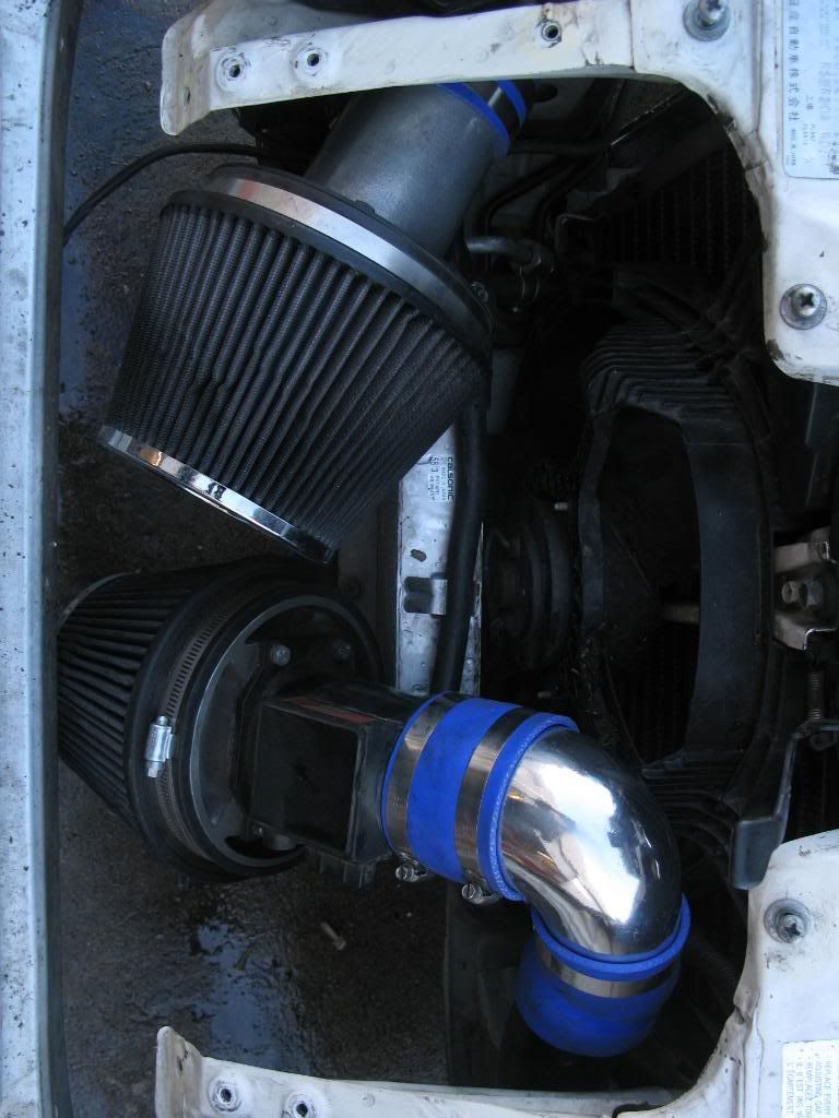

There is so much bending that goes on with the traditional “duel pop” filter setup locations. In addition to the inherit conflicts of direct air flow to the filter/MAF element. Not to mention blocking the air to the oil cooler, AC condenser & the radiator.

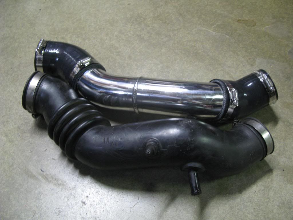

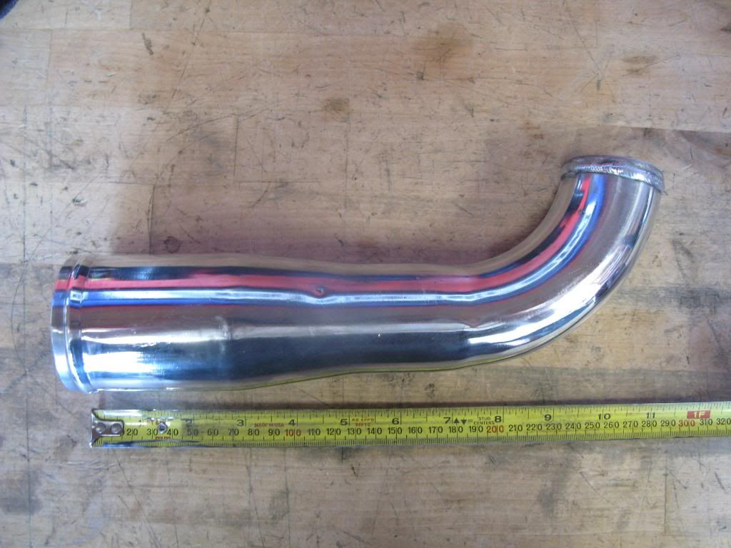

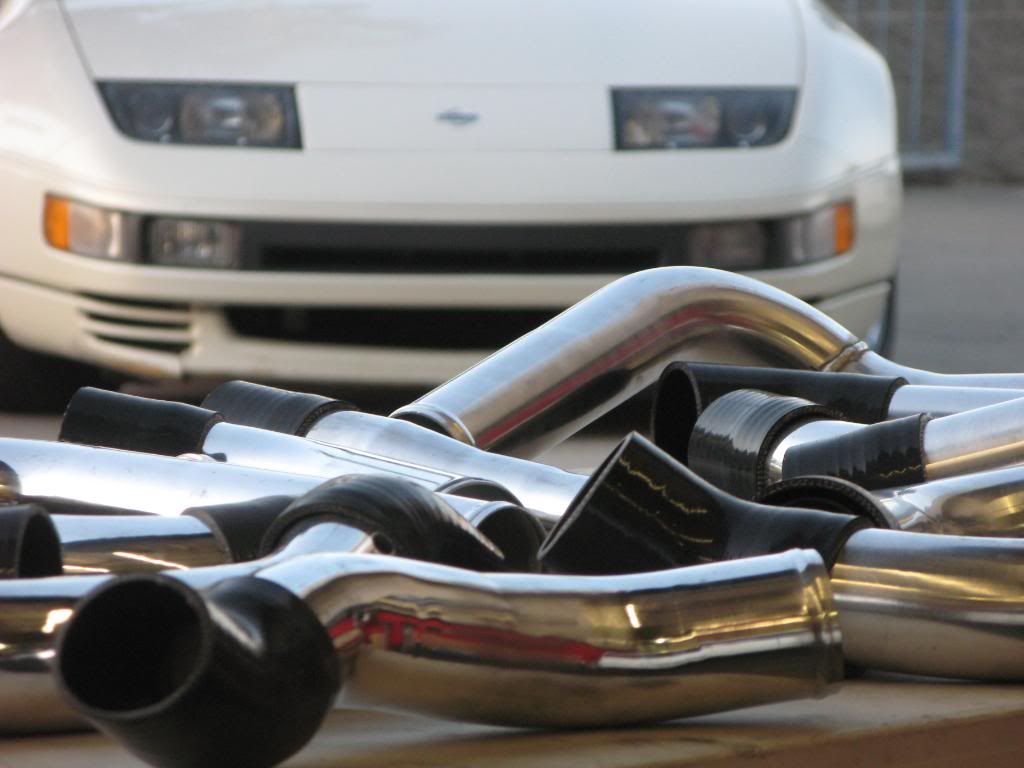

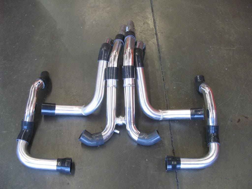

Here are some accordion replacement pipes. They are designed to work with the stock turbo inlet pipes & HICAS intact. These are what is on my “Stock Turbo HP Record Z”

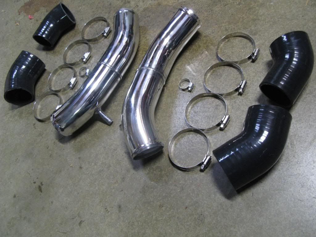

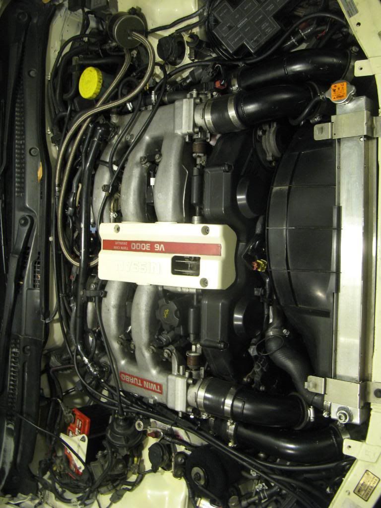

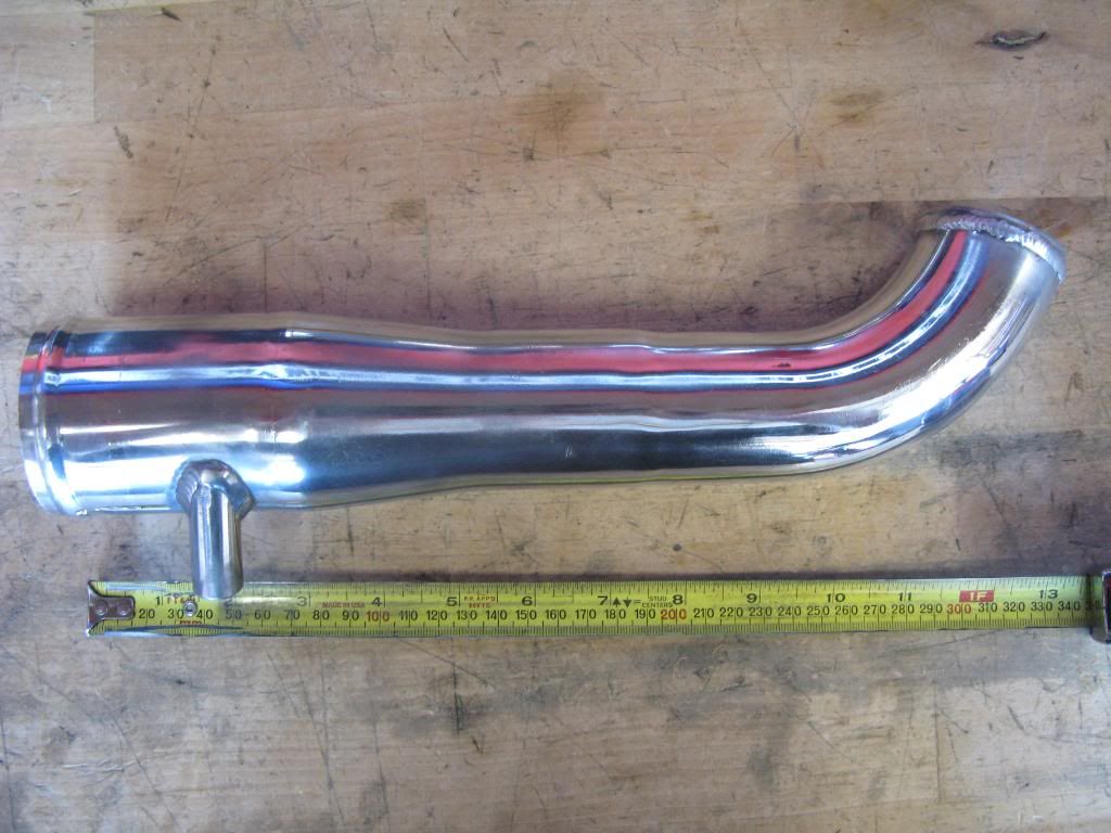

This is a set I was packaging up to ship out to a friend R.F. to go with his stock turbo inlets. I’m working on making him a set of 2.5” Turbo Inlets right now.

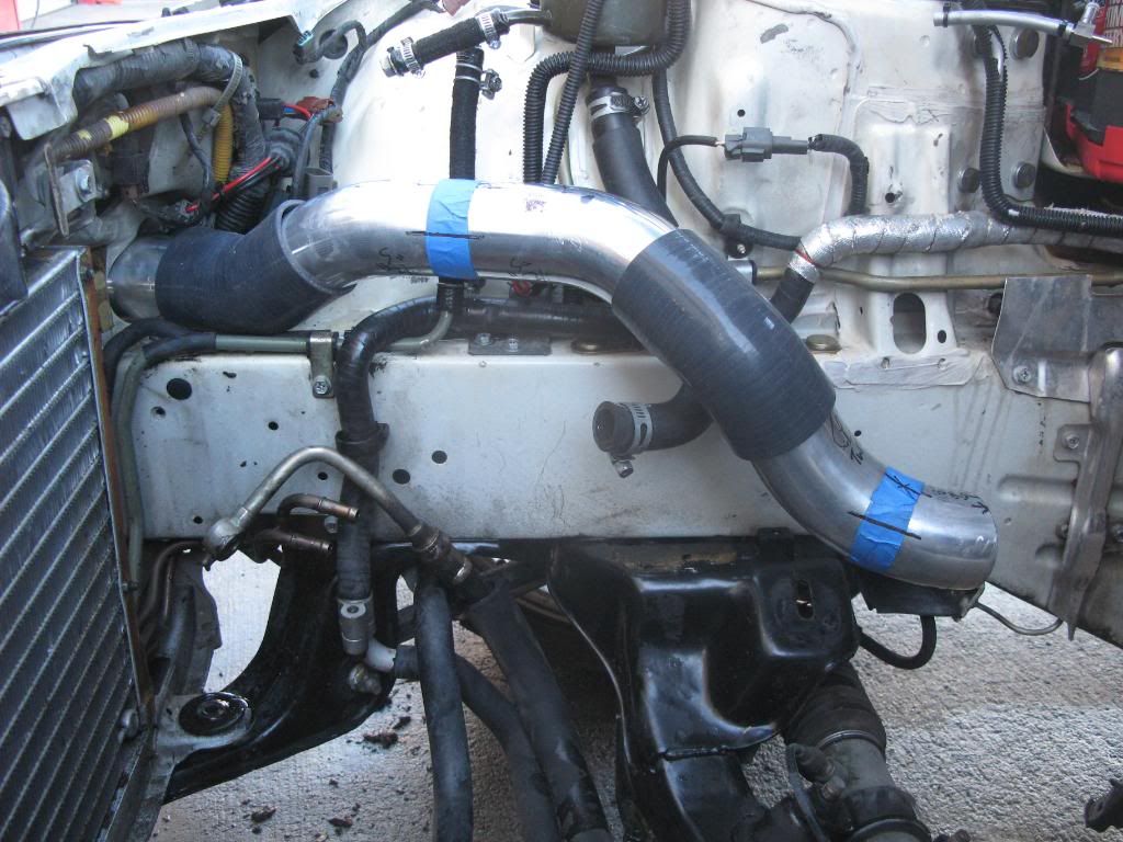

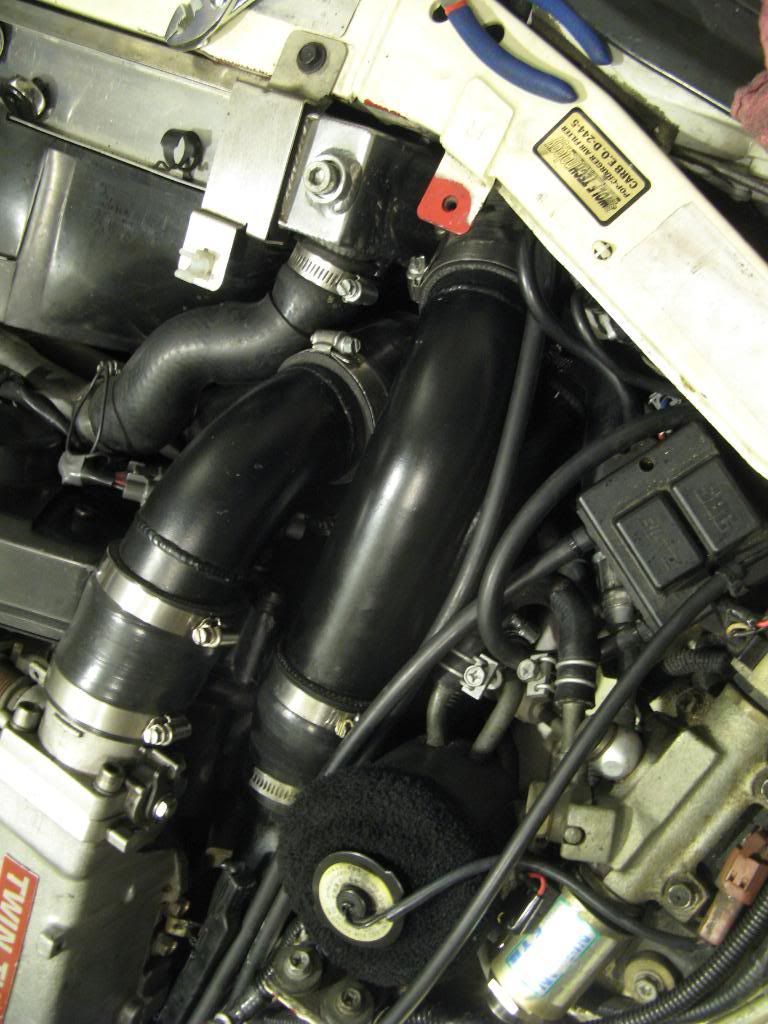

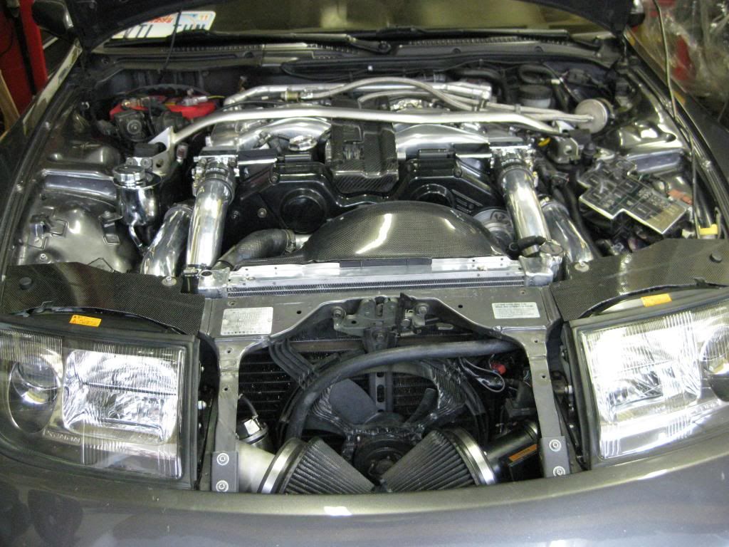

On J.K.’s Straman with T0M’s IC Piping Kit & Ash’s Massive SMICs

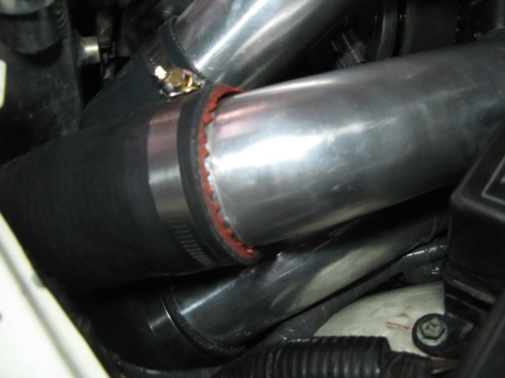

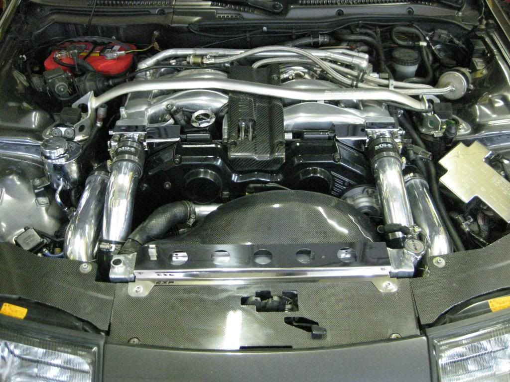

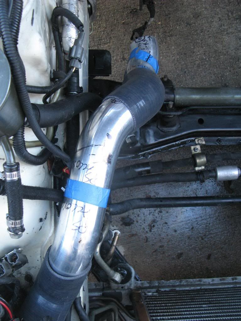

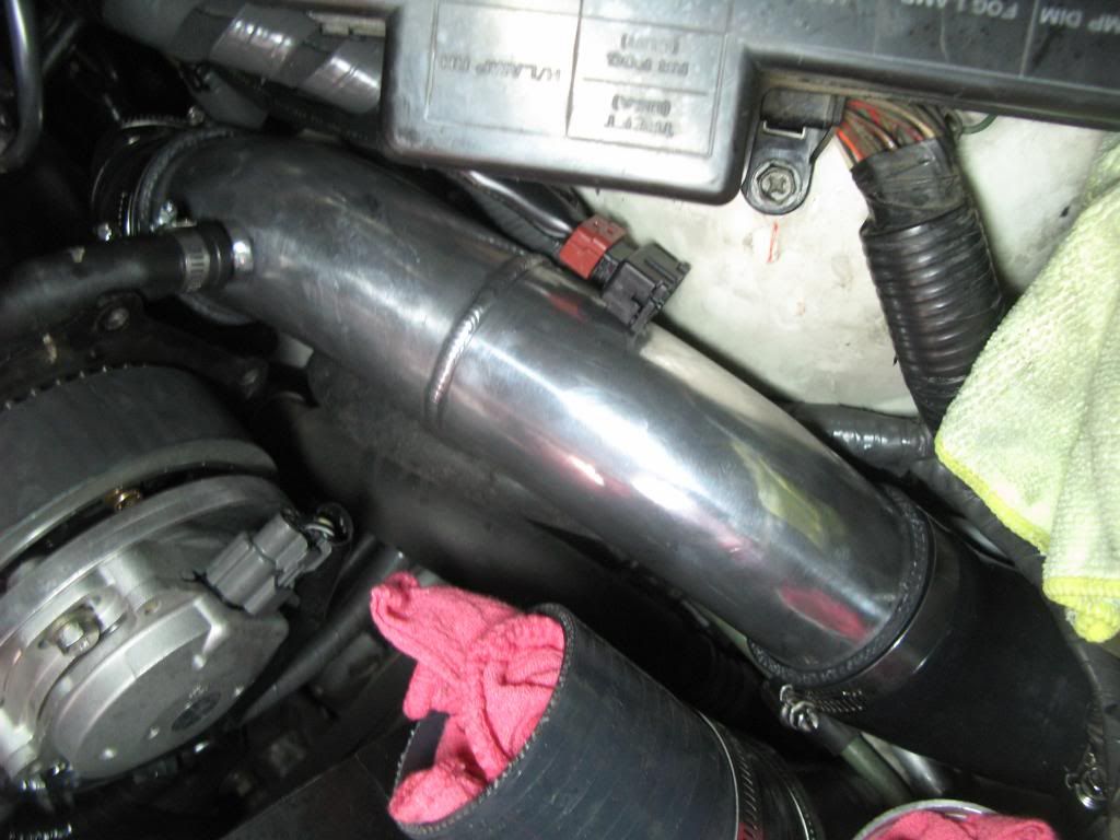

On M.S.’s TT along with a full 2.5” Intercooler Piping Kit (Turbos to Throttle Bodies) & Ash Massive SMICs. I spent about 100 hours porting and polishing these pipes to look as good as they perform. It’s only the 2nd Complete Kit I ever made other than what is on my Z.
I never intended to make an IC piping kit originally out of respect for the companies/people that already had IC Piping kits on the market. One night while looking at how the Z engine bay was laid out I came up with a different piping route that I thought would be more efficient. After a good deal of effort, my piping route would just not fit like I intended. So I scrapped that idea and followed the original piping path, while minimizing all the bends/silicone connections & increasing the bend radius. Nothing special, just simple and direct. I had purchased my ASH Massive SMIC on the original group buy & I was waiting to purchase his mass produced aluminum kit. I made the set on my Z about a year ago next month, before Ash released his current design to the mass market otherwise I probably would have just purchased his kit.
