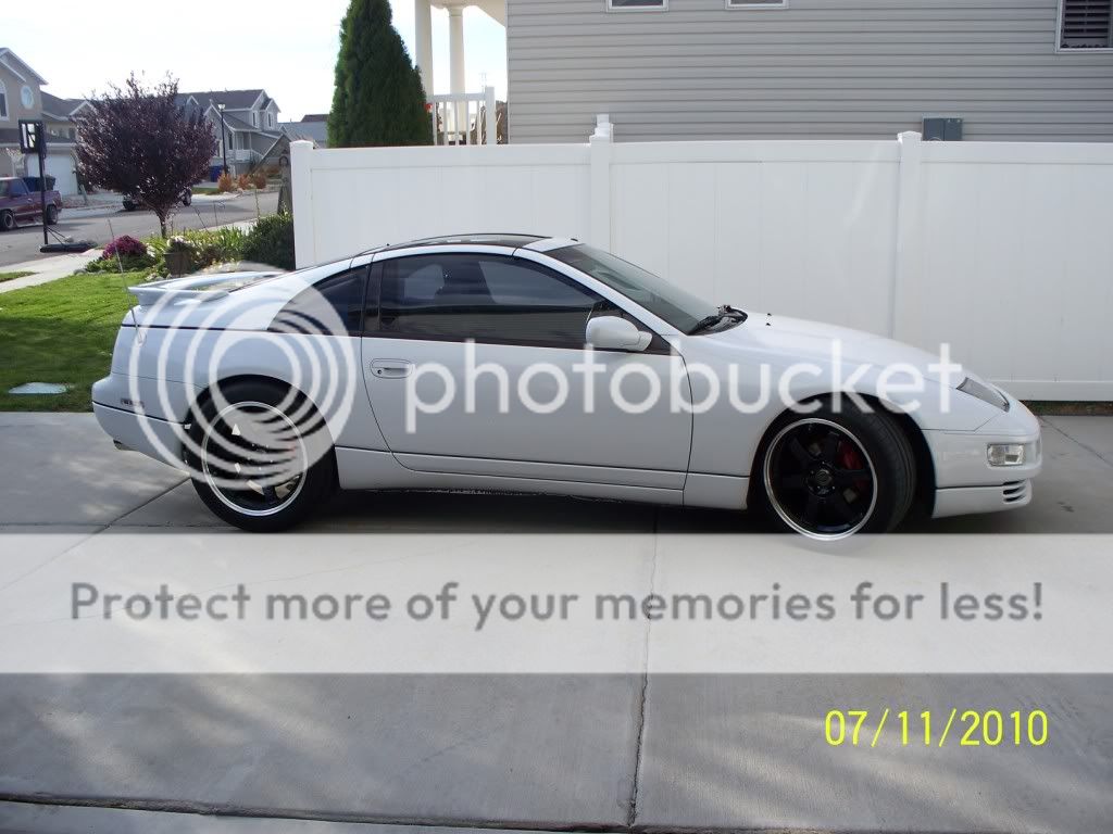

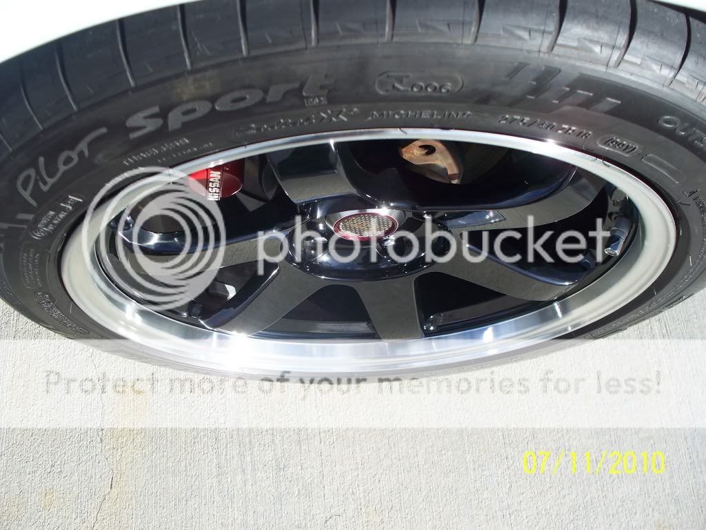

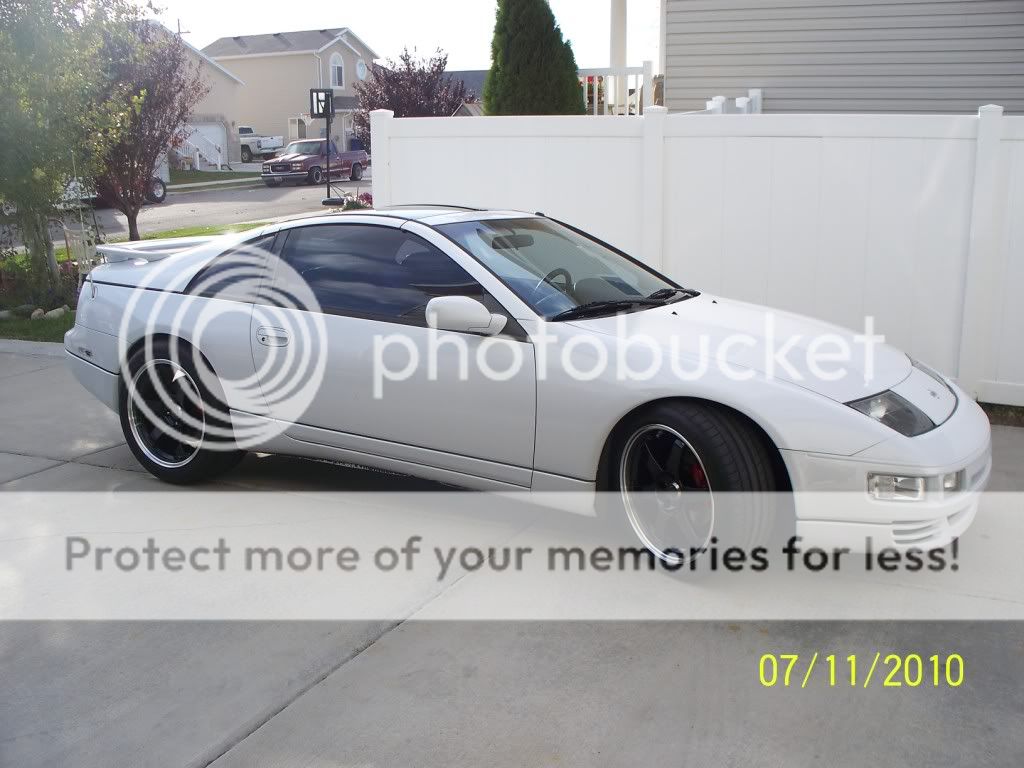

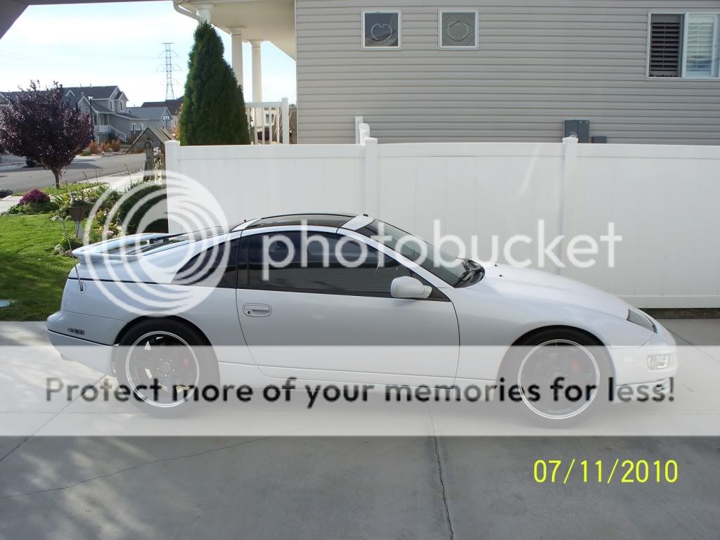

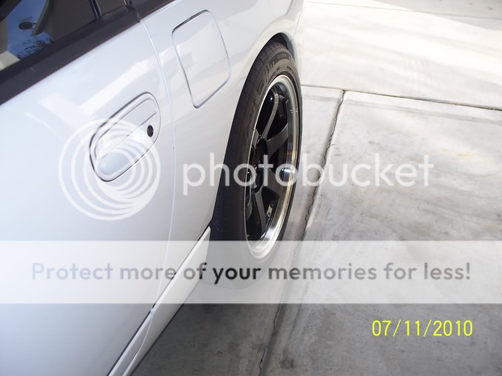

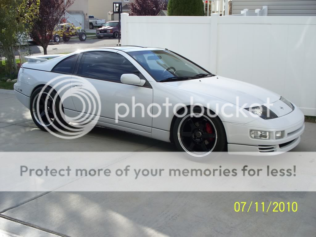

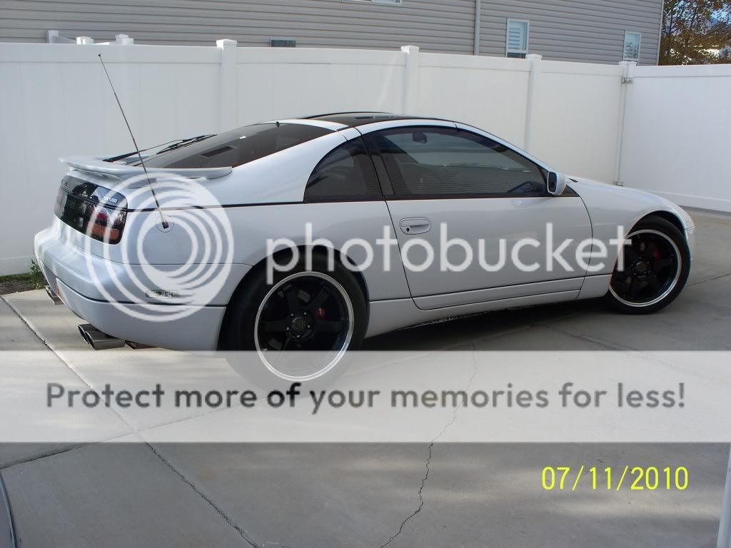

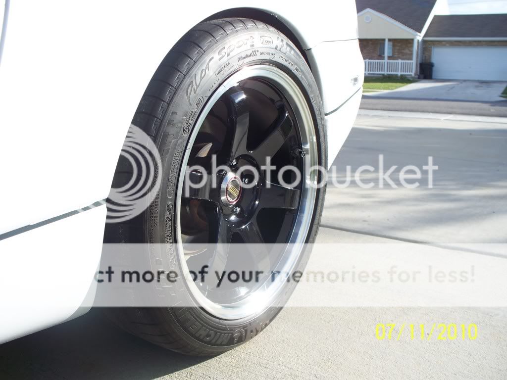

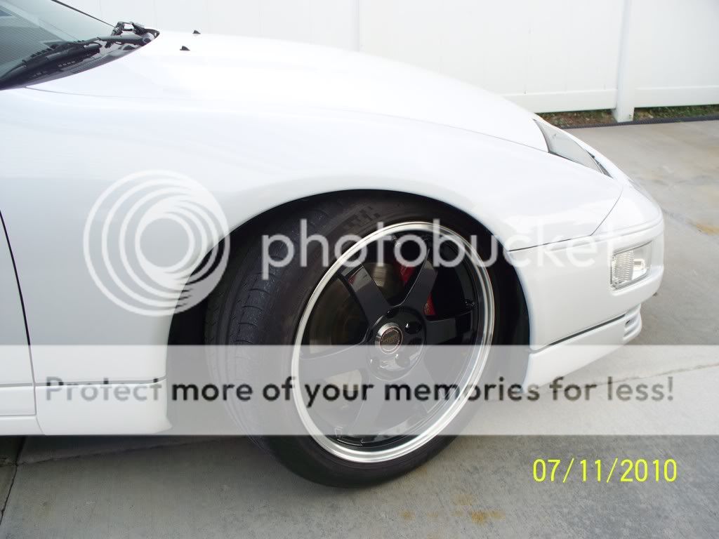

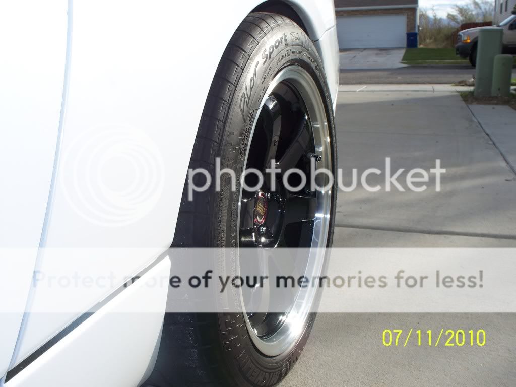

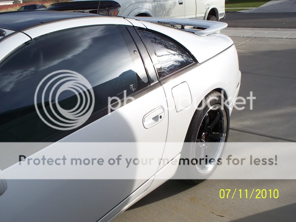

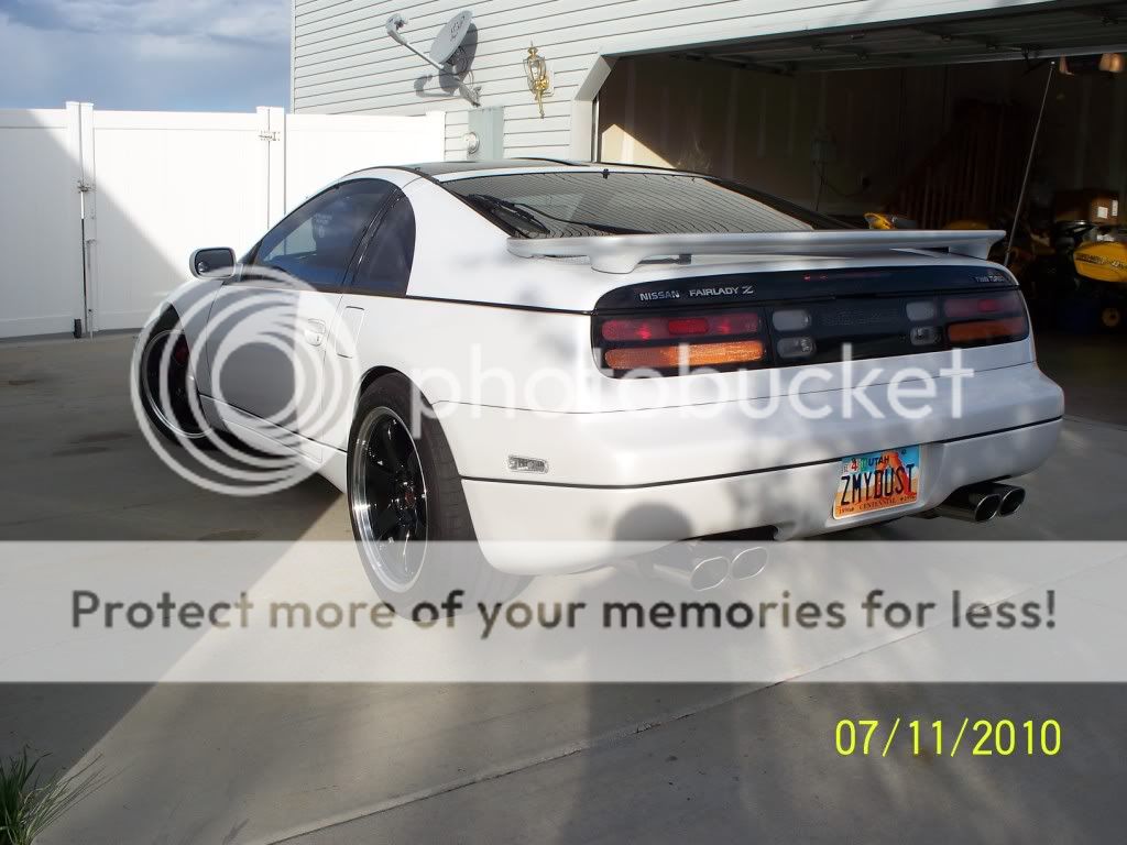

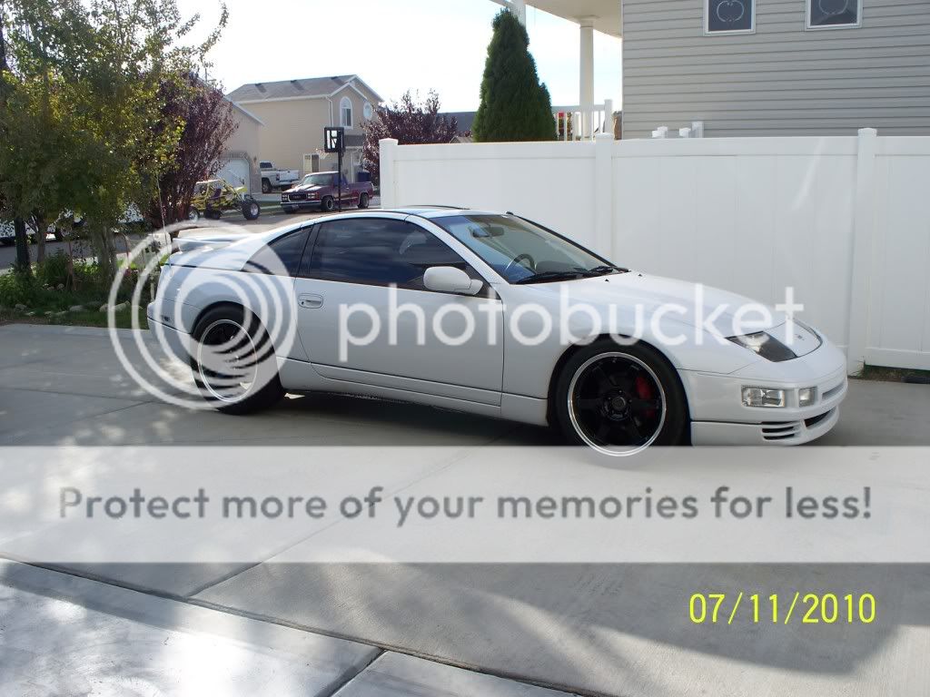

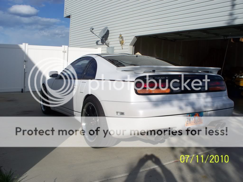

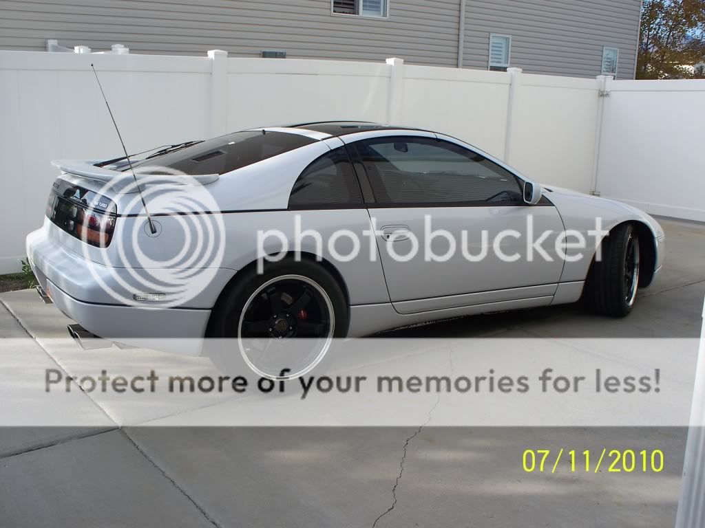

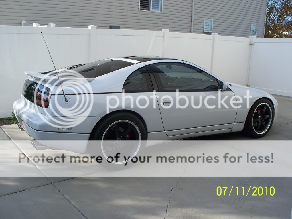

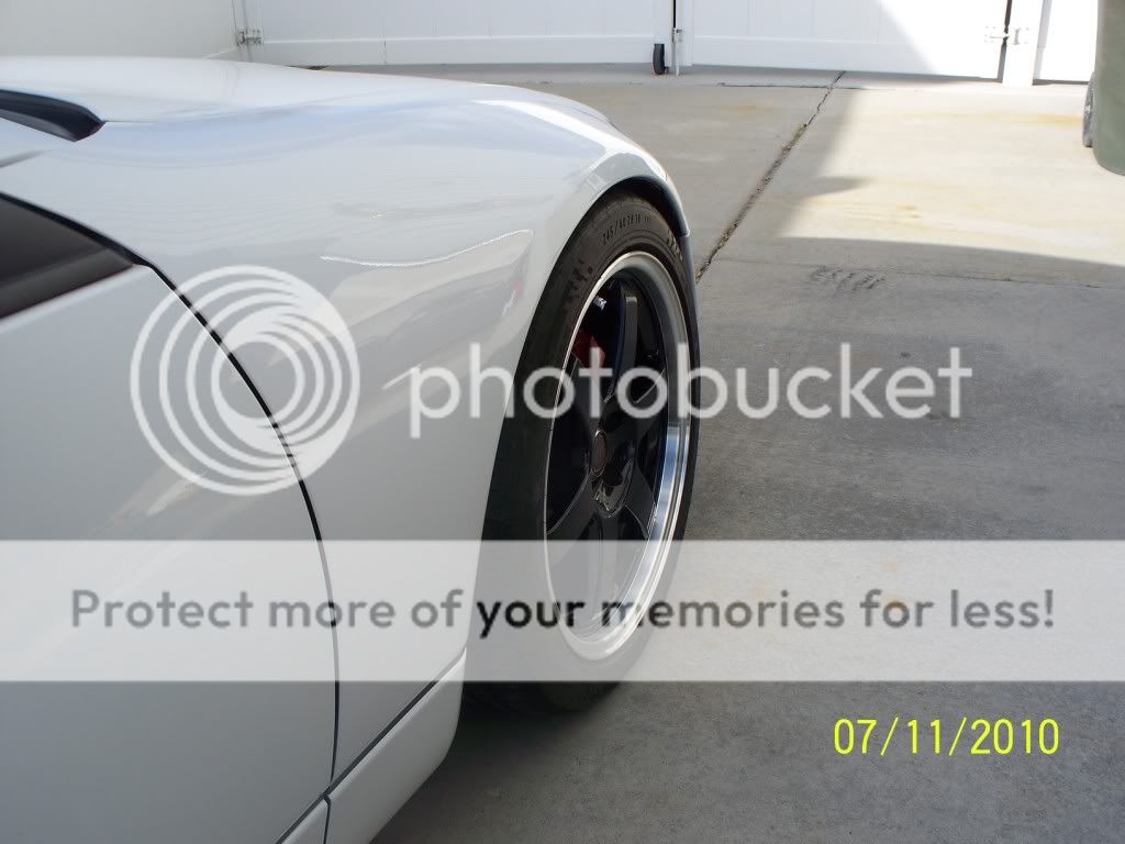

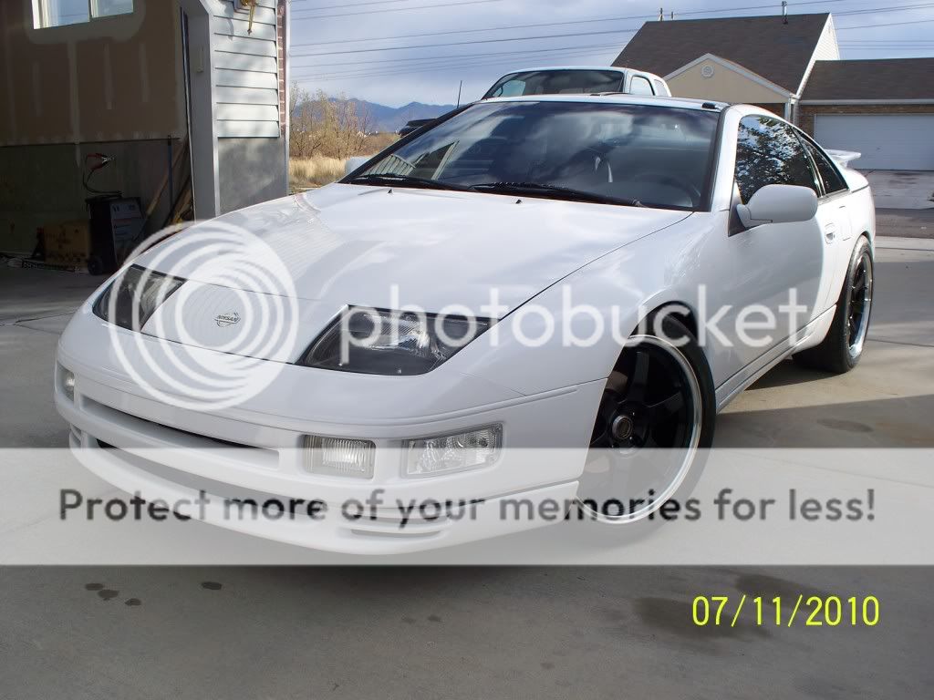

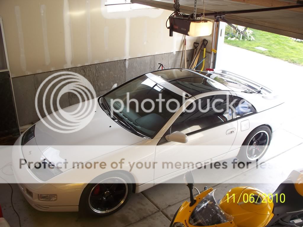

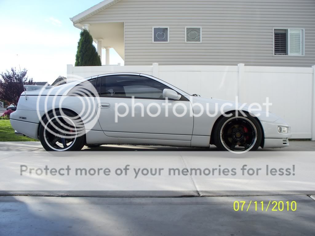

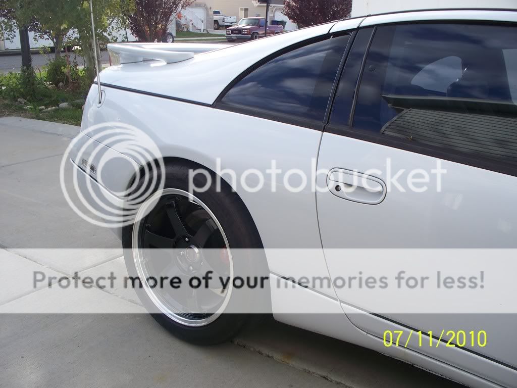

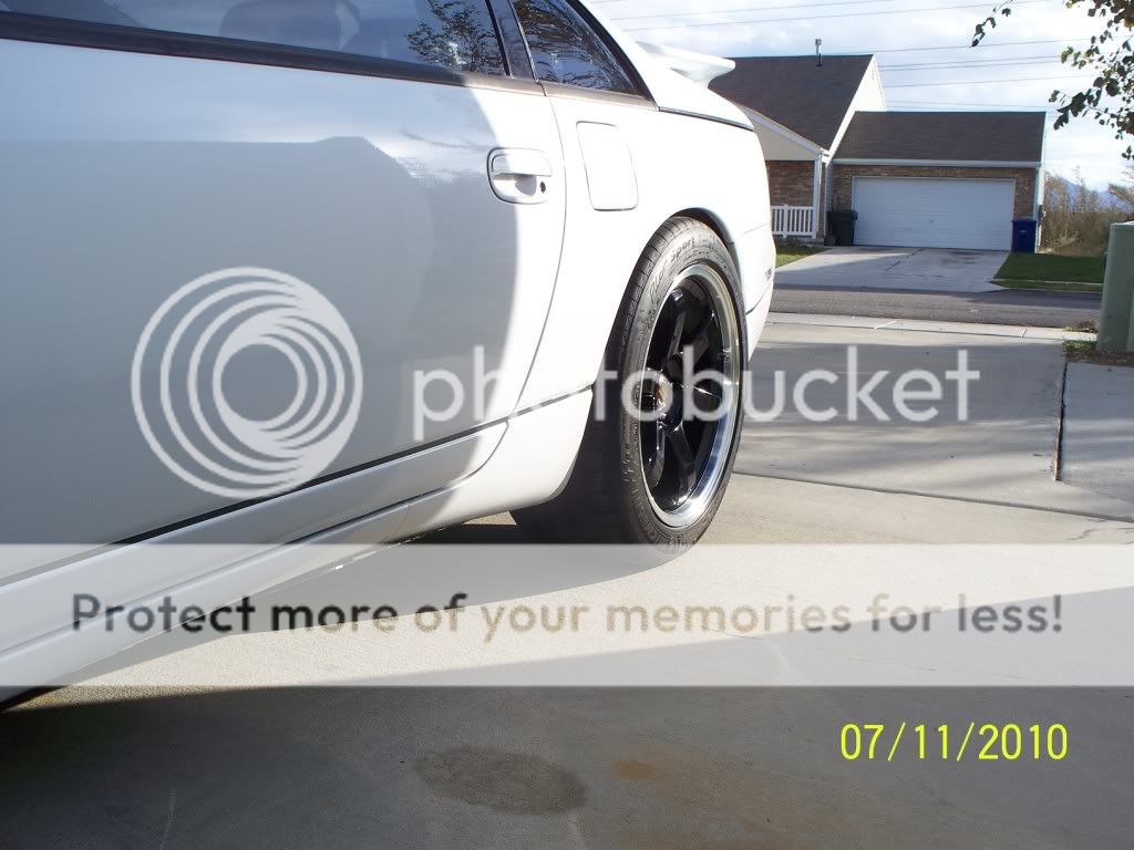

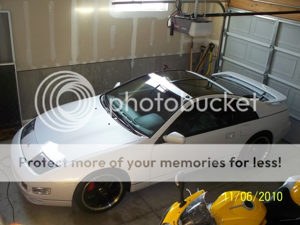

Message I had a hard time deciding on what wheels to get and here's the outcome...
Volk Racing LE37T which is a limited edition TE37. The only difference between the two is the finish. LE37T's came with a polished lip.
18x8.5 offset +22 front
18x9.5 offset +22 rear
245/40 front
275/40 rear
I had to play around with the height and camber somewhat and they seem to fit pretty well. I may still lower the Z a bit and add some more negative camber but it'll do for now..
On with the pictures. Hope to get better pictures soon but here they are:
