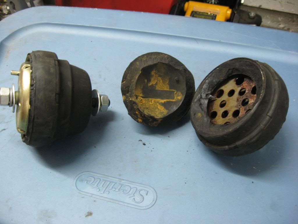

Message Less then a thousand miles. Happened on the second pass at the 1/4 mile track. Passenger side mount tore due to my mighty stocker's.
I suppose they might be fine for a street only Z.

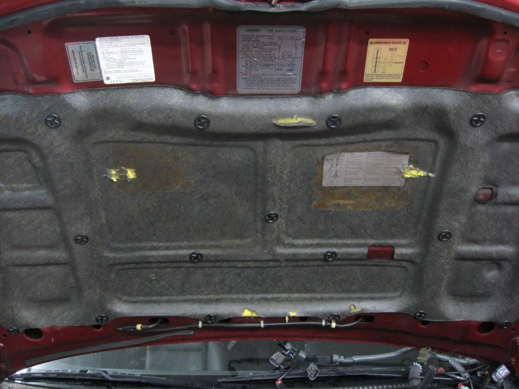

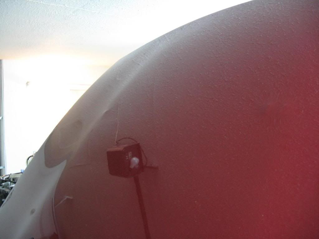

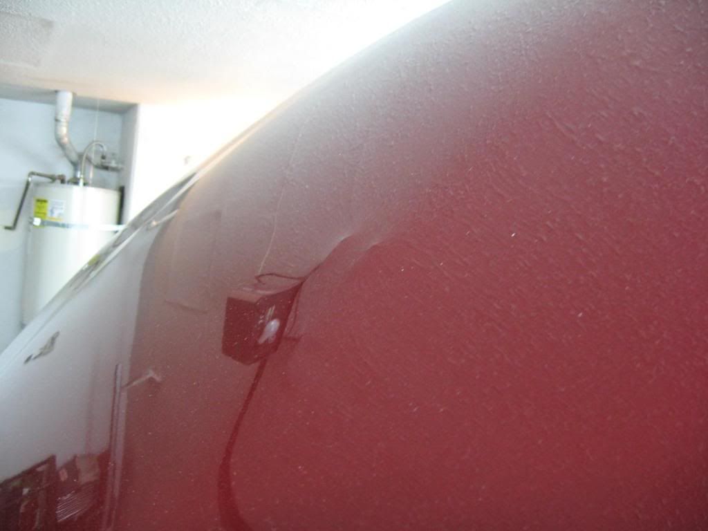

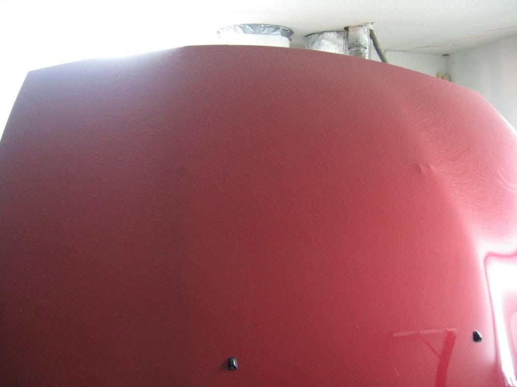

Throttle bodies made contact with hood:
