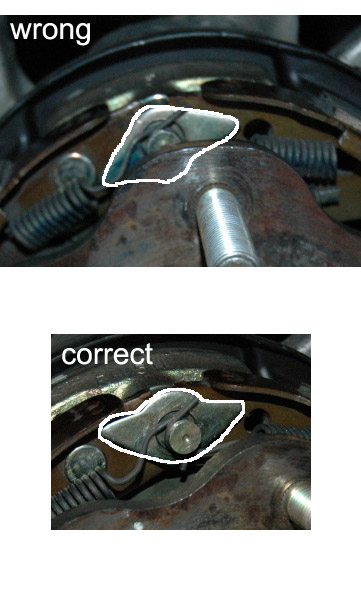

in the upright direction. You've got it right currently, but the "before" photo shows that it was upside down, which may have been why your parking brakes felt like they were not working/adjusting properly.
Fixed my stupid rear upper arm mistake today plus some extra

Don't the correct terminology but they are for the followin

Zwin
20:03:21 11/01/10
isnt it just the middle collar thats upside down? (n/m)
rave
20:12:27 11/01/10
the collars in the second picture look correct
Zwin
20:19:59 11/01/10
Wow...I never have taken them apart either

Probably want to check the rear rotor directions
Dallas DamonZ
22:23:53 11/01/10
Good god you're right
collegeboy
22:44:25 11/01/10

I would definitely go over everything 2 or 3 more times
07:34:17 11/02/10
Believe me, I'll be going over everything 5 or 6 times
collegeboy
09:56:49 11/02/10

Yea it's correct. The FSM caught that one =)
