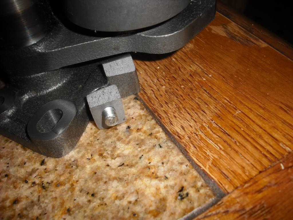

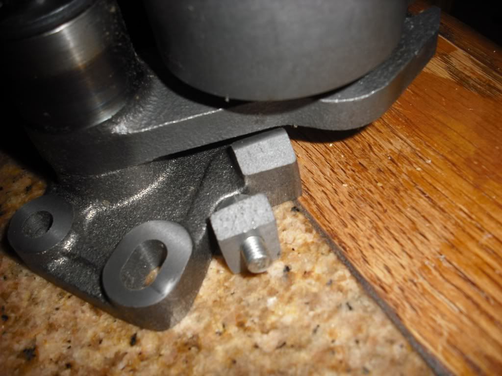

I was installing my new tb and tb tensioner and this happened when I was tightening the tensioner!!!

Yup. tightening it to fast and it snaped.

Why would you tighten it ? It's a set bolt to hold the

2nd Yup, and isnt there a warning sticker on it saying that

Nope... but it warns of stripping the bolt in the fsm! (n/m)

Can I just use the mount from my old tensioner?

yes (n/m)

any tq specs or just do it tight? thx for the relpy btw! (n/m)

12-15 ft-lbs

Turn it slowly. Wait a few seconds between each turn. (n/m)
