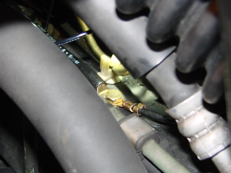

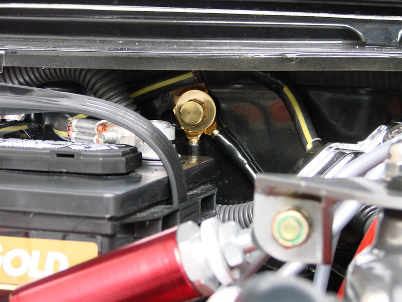

Message Aren't the most efficient amps available. Another reason why I'm not super concerned about the cap is my electrical system:
New battery
New battery harness
New alternator
New alternator harness
New EFI harness
Homemade 8 point grounding harness with 8 AWG wire, gold plated terminals and brass mounting hardware.
On a weaker, less prepped electrical system, a cap may even be necessary, rather than a good to have. But it's still a band aid. One thing I'd like to get is an alternator overdrive pulley, similar to the HI pulley, but for the alternator. Though I'm not sure if the speed would really impact the performance THAT much, as the voltage regulator sets the peak output. Something I'm going to look into.
