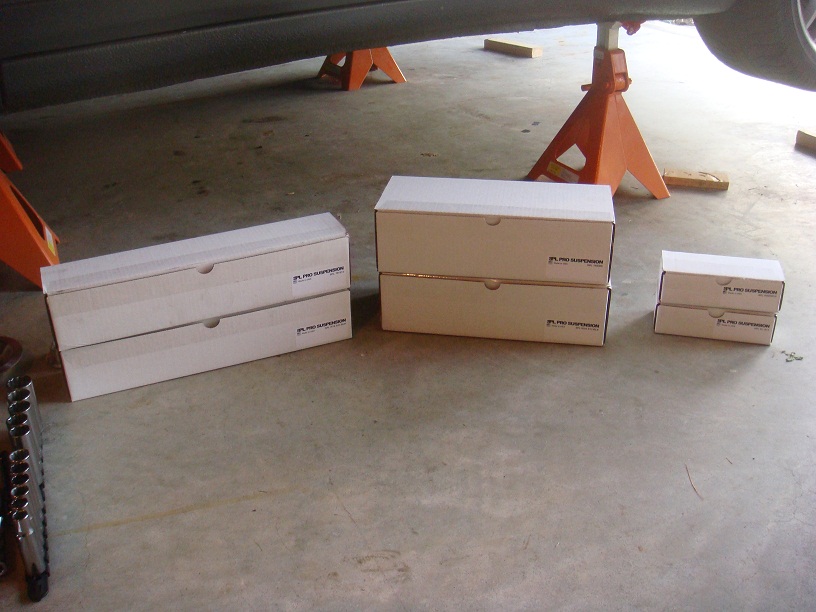

I ended up ordering new front tension rods, brake air deflectors, rear camber arms, rear toe rods, rear traction rods, and Kuah's eccentric bolt lockout kit. It's pretty nice to have so much awesomeness arriving at once.
Kuah was back ordered for a few weeks on the traction rods, but I decided to proceed with the installation and alignment regardless. I wasn't planning to do anything too adventurous with the alignment, so I didn't expect to need that extra degree of adjustment anyway.

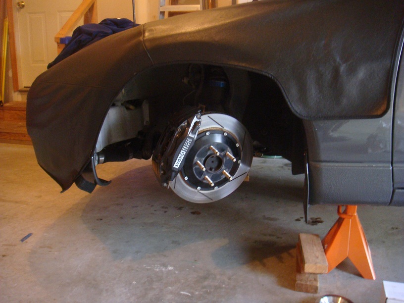

One afternoon after work I put the car up and got started, stripping out the necessary liners.

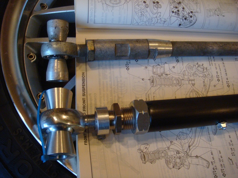

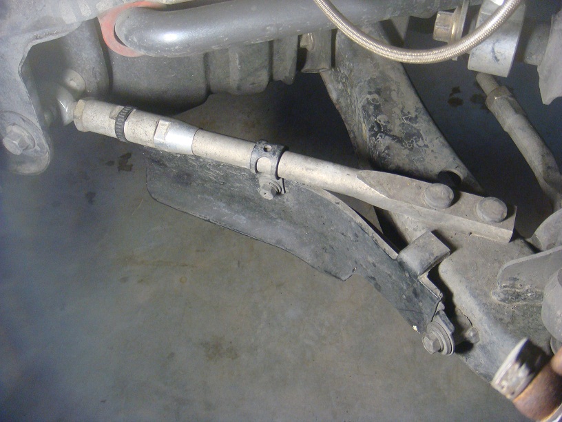

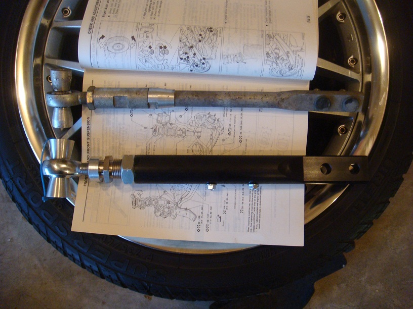

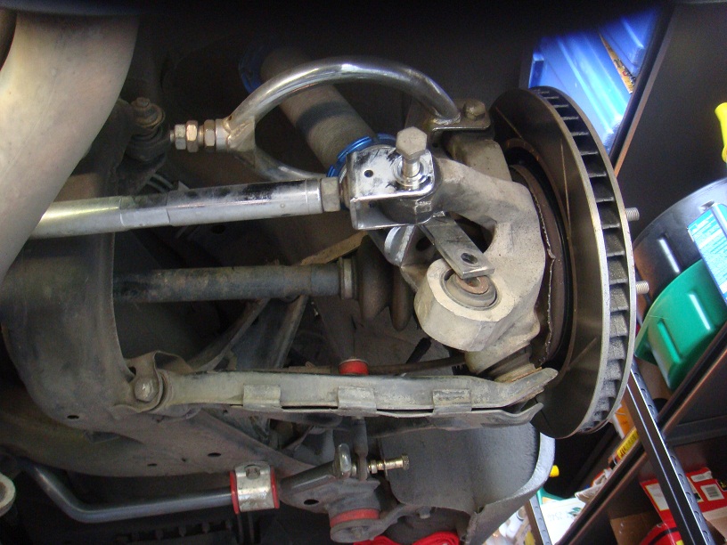

I'd be replacing a set of Stillen adjustable tension rods, installed with the old-style (taller with a bit of scoop) OEM brake air deflectors.

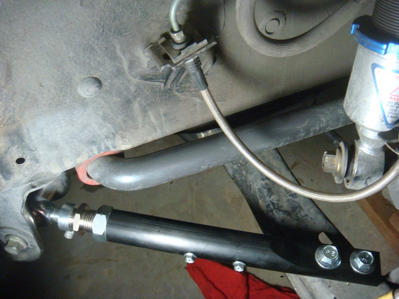

I'd never seen any of SPL's new suspension arms in person until I opened the box of tension rods. These things are beefy.
The hybrid adjuster that Kuah uses in all of these components is quite nice.

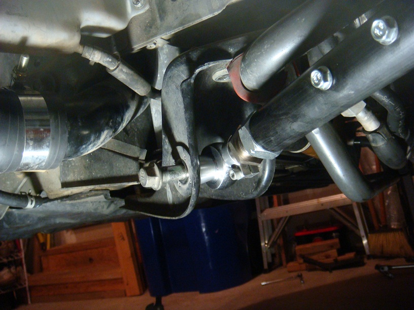

For better or for worse, I dropped the front tension rod brackets so that I'd have clearance to get the front tension rod bolts out - otherwise they'd run right into the adjacent intercooler piping. Unfortunately the threaded holes for the sway bar on the driver's side started to strip out upon reinstall.

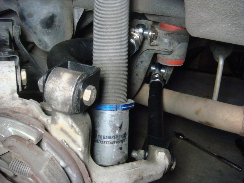

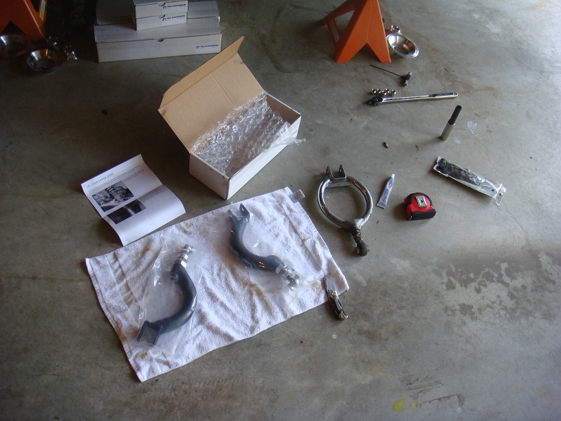

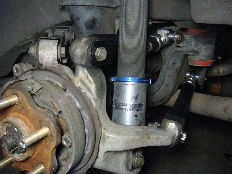

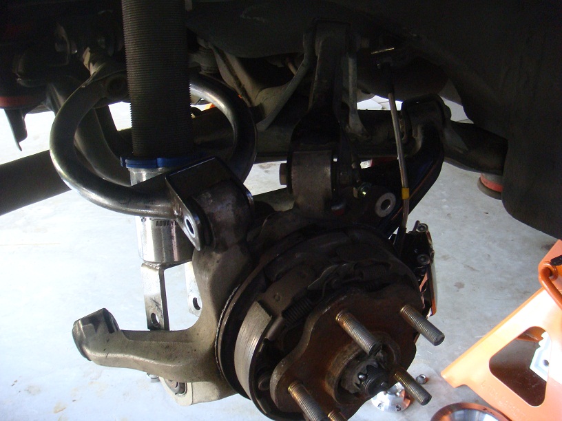

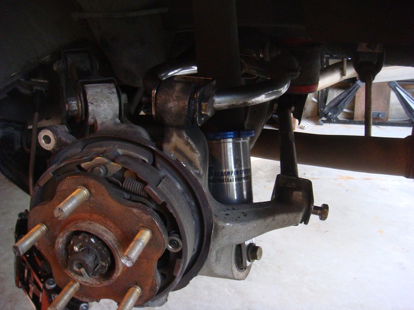

In the rear, I was starting with Powertrix adjustable camber arms and toe rods.

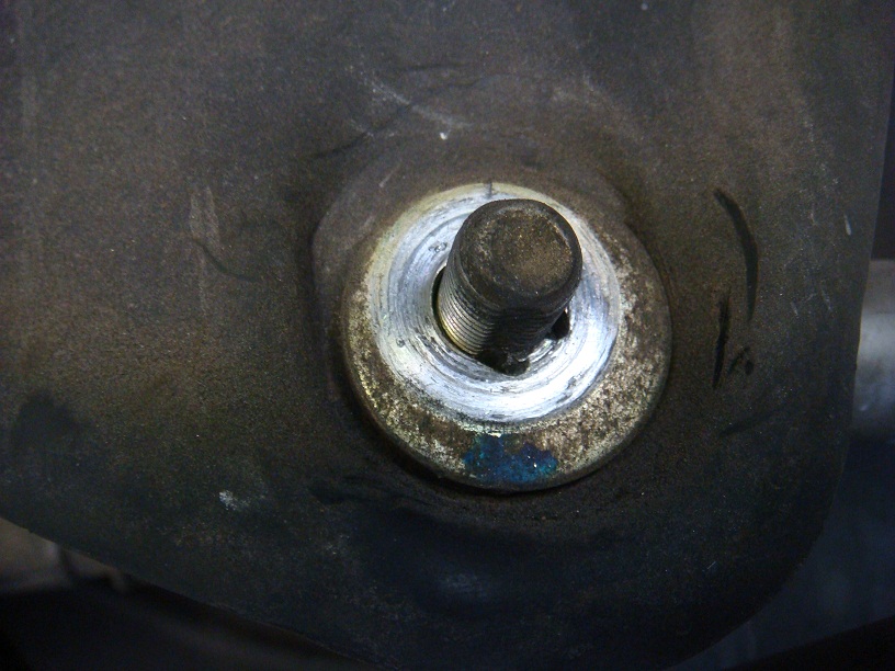

Eccentric bolts are, well, eccentric. They seem to enjoy doing odd things.

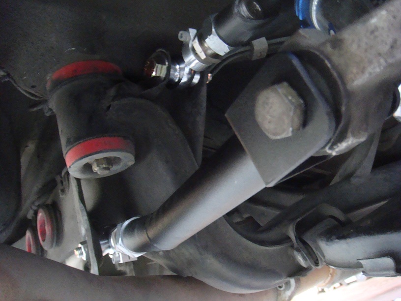

It was much easier to complete the installation with the rear brakes undone.

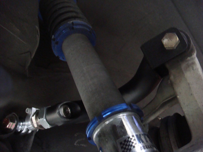

I much prefer the shape of the SPL rear camber arms, since I don't have to slip them over the end of the coilovers to install them.

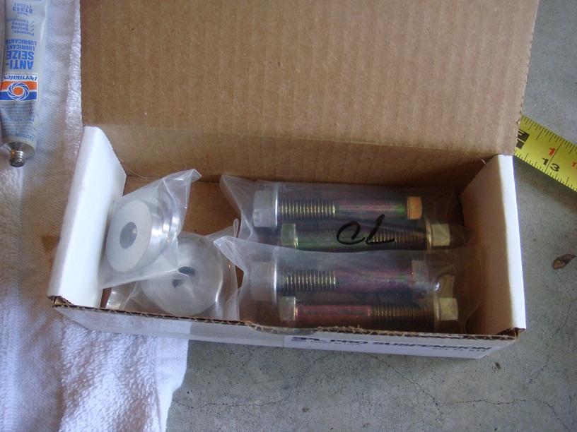

SPL's eccentric bolt lockout kit is simple but great. Using these hardware bits made me feel really good about the whole operation.

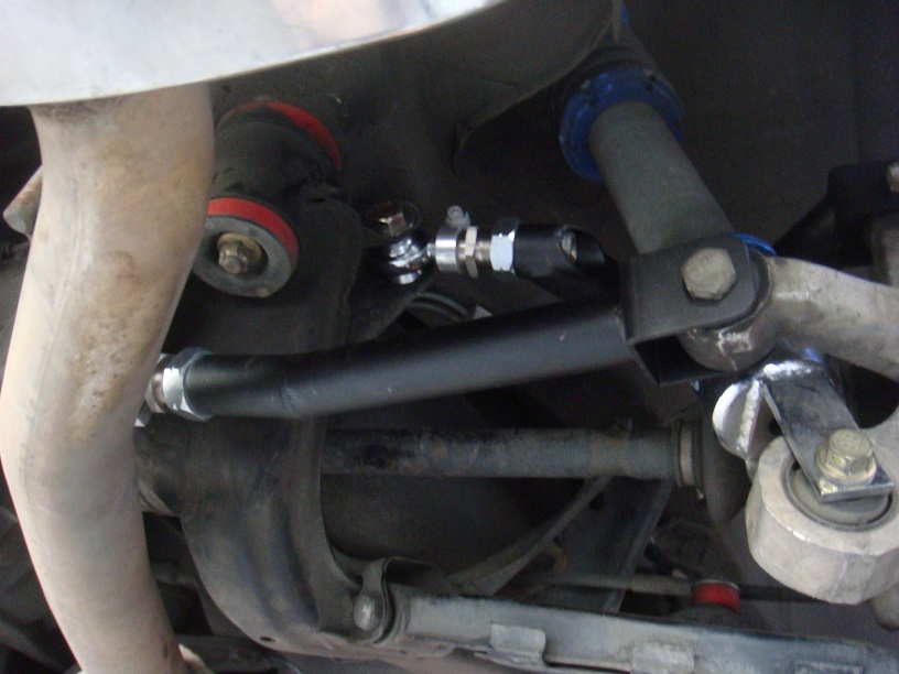

One side, all buttoned up.
Rinse, repeat.

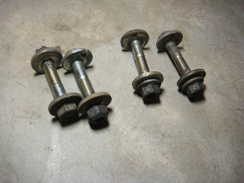

Goodbye, stock eccentric bolts. I never liked you anyway.
