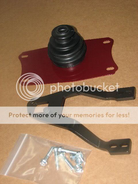

Everything is replaced with this kit from ZSpeedPerformance (Boot plate is optional)This is the version for the stock and modified stock shifters, as previously posted there will also be a version specifically for the Z1 Premium shifter:

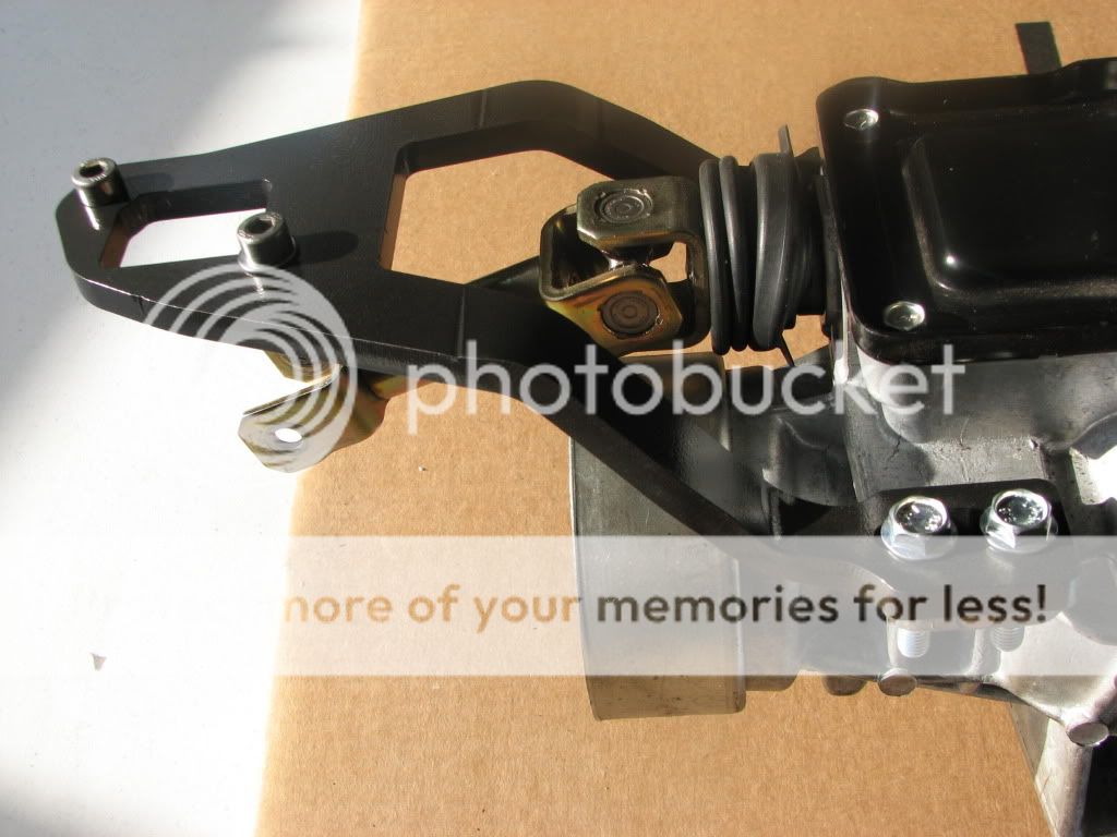

Here’s a visual of the how the bracket attaches to the top of the transmission to better illustrate how the new design of bracket works:

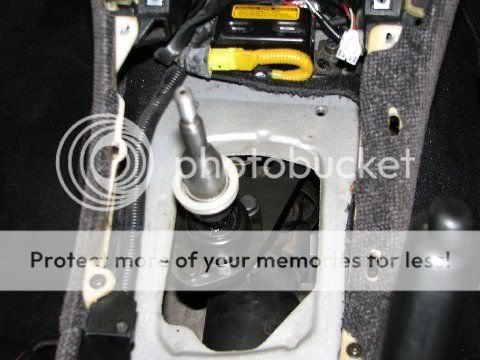

Top view of the shifter in place with the new bracket in place:

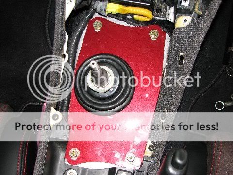

And with the optional boot plate in place:
The stock leather shift boot still fits just like it did with all of the OEM hardware in place. I didn’t think to get any pictures of the final look as it basically looks just like it did with the stock hardware. I did not take a specific measurement but there was ~3/8”+ of clearance to the drive shaft from the bottom of the shifter. For reference, I am still running an OEM 2-piece drive shaft and a Nismo trans mount.
