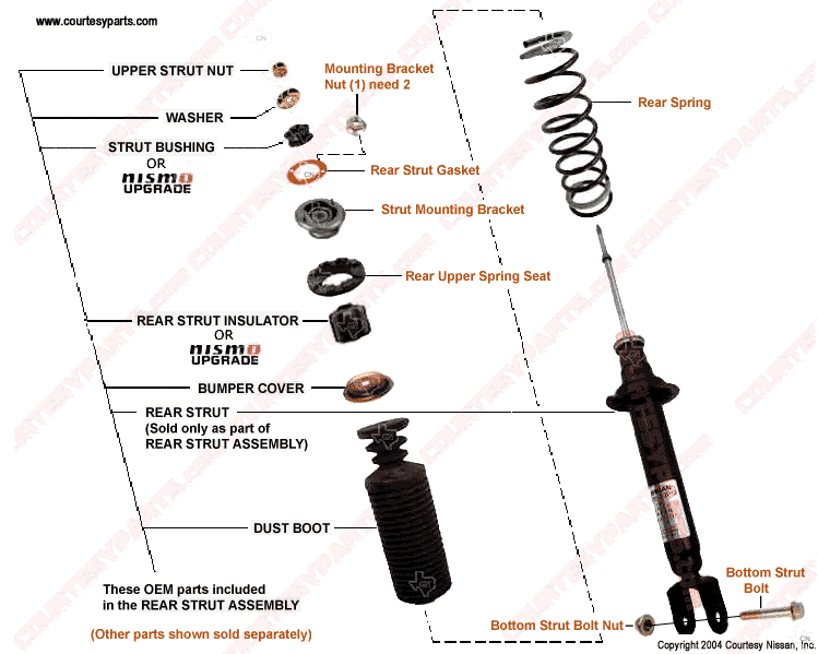

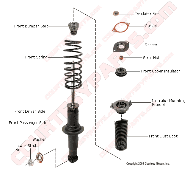

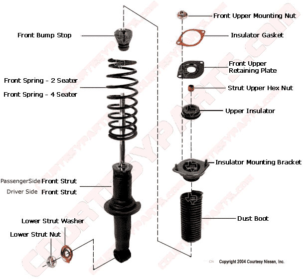

Message The strut assembly is the same for a TT and an NA.
I am copying the images as they are from nissan courtesy parts:
TT front assembly
NA front strut assembly
TT back assembly
NA back assembly
