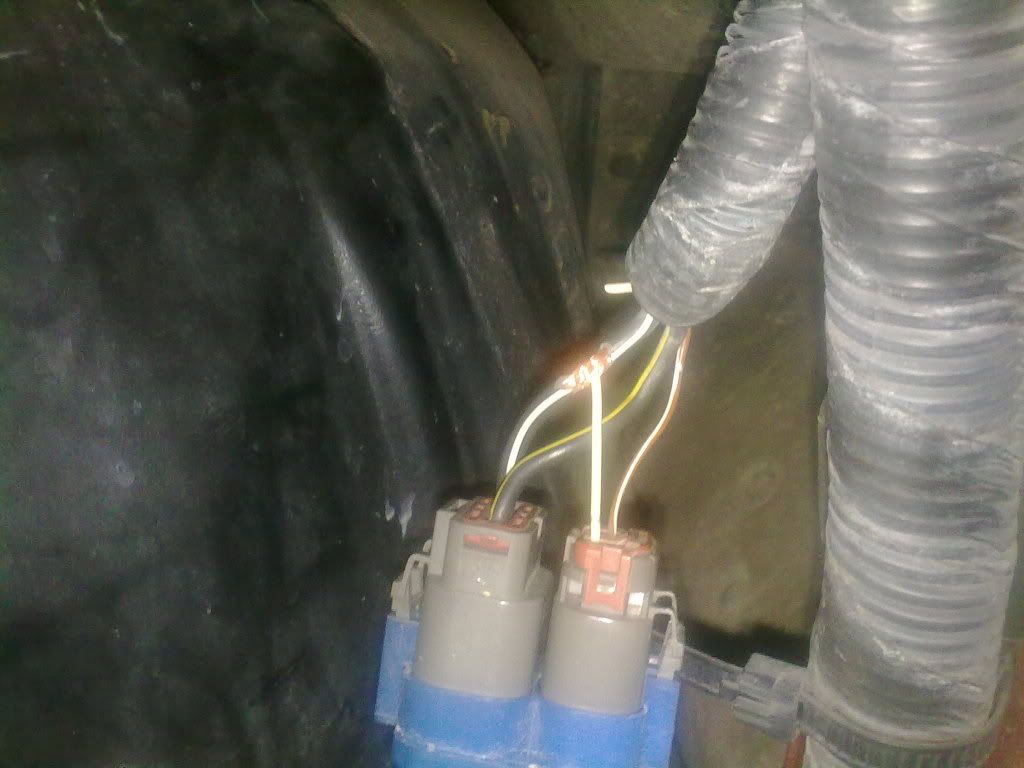

TwinTurbo.NET: Nissan 300ZX forum - here is a picture of the starter
Subject here is a picture of the starter
Posted by cooljestin on September 18, 2010 at 3:52 PM
  This message has been viewed 218 times.
In Reply To 5 Speed Swap Wiring info posted by jmw23712 on September 18, 2010 at 02:59 PM
Message relay wiring to get the car started with no clutch switch, no cruise kill, switch no neutral safety switch.
all you have to do is connect the white wire to the black/white wire at the starter relay as in the picture.
