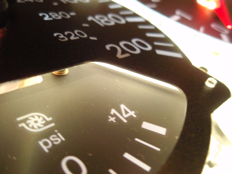

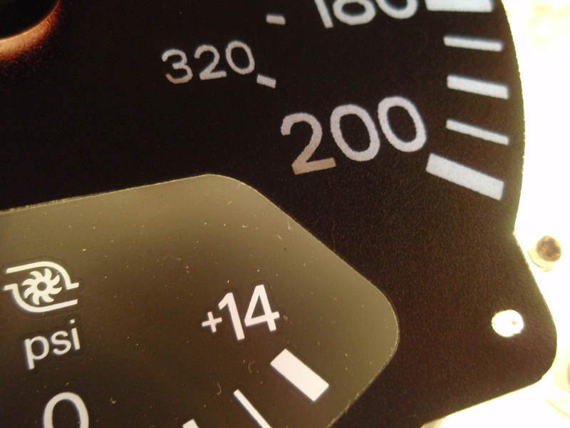

Message easily be corrected. The only thing needed is to cut a little off of the right side of the boost gauge face. Nothing else is blocking the light. Doing this won't be noticed as there is still enough boost gauge face to extend behind the speedo gauge face. Here are a couple pictures to see what I mean. I'll make this change to my own cluster before I install it and then post some new pictures of everything.
