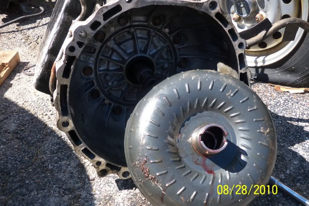

Message The bellhousing here is definitely an NA bellhousing. It could be that it's bolted onto a TT transmission because the bellhousings will interchange. Is this the JDM transmission?
Below is a TT bellhousing because the flange surface doesn't have all the windows in it.
I guess the NA and TT torque converter bolt patterns are different as well as their diameters.
